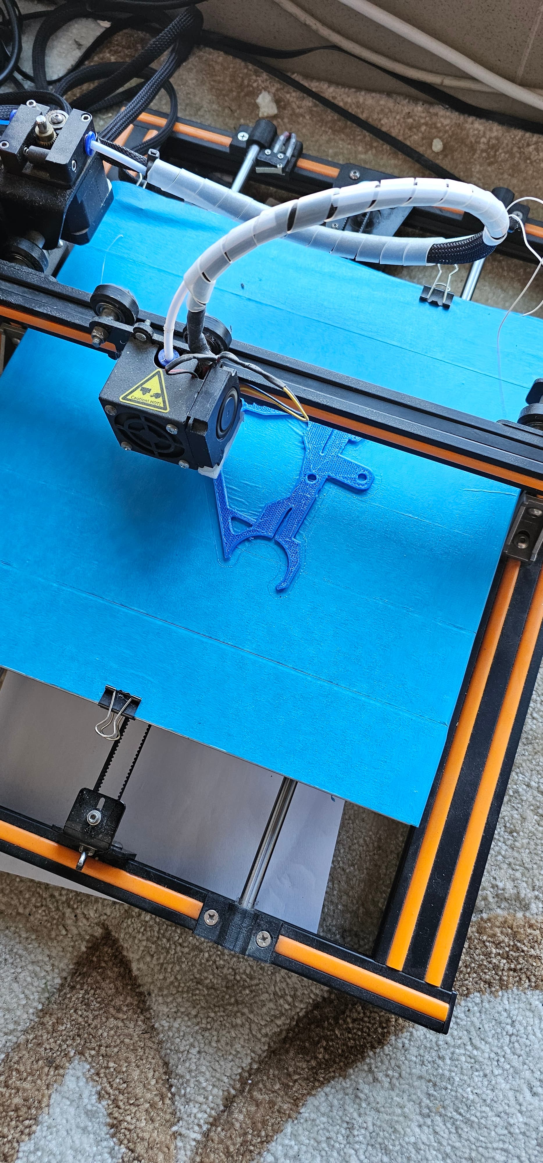

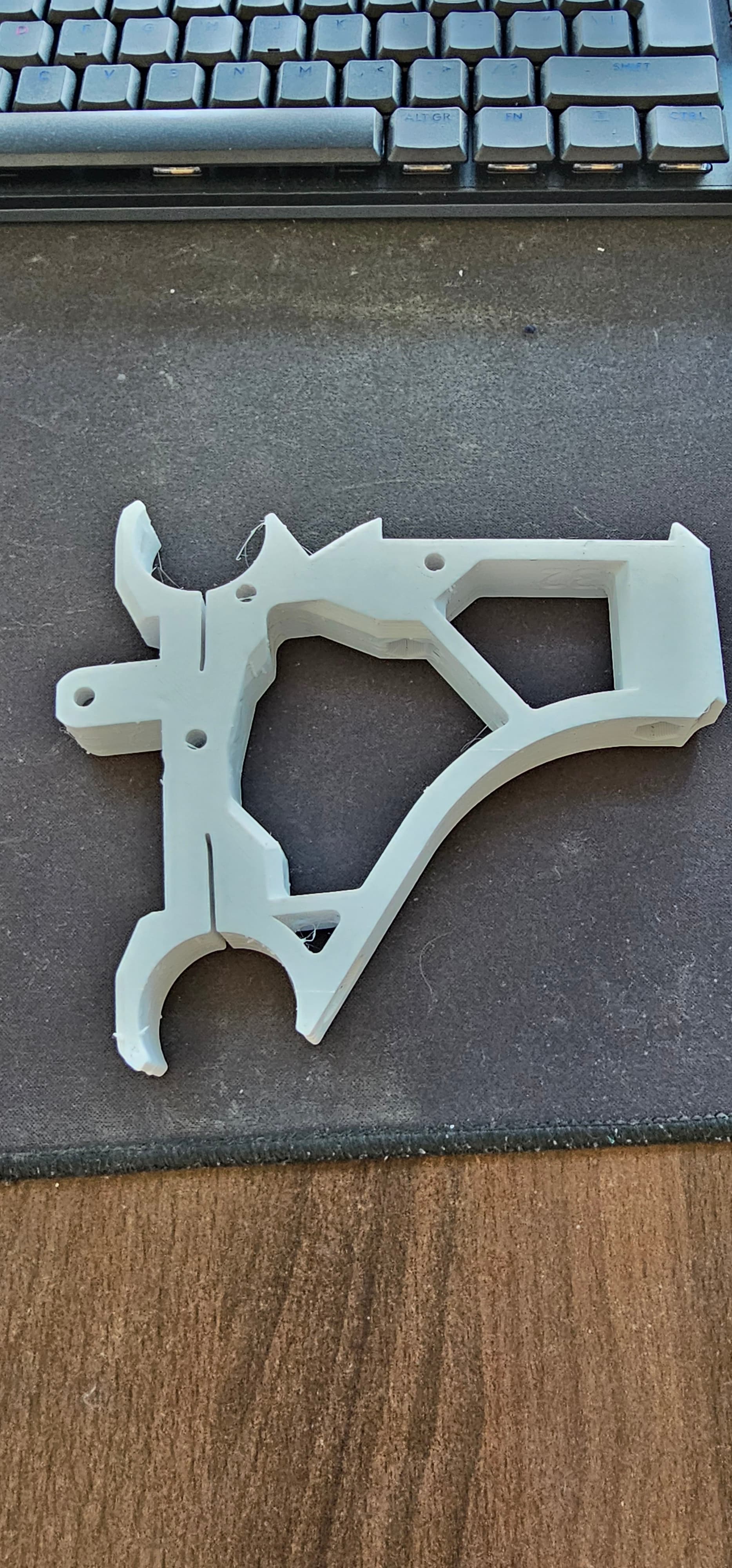

Started to 3dprint. I printed in PLA but doesnt feel too safe. Now i ordered PETG and started to print again. Wish you all luck!
PLA is preferable to PETG. PLA is more rigid. Rigidity is the key material property for the braces.\
Ordinary PLA. Not PLA+, not PLA HS, Not Silk PLA… etc. Simple, cheap, ordinary, rigid PLA.
I tend to use PETG because of the higher temperature tolerance and 60% infill on all the parts give me a peace of mind that is more resistant on all the fronts.
PETG is a worse chose because it is more flexible. PLA is the recommended material. More infill will not make it as good as PLA - especially the core which is already a high infill %.
It’s your machine so you can do whatever you want but be prepared for potentially being disappointed with your machines performance.
