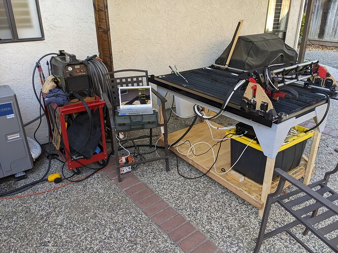

On mine I used the touch feature for initial Z height setting, and the plasma is hooked up to the mesa for flame control, Z height, and on and off.
I learned everything from, https://forum.linuxcnc.org, with the help of kyle’s initial post.
As Ryan said V1E steppers are fine (I used them on mine I think).

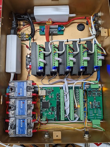

One thing I did not see in your list is drivers. The Jackpot board has drivers built into it. The Mesa Electronics board does not. If you look at my build log, it has my wiring diagram from where I made mine — with driver details— and also if you look at Ryan’s photograph above you will see those drivers. In my case and I think in his also they are big black rectangle box looking things. TB… something or other. I gave details in my build log.
