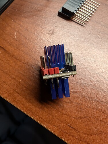

However, I was limited by my TMC2209 drivers on the Jackpot controller. To ensure the NEMA 23 would perform at its peak without overheating the drivers, I came up with a cooling solution by attaching heatsinks to both the top and bottom of the driver, doubling the heat dissipation capacity. I extended the driver legs to fit the modified setup, and after extensive testing, I was able to deliver a steady 1.77 amps to the motor without any overheating.

I wonder what fraction of the gains you would get with just one Y linear rail. That wouldn’t have the alignment issue.
I wonder if there is a replacement trinamic driver for the amperage upgrade that wouldn’t require so much custom work. Your workaround seems pretty easy to do and clever. I know there is an expansion board for using external drivers. It would be nice if there was just a plug and play driver solution though.

Good questions! I actually thought about using just one Y linear rail, but after considering the load distribution, I went for two to make sure the entire Y-axis was rock solid. I suspect you’d still get a decent improvement with just one rail, especially in terms of reducing the jumping or flexing, but you’d likely see a slight compromise in overall stability, particularly during higher-speed cuts or when cutting harder materials. The dual rails have definitely helped me maintain precision across the entire travel distance, but I’d be curious to see if anyone has experimented with a single rail and how much difference it makes.
As for the Trinamic driver upgrade, I totally agree—having a plug-and-play driver solution for higher amperage would be ideal. Unfortunately, I didn’t find any TMC2209-compatible drivers that could handle the current I needed without serious modifications. That’s why I went with my custom cooling setup to push the existing drivers to their limit. The expansion board option with external drivers is definitely interesting and would allow for higher-power motors more easily, but it adds extra complexity and cost. It would be great if a high-amperage Trinamic plug-in solution existed for setups like this—it would certainly make the process more seamless.

On the discord for my new 3D printer it looks like many of the folks have been switching the 2209s out for BTT 5160 Pros to switch their system to 48V motion systems (not I change I see a particular need for at this point.) Looks like they can handle 3A max, because that’s all that can be put through the row of 2.54 pins available for power. They’re running a BTT board, so perhaps it’s a software support thing, but when I read the stuff you’re doing to make the drivers work, I did think of those.
Again - apologies if this is a ridiculous idea.
I had the same idea initially, but after looking at the schematics of the Jackpot controller (which I’ve already purchased), it seems the motor driver module sockets are set up for UART communication, which is used for TMC2209 drivers. The SBI pins needed for SPI mode for the TMC5160 appear to be configured for the TMC2209. To use TMC5160 in SPI mode, it would require rewiring or modifying the board to connect the SPI lines (MOSI, MISO, SCK, and CS) to the appropriate pins.
