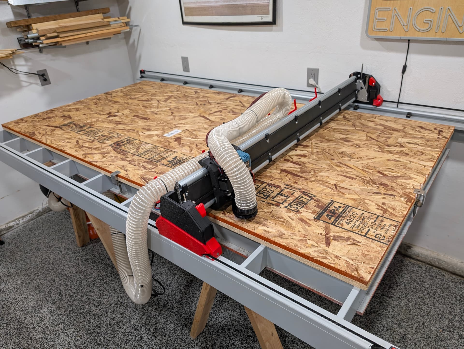

Real Build -
Here is the base I made to get it off the saw horses. Full size LowRider table base

Hi All, I have made a variant of this table and hoping you guys can help with where I’ve gone wrong as I’m having an issue with the router not being able to reach the end of the sheet.
My LR3 dimensions are
  • Rail length - 430mm
  • Cutting area - 1250x2500
  • Material thickness - 15mm
I used Ryans fusion model and modified the parameters to suit the required dimensions.
I then decided to change the ribs so that they would slot together, all in all from Ryans standard file with only the dimension changes vs my edits to the ribs end result all over is within a few mm. (sketches attached for ref)
I have assembled my table and installed the rail runners with 10mm overhang as per the sketch, then installed the rail clamps at the 61.75mm in from the edge. This however puts my router 25mm in on the sheet on the X-min side when it’s touching the endstop on the X-max however it does go 35mm past the edge of the sheet.
Let me know if any additional info is required.
How does it look the other side? Maybe you have it on backwards?
The sides do have a parameter for an extra inch I think? You can double check but I added a clamping surface. Your bit should end at the last rib, if that is the case just cut your surface down if you do not want the clamping surface added.
I did try flip it, as I did think that could be the issue.
But if I did that the Rail and its Rail Clamps didn’t fit the Runner so assumed I had it right to begin with.
The Y-Rail is currently sitting on the side with the wider of the Y-Runners.
Your comment around the overhang makes more sense.
The bit does end at the edge of the rib on the X-min side (hope Im using the correct terminology its the side with the X-end stop)
It then travels about 60mm past the edge of the opposing rib (non X end stop side)
I set my X_Useable to 1250, from what you are saying the 25mm of clamping area on the X-min side is literally only to be used for clamping and the router bit will never reach it.
This means I only end up with a spoil board cutting area of 1225, so If I wanted to have a full width spoil board covering the entire usable X the spoil board would need to be 1275w or 1300w if I wanted it to also have the 25mm clamping area on the X-Max side.
I have also just had another play with the adjustable parameters in the fusion file and set the X clamping area to 0mm, doing this only widens the ribs themselves and doesn’t adjust the placement of the spoil board so the result is the same as the above.
Correct.
That side lines up with the second set of ribs since they are offset by a rib width.
That is what I thought. I opened up the model and that is not how I did it. I actually have it set to move the ribs not change the surface.
correct, I was wrong in my previous assumtion.
So lets double check some things real quick. Can you please physically measure your X rail length, and the max distance your Core moves on the rail.
X-Rail length - 1430mm
Max travel - 1260mm (measured from centre of bit at each end of the X)
That is good, you are getting 10mm extra in terms of the build calc (as expected). That means you should have been able to get 5mm off each side, or more likely a bit more on the endstop side and a bit less on the other.
Where does the endmill land on each side of your 1250mm spoil board?
Can you put up a pic of the Y rail location, that sets everything.
