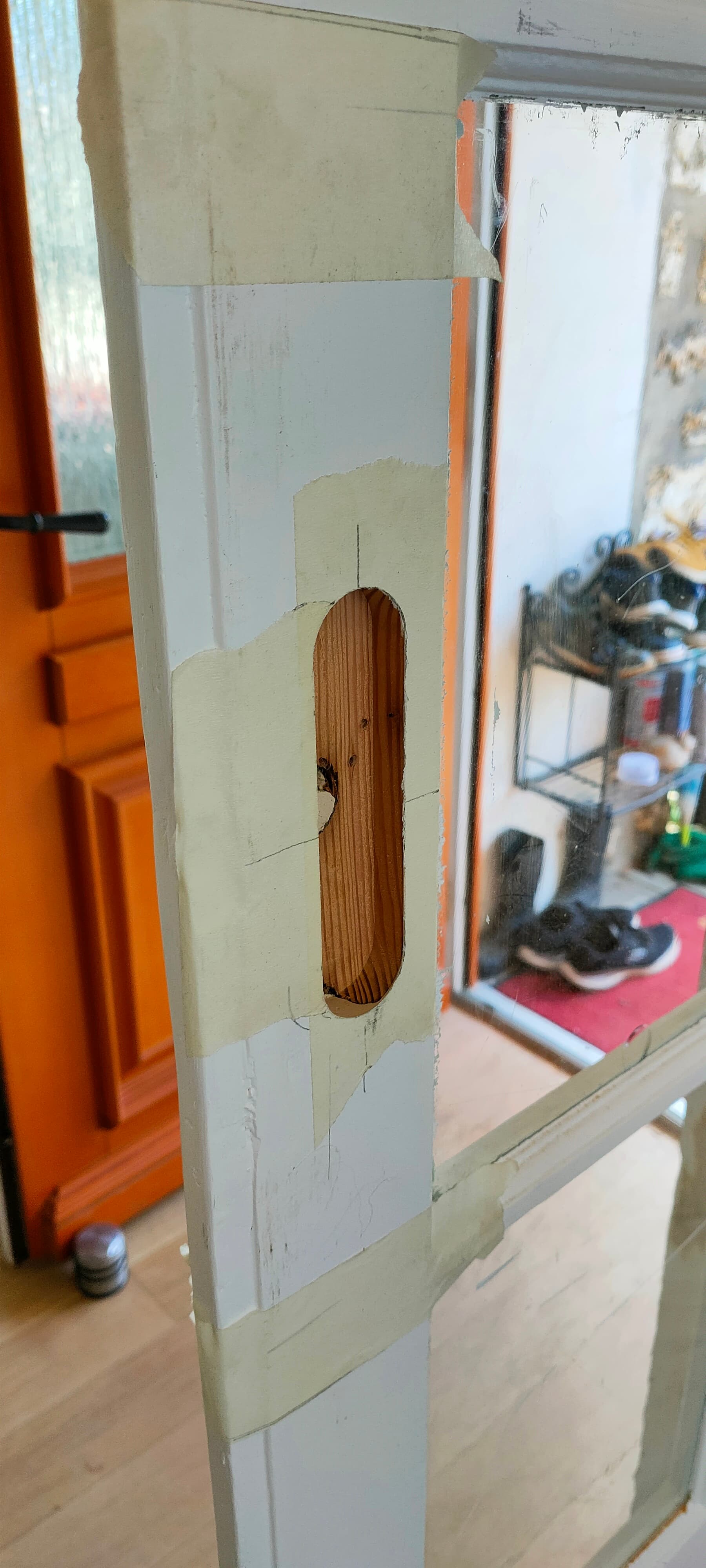

Pocket with a T-slot bit
Stressful cuts :slight_smile:
My hands are not as steady as the lr3 :stuck_out_tongue:
It looks great!
The flange covers all “wiggles”.

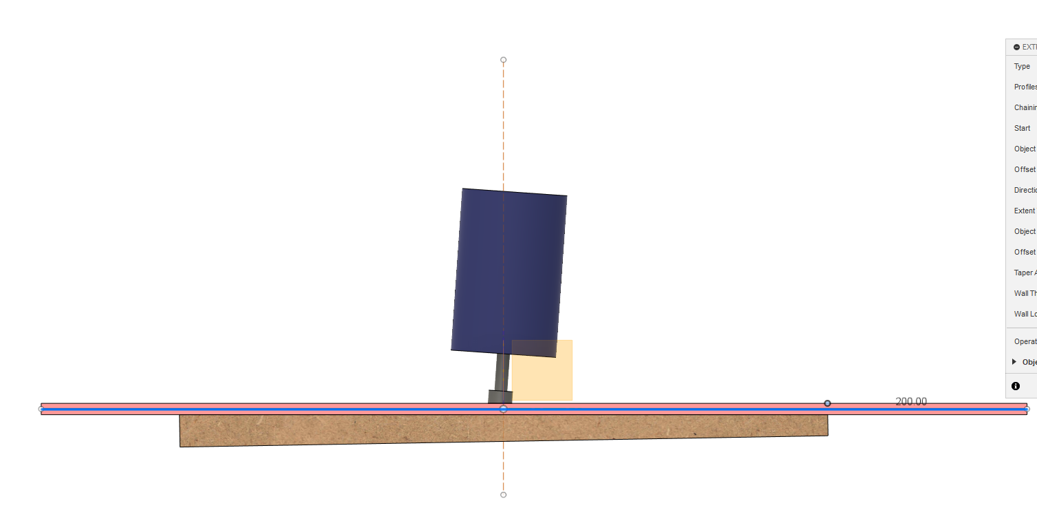

The thing is: if your gantry is not parrallel to the table (X axis), then the bit’s face won’t be parrallel to the surface too
Example with a table skewed in one direction and router skewed in the other
Surfacing with this setup, only the trailing edge of the bit would remove material, and lead to a poor finish
Also, if you machine both ways, this would become the leading edge in the other direction, and probably lead to some waves on the surface because it could bite more into the surface…
At least that’s how I see it…
After Surfacing though, you’d get something like this
The leading/trailing edge of the bit would be parrallel to the table, but the bit’s face still wouldn’t be parrallel to the table
You could try to tram the router from there, but for the X axis, that would mainly be re-leveling the gantry parrallel to the table… which you could’ve done in the first place
I think getting the gantry roughly parrallel to the table is the first setup you’d need to do
I’ll maybe need to think about it a bit more, but in your image, in order for that to happen, doesn’t the tool have to be “not perpendicular” to the X Motion?
Wouldn’t that red line have to be your X-Gantry parallel line in order to produce those results?

Say you start with a “slightly” crooked gantry :slight_smile:
Now we’re surfacing “as is”
After this, you get:
Note: This is broadly exagerated but I’m trying to visualize clearly what’s happening
So , all in all, you’d still need to make the bit perpendicular to the work surface to avoid waves when surfacing, and on the LR3, this can only be done by adjusting the gantry anyway (the tool is fixed in it’s mount and in the core)
Maybe then it’s just simpler to adjust the gantry in the first place before surfacing
For the sake of it, same exercise with a gantry roughly parrallel to the table, and a tool tilted in the mount
You’d need to “counter-tilt” by making the gantry un-parrallel to the surfaced table after the fact to compensate for the tilt
