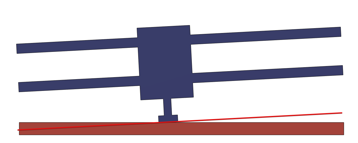

Why would the red surface not be parallel to the blue rails after surfacing?

Because the rails are supported by the sides that run on a fixed surface (you can’t surface under the wheels or under the Y rail)

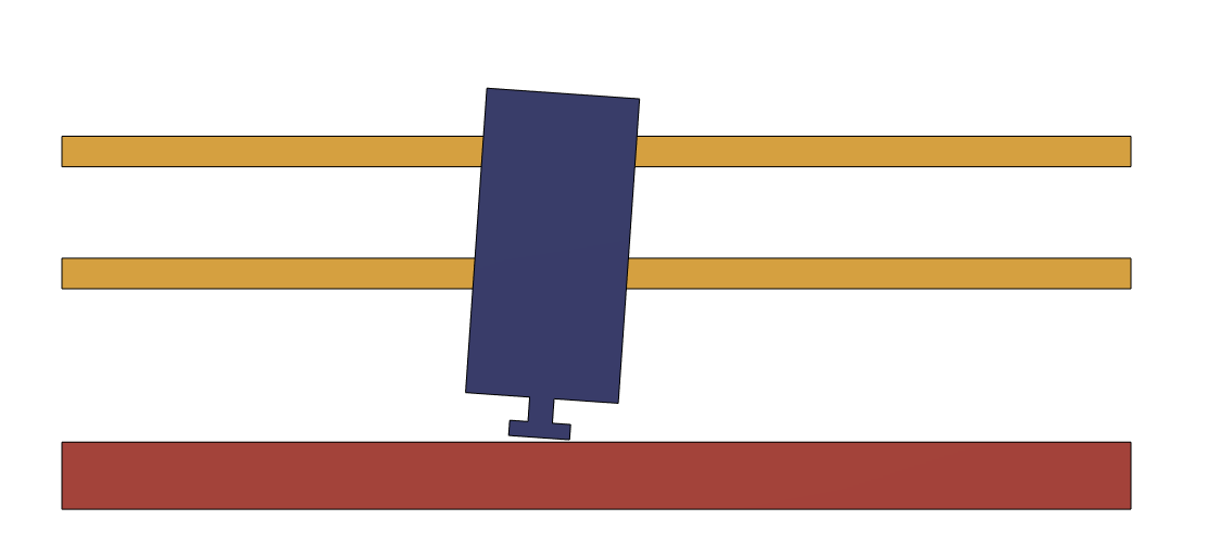

Note: I added a few drawing with the gantry roughly parrallel to the table and the tool slightly tilted in the mount somehow…
You’d end up making the gantry un-parrallel to the table to compensate for it…
The reality is probably a little bit more complicated anyway, because it’s probably a mix of both of these (gantry not perfectly parrall to the table, and router not perfectly perpendicular to the gantry)
EDIT: I see my first drawing is wrong, I’ll try to redo this…
That’s what I meant…
Wouldn’t the red line have to be the cut line after surfacing there?
That is what I would expect too, since the tool moves along the rails, the bed will be parallel to the rails in the X dimension. If you get your Z endstops wrong, this is what would happen.
If you tram the machine to that, it will be OK, since the tool will still be perpendicular to the motion axis. Correcting the Z endstops will fix it, though if gou surface the bed that way, it’ll be weird.
Yep… re-did the drawing with the right constraints…
Sorry for the errors, I’m trying to think along with you guys :slight_smile:
Gantry not parrallel to the table - Tool perpendicular to the gantry:
Gantry parrallel to the table - Tool not perpendicular to the gantry:
Mixed bag…
Take aways:
  • Having the gantry parrallel to the table in the first place does not affect the end result, but allows you to remove less material
  • After surfacing, the gantry is parrallel to the work surface, but the tool is not necessarly perpendicular to the work surface
  • Only the leading/trailing edge of the bit (depending on the way the tool is tilted) will follow parrallel to the surface, I don’t know if you would get significant marring from the difference of eight between the edges?
Following this, you’d need to adjust the gantry after the surfacing to make the tool perpendicular to the surface, and then re-surface the work area…
This is the only one that leaves the surface of the bit parallel with the table, which is why I was saying I thought tool/bit perpendicular to the gantry was most important.
Starting “roughly parallel gantry to spoil board” means less material removal, but the tool will correct minor inconsistencies after surfacing, so it feels like tool being perpendicular would help work things out easier.
I’m really not sure what kind of adjustments there are for making the tool perpendicular, but I guess I just assumed there were some.

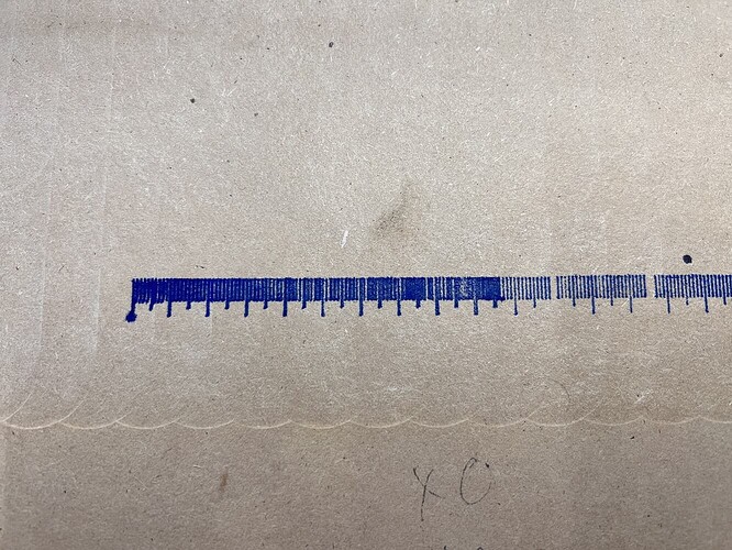

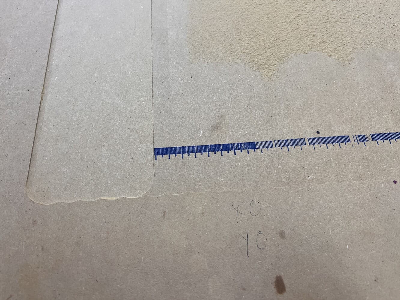

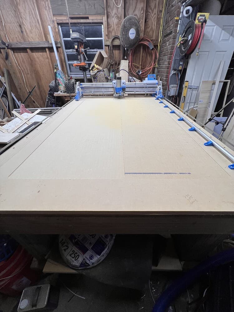

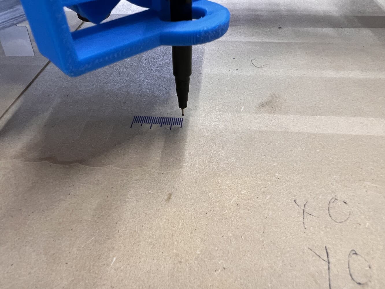

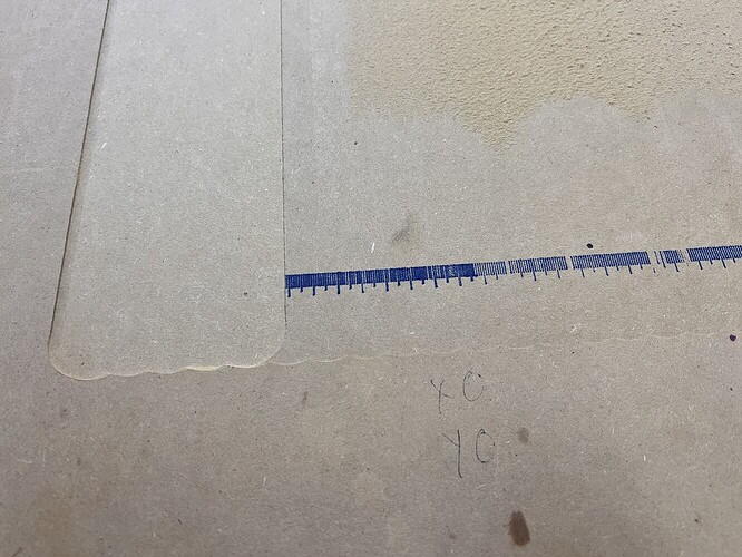

Here are some pics after my first surface…After an initial traming. Which I didn’t do near as good a job on as i did the second time…
Notice you can see the lines from the bit. Not far off but enough you can see it and I could feel it.
From this level I tramed the spindle in much more gooder…
After running the second surface you can see it was much more flat. Now I have no idea on all your models where my table and router stand. But it looks good from standing at the end of it and I haven’t had any issues with cutting too deep on one end of a project and not deep enough on another. And I don’t get the crazy lines I have to sand out when I do a surface job. And it seems to me if i was like your last pic then I would be back to lines with a 1 1/4" bit

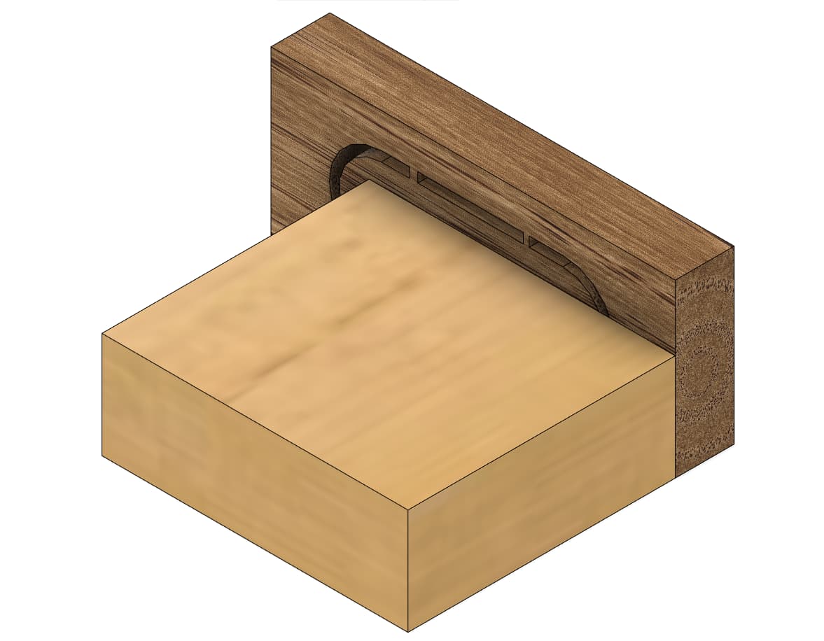

Looks as though everything worked out very nicely indeed, but I’m going to respond to the “how to” question anyway just in case what I have to say is useful for someone down the track.
I think the concept of making them in two pieces is very sound and the result you achieved superb, but I think you could have simplified the process a little by walking away from the cnc after the front parts had been cut.
Before I go on - here’s a little something I prepared earlier :smiley: that I probably wouldn’t bother using it in this instance because you don’t really need to be mm perfect but since you suggested it, another gratuitous link to one of my models can’t hurt :rofl:
TABLESAW THIN RIP JIG.
One of the things I’ve learned from fitting out boats is that unless you are making a fine jewel box or cabinet - if you can’t see the matching grain in the finished piece, there’s not a lot of point in spending time matching it.
I would have cut the “front” as you have, wihout the rebate in the back face, then cut the stock for the back to a consistent thickness, sanded and even finished before milling it.
I’d then cut the rebate in the back part with the cnc and depending on my mood, either cut the outline a mm or so oversize (probably what I’d do) and run around it with a flush trim bit after assembly, or cut it a mm undersize and call it done because it won’t be visible in the end.

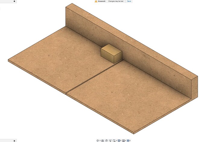

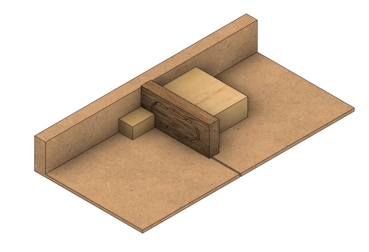

In this instance, if I needed to cut several of these parts I think I’d go the other way around:
  • Glue the blank with the cut contour to the end of some scrap
  • Set up a stop block on the right side of the saw sled, 2mm away from the blade (thickness I needed).
    This could probably be setup precisely using shims betwwen the blade and the block rather than measuring.
This gives you a setup where you can slide the stock up to the stop block, take a cut, back off, rinse and repeat
Align
Cut
Remove finished piece, and move right up to the block
No need to re-adjust the fence or anything after each cut, just cut some slices like a ham machine :stuck_out_tongue:

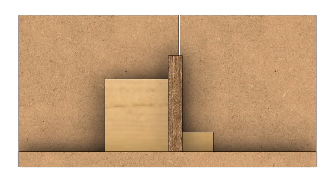

Thought for a sec about this possibility but there were several drawbacks
  • The main reason I added the rebate is not to locate the back piece, but to give more contact surface for the glue
  • Trimming the excess with a flush bit is definitely a great way to go, and you could indeed just roughly cut to size and then trim, but these are very light and flimsy parts, plus you’d have the “small” face lying on the table which is less stable… I’m not very confident in letting my finger so close to the router if I can avoid to
  • Just the harsh lazyness of setting up numerous tools :slight_smile: At the moment, my router is not mounted under a table, the table saw is barely usable, cutting the rough pieces would probably require a band saw (which I don’t own) or a jig saw (which would again be quite finnicky for small parts)
I think the solution with the contour routed out on the CNC while I already have the CNC, bit and stock setup and secured + just a few cuts on the table saw sled is the best combination of simplicity and effectiveness :slight_smile:
I don’t like that fixed stopper on the sled. There is quite a bit that can go wrong there (not that I haven’t done it)
I’d cut similarly with the scrap piece, but in the textbook position with the bit to be cut against the fence using a proper push block.

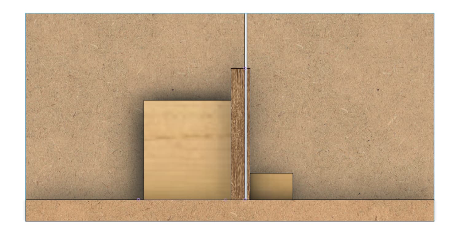

Yeah I know it’s bad practice to pinch the offcut between the blade and fence (or stop block here)
Things can go pretty wrong, almost got hit in the face with a chunk of 2x4 with this kind of setup in a mitter saw :confused:
But for this particular instance, I think the worst can happen is that the thin piece just get shattered if it gets caught
It would probably better to find a setup with a stop block for referencing the width of the cut reapitably, but not moving the stop block with the piece when cutting…
This could easily be done with a mitter gauge rather than the sled, but then you’d run the risk of the small part falling into the blade’s throat after the cut ^^"
Maybe a sled with a moving part on the left, and fixed part on the right?
Make the stop block the full length of the cut?
Don’t think this would work, you’d still get a “free moving” part between the blade and stop block
This could even be worse. If the stop block is shorter then the piece you cut, the piece can still “escape” somehow rather than gatting constantly banged between the blade and stop block
