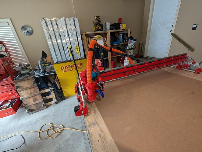

This build is YUUUGE! Usable cutting area is 1367mm x 2710mm.

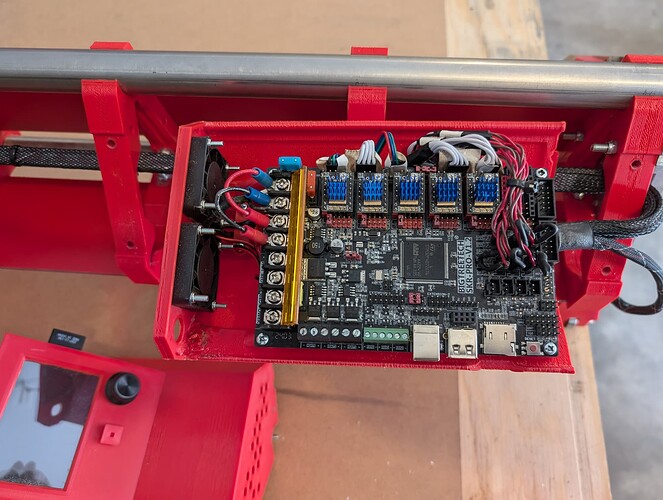

It uses the same SKR Pro V1.2, Vevor Router and 1" (0.120 wall thickness) stainless steel tubing as the original build, but there are a TON of modifications on this build.
The biggest modification was to use side mounted belts on both sides. I used @Fabien’s design as a starting point, and with help from @Rob_W, I modified it to work on both the rail and non-rail side. I did this so that I can use the table for other purposes without having to remove the belts and belt holders. I find that it works really well.
I also swapped the X/Y orientation around so that X is the long axis. (The gantry is still the short axis, but instead of the gantry being X, now it is Y). I did this mostly as an OCD thing (my design screen is landscape, why shouldn’t my CNC be the same?), plus the layout of my shop means that it is much easier to load material from the long edge rather than the short edge.
I needed to remix/design new belt holders and endstop switch holders to sit on the sides and also accommodate the portrait/landscape change.
I used M3 adjustment screws in the endstop blocks, and was able to get the square test to within 0.5mm over a 2.7m x 1.35m rectangle!
In order to increase rigidity for such a large gantry, I beefed up the strut braces by making them all 21mm wide (6mm wider than stock) , and increased the strut count to 11.
I used 6mm (1/4") aluminum for the XZ plate, and 9mm (3/8") aluminum for the YZ plate. The struts are 2 plys of 2.5mm aluminum. Everything was milled with the LR3…
With the beefed up gantry and the aluminum plates, this build is VERY rigid! The difference between this and the earlier build is like night and day.

One of the things that I spent a lot of time thinking about was cable/wire management. I used mesh loom, heat shrink, cable clamps and tie wraps to create what I hope is a professional looking build…
One of the trickiest parts was working out what to do for the gantry wiring/tubing (X endstop wires, probe wires, router power cable, air hose, IPA hose, etc.). Putting it all into a neat bundle and making sure it didn’t flop into the path of the core wheels was a bit of a challenge (at least to my feeble mind)…
I ended up using a section of 10mm OD PVC air hose with a piece of fencing wire inside to act as a stiffening rod, attached to the middle strut with a cable clamp , and to the core with a tie wrap. The core wires went into a mesh loom with the stiffening hose, and the air hose, IPA hose and router power cable went into a section of nylon split loom and attached to the stiffening rod with velcro straps. The vacuum hose also attaches with the same velcro straps. It seems to work pretty well.

Instead of building a drag chain system to hold the air hose, power cable and vacuum hose at the side of the table, I used a length of aircraft cable, some roller clips, and some springs.
It’s still a bit of a work in progress. The metal rollers don’t move very smoothly on the metal aircraft cable, so it jerks and jumps a bit. I’ll come up with a better solution…

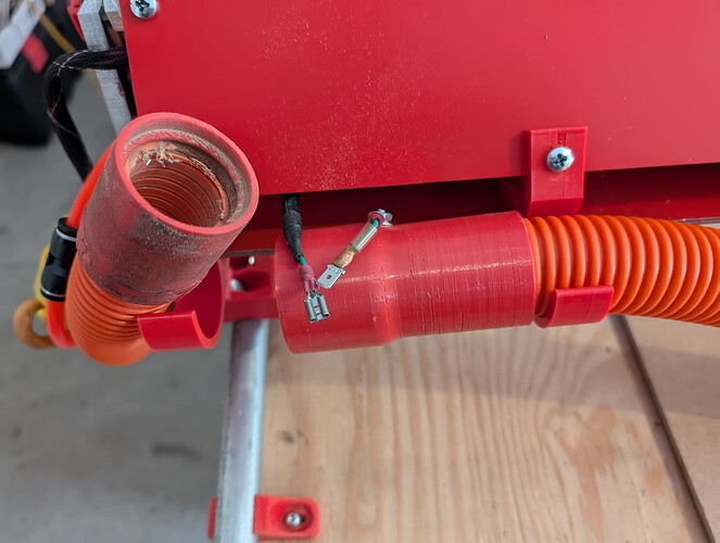

One more set of pictures with the vacuum hose attached…
Close up of the vacuum hose ground wire connection
I made a connection point for the vacuum hose, air hose and power cord where they drop down to the side of the table, so that I can quickly remove the gantry from the table.

I am curious though, why bring the wires and vac hose way up in the air like that?
Probably because I didn’t know any better! :upside_down_face:
In the absence of a drag chain system, I found that the cables could get in the way of the core upper bearing bolts. I actually had one cut on the earlier Little Red build fail when the router power cord got in the way of the core, causing the X (my Y) axis to skip steps. I wanted to have everything well out of the way for this build, and I remember seeing a “pogo pole” method that seemed interesting.
I get that. As long as it doesn’t hang on anything I don’t see it being a problem. But just watch out that it doesn’t pull on the core from way up there in any spots. That can end up throwing your cut off.
