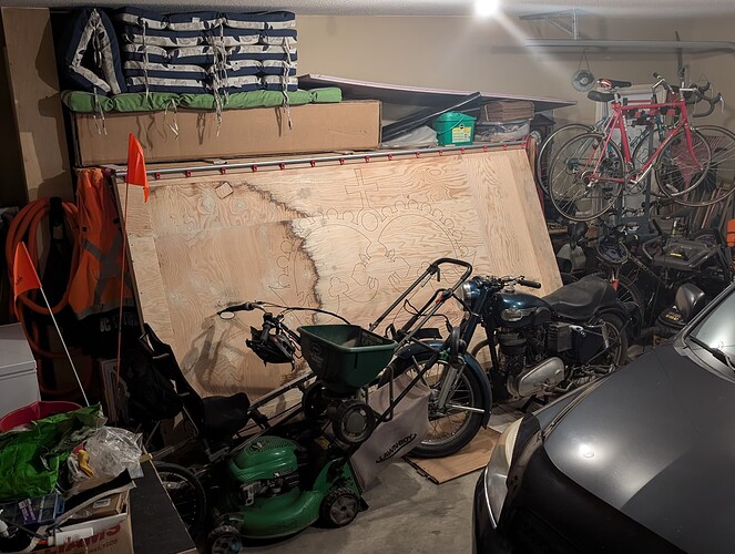

Well the rainy season has started here on the Wet Coast, and my wife wants to be able to park the car in the garage so she doesn’t get soaked whenever she leaves the house.
So it’s time to put away the LR3 and table for a few months…
Time for some long delayed indoor projects (cleaning/washing all of the interior walls, cleaning the windows and blinds, thinning out several closets, painting a couple of rooms, cleaning the bathroom exhaust vents - the list is seemingly endless).
It also gives me some time to plan out the next stage of the journey, and that is to actually make/build things with the LR3. I started the project thinking that I would build myself a custom poker table, so now I will start the process of designing the parts in Fusion, gathering up all the materials (foam padding for the table surface, different foam for the rails, vinyl for the rails, etc.) and learning Adobe Illustrator enough to design and print a custom felt for the table.
I’m also browsing this forum and some other sites for ideas for things to make with the LR3. Lots of creative ideas out there, for sure.
I’ll still be visiting the forum regularly, and posting in other threads as the mood strikes, but this thread will probably be dormant for a while (barring any replies for you all). See you back here in a few months!
