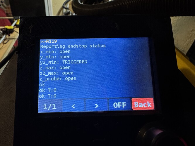

So apparently I marked all my steppers but not my end stops, so during final reassembly I had to test and move end stop plugs around.
During my testing, I found that my Y2 end stop showed as triggered even when it wasn’t pushed in. Checked everything and still showed up triggered… UNPLUGGED it and it still shows as TRIGGERED.
(That little bit of solder off to the left of the end stop headers has always been there and has never been an issue before)
This is a new one for my SKR Pro… any ideas? @vicious1 @SupraGuy @DougJoseph

This is normal. The ground and signal need to be shorted to show open.
