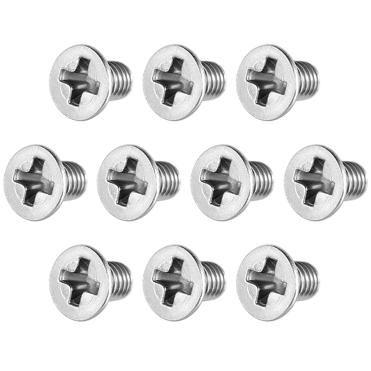

Did you decide not to countersink the screws on the aluminum strut plate?
I did. I went back and forth and ultimately decided not to. And now I wish I would have. But oh well…too late now LOL
You can save that for the Re-Rebuild. :smiley:

I keep thinking about this and I think I have come up with a new plan.
Going to order some “flat head” screws…
And use a countersink bit on my drill press to set them down flat. That will buy me enough room to run the acrylic solid across behind the strut. When I was deciding which way to go I was looking at it from the end, and everywhere there is a brace the strut is solid. So I said to my self there is no need to run it solid, just put pieces in between. Never once thinking about the middle “Lowrider 3” But I think this plan will get me the ability to run them full now.

I have one rod bit of input, for counter sinking.
These micro stops are very handy if your doing a bunch. It just goes in your drill and you set your depth and lock it in so it’s repeatable. And they have some neat bits that go in as well. Can’t wait to see the lights man.
Boeing used to be the go to for bits and sheet metal stuff. You can get them on eBay used for like 35.00.
I can honestly say I have never seen a countersink bit like that before. I was just planning to use the adjustable stop on my drill press. I have some scrap around that I can do some test on and get it set just right I hope
Oh yeah for sure your drill press will work.
Just some times you can’t get access and these can be useful.
I don’t disagree at all. I’m looking them up on eBay here in a few
