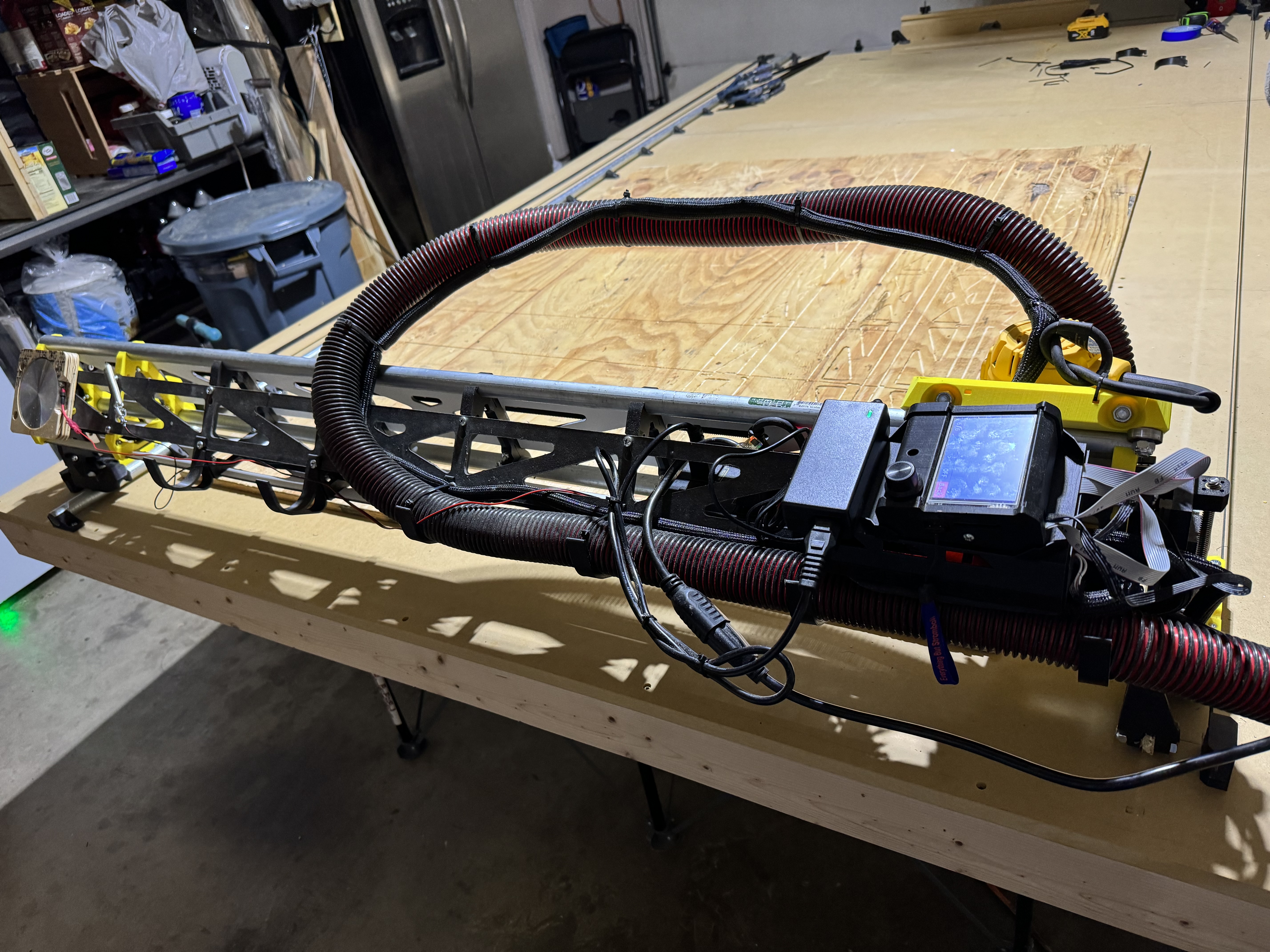

I just finished building the 6’-10’ break-down table platform on Bora Centipede legs that stands up and breaks down in 20 minutes into three pieces and slides off into a corner. It should support work up to a full 4x8 sheet.
Now I’m just working on getting the final calibration and configuration details worked out to convert from my prior cnc over to this one.
Let me know what you think!

What are the dimensions of the table when assembled?
Full table once assembled is 120-in long x 7-in wide" x 31-in tall
How are you connecting the three table top pieces?
I have 1/4-20 threaded inserts on the undersides (2 on each side) with 3-in bolts and knob-ends between the three sections
Are you experiencing any twist or unevenness in the table, with only the perimeter being reinforced (no torsion box support)?
I am seeing a little unevenness across the centers between the bolt connections and im. probably going to throw a biscuit jointer at them at strategic locations to limit this.
How do you find the Bora Centipede legs for stability? They look like they might have a bit of wobble if you put any side pressure on them
I find the Bora legs very stable along the long (y) axis with a bit of wiggle along the short (x) axis. I have the 48x96 set sat on a very flat garage slab.

I’m finally got around to a little cable management and added a bit of a z-axis probe upgrade.
I added cable loom to all the major runs and re-ran the cabling through the center of the gantry and moved the IoT switch into that space as well. I found out my handwriting sucks horribly when I re-connected the stepper motor cables and mixed up the E0 and E1 connections… that was fun to watch…
For the z-probe upgrade, I used a 100mm diameter 10mm thickness aluminum plate and a bar magnet to made the z-probe attachment and removal much smoother. Then I added a mount on the far side of the gantry to keep the wire off the table and stuck the magnet to a screw. I’m hoping to update it to a full 3 axis probe at some point by milling out a corner underneath and adjusting for the height difference.
Still a little work to do on a couple power cables at the back, but that’s enough for one day…
