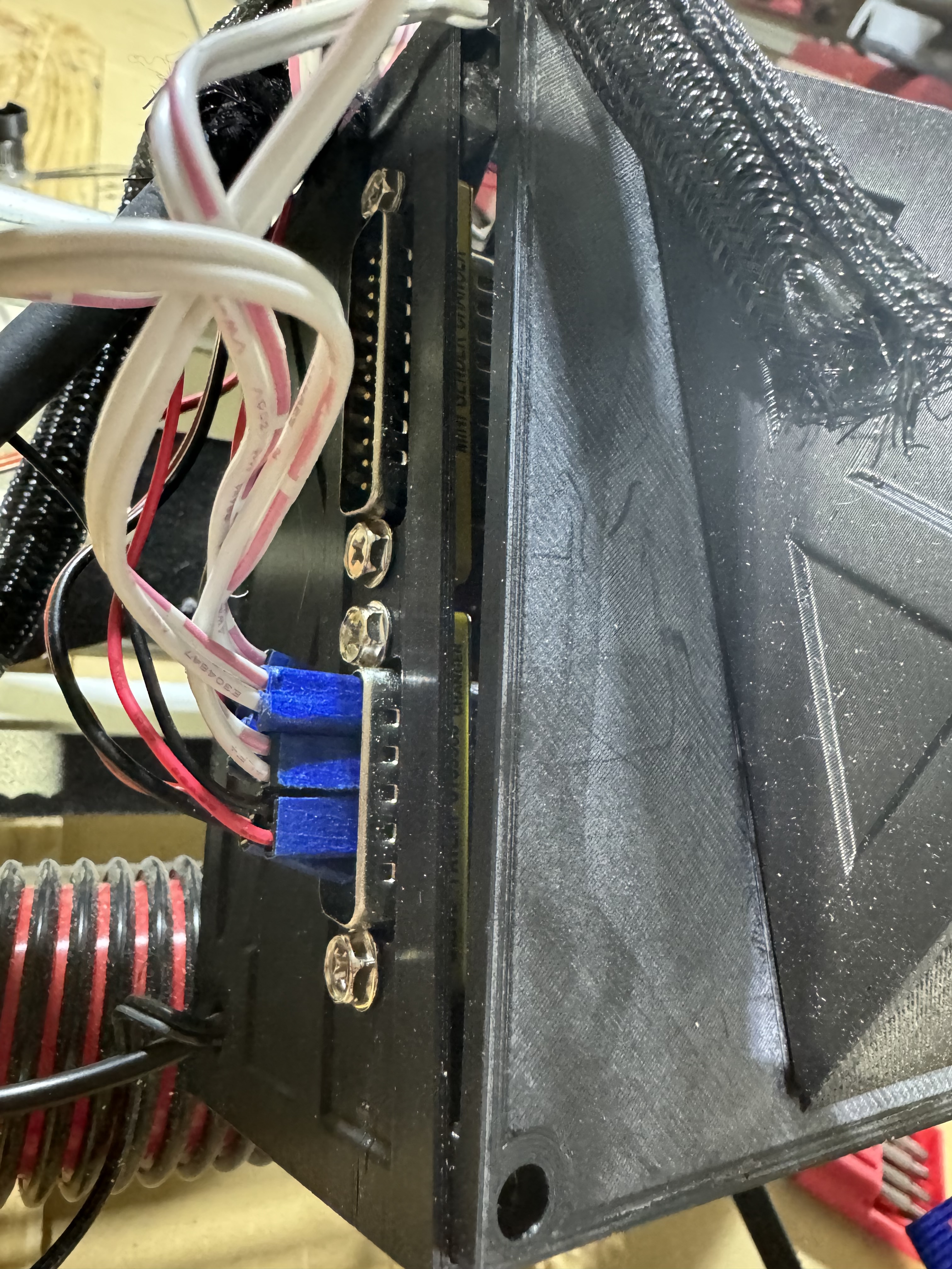

Well this rewiring and re-boxing of the SKR Pro turned into an entire $!#%-show… all I wanted was more room to install the correct type of wiring (JST-XH) connectors so the slide top on the old case would stop pulling my connections when I went to close the case… I figured this other case style would also allow me to more easily pull the controller off the gantry if I needed to work on it…

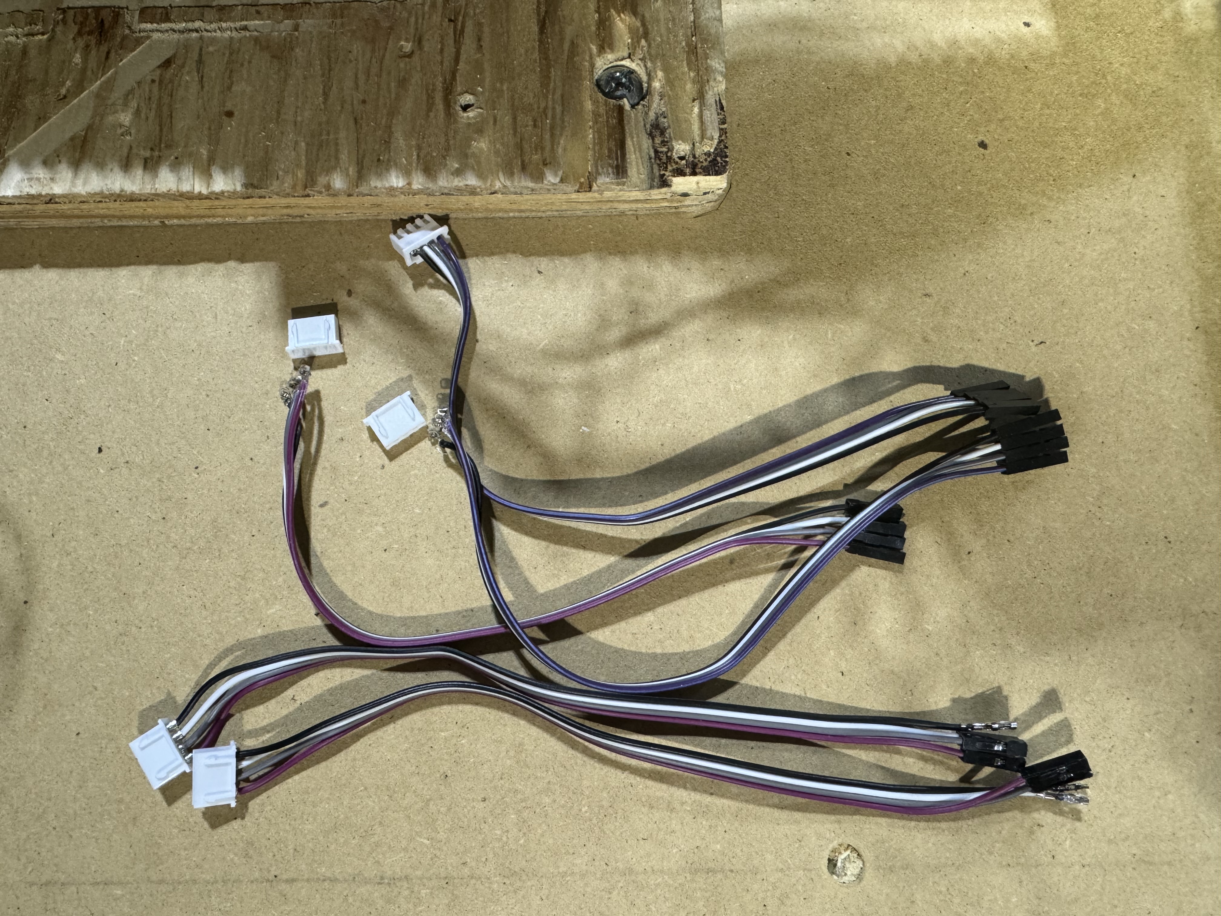

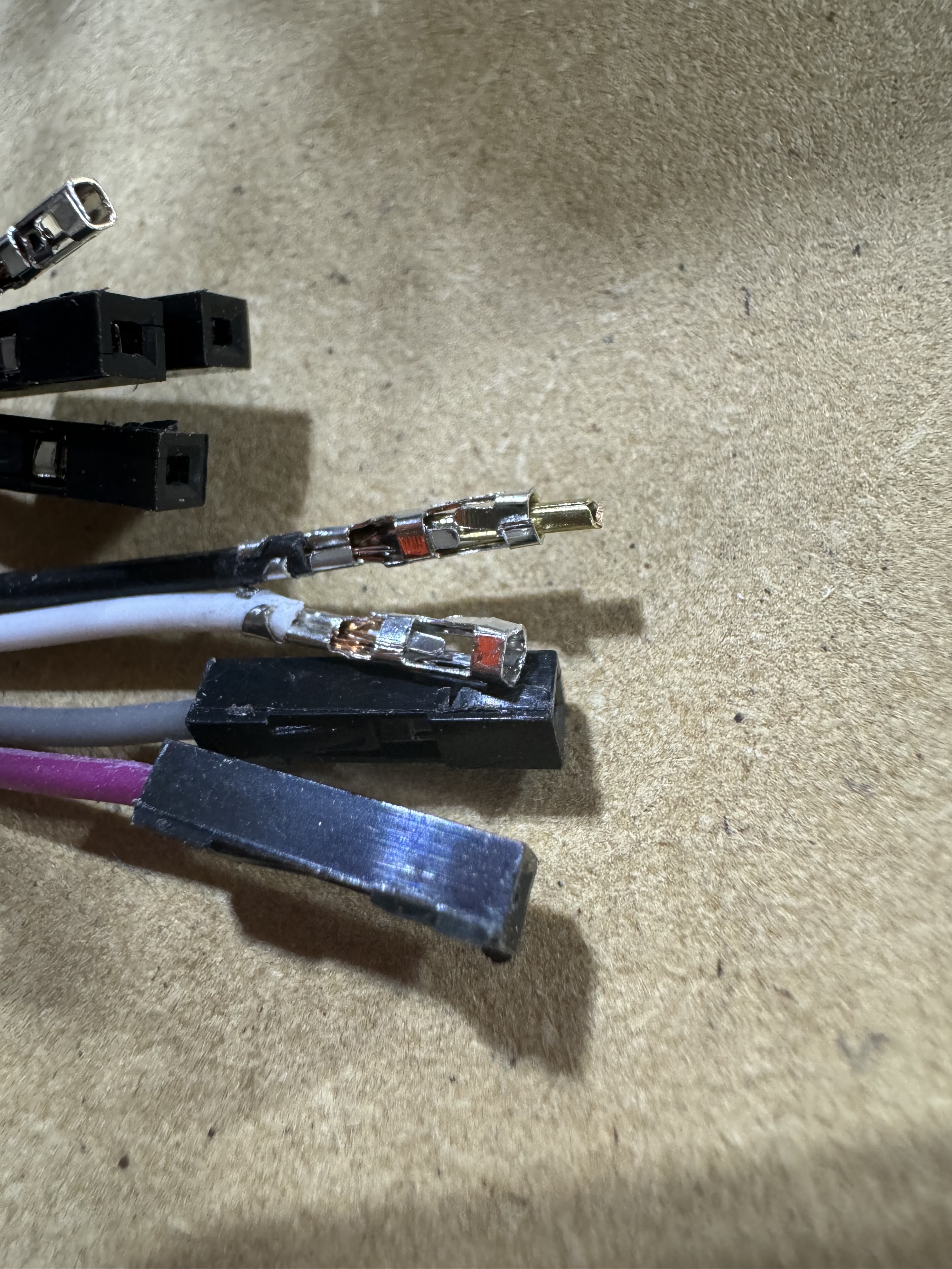

  1. my crimping skills apparently need a lot of work
  2. the quality of wiring I purchased is just crap, the DuPont housings just disintegrate at the slightest bit of pressure.
  3. Amazon sent me the wrong crimp package so I can’t redo the DuPont connections.
  4. the current wires apparently pulled out one of the pins on the gender changer on the side panel, which is terrifying, but probably means the quality of that part is crap too…
  5. I should have cut the mounts for the new box before I pulled the controller out of the old box.
The correct (hopefully) JST-XH/Dupont crimp kit should be here Wednesday, at which point we will begin anew, probably with brand new wires and connectors cut to exact lengths for the stepper and end stop connections and not have wires flailing everywhere.

One question, my X-stepper wire connection has what appears to be a slightly melted housing on the 1 wire. Should I be concerned? Is this a common occurrence?

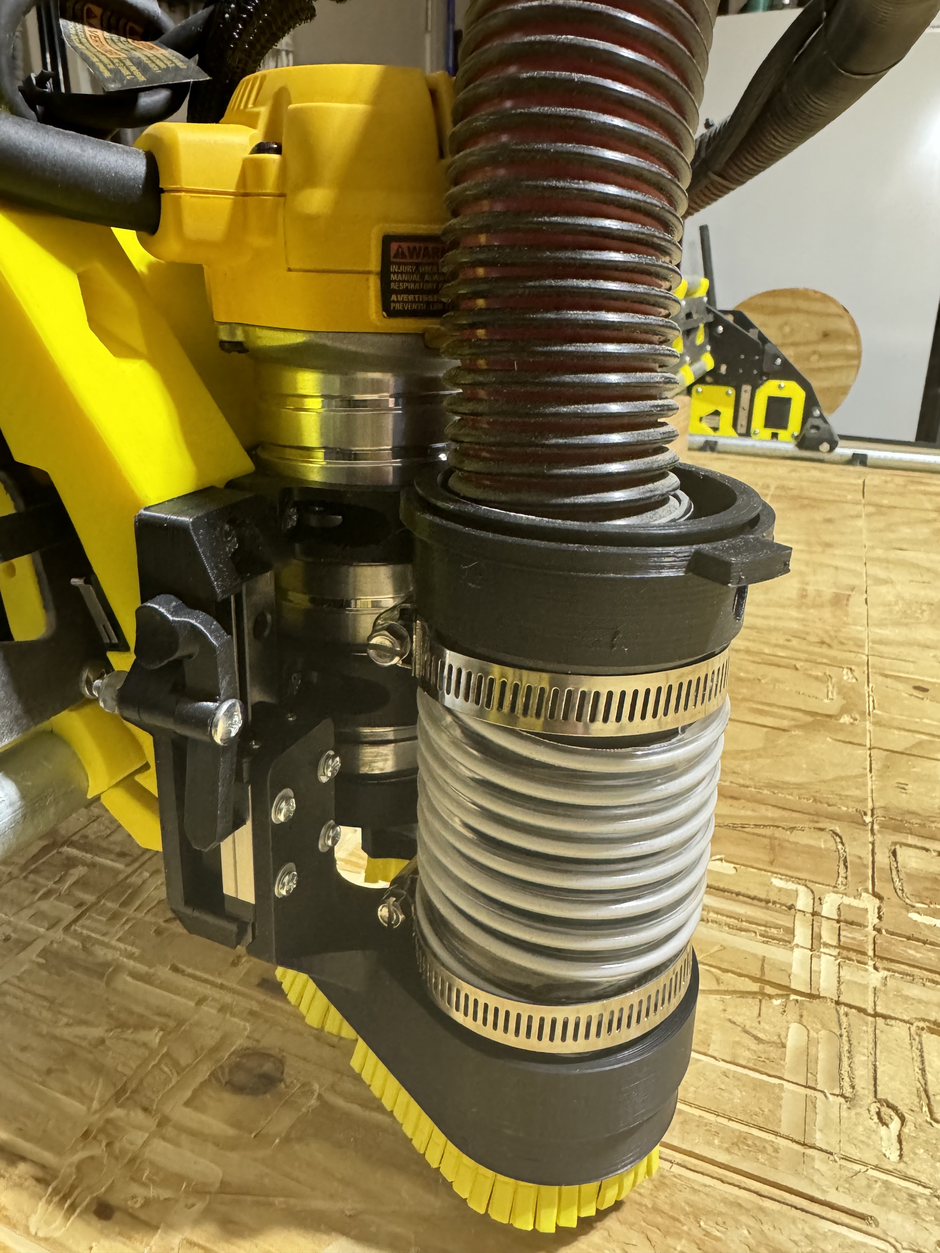

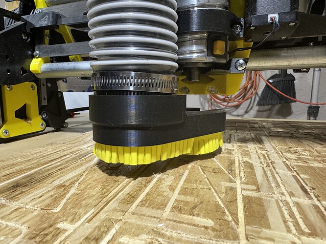

On the other hand… everything looks like it fits perfectly. I need to work on the hose connection and the 2-1/2 hose looks to be pushing too much so I may have to shorten it. However, with my controller tragedy, can’t test it yet.

Okay, the new DuPont/JST-XH kit got here and it’s all re-crimped and re-wired up. These new connectors are WAY better than the prior kit and the original DuPont shells. My giant man hands and those little bitty JST female connectors are SO much fun together…
I’ll see if I can hook it up for testing once the mounts finish printing. I decided to go with the 3D printer instead so I don’t have to paint. It’ll be done tomorrow afternoon sometime.

Ok, got everything reassembled and mounted… as soon as everything checks out, the glue gun will make an appearance….
End-stops, check!
M106/M107 IoT relay control, check!
TFT connection, check!
Stepper control, FAIL.
I’ve got zero movement on any axis, checked all my new cables for the steppers and end-stops and the connections are good.
I checked the motor power crossover and it looks good. I checked the voltage across the three fuses and got nothing on any of them. My 3.3, 5 and 12V lights are all on…
From what I gather, a reversed stepper connection should still power up and move, just in the wrong direction, so I don’t think that’s an issue I can test yet…
What else should I be looking for?

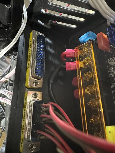

I’d start with a close-up picture of your board/motor wiring crossover setup.
The one linked uptread doesn’t allow one to confirm you have +/- correctly installed at the terminal blocks.
Next, use your DMM in voltage mode with the borard power on and report the voltage you measure across the board inlet power + / - and also the voltage you measure across the motor power + / -.

Edit to add- in the picture above, the top + connection has a black wire installed below the red top wire.
That’s at best really bad practice, at worst you have flipped power to the motors.
Unfortunately that black wire you see under the red one is my power supply connection and it’s black on both sides.
I measured the voltage across the inlet power and the motor power terminals and I’m getting 24.4V on both.
