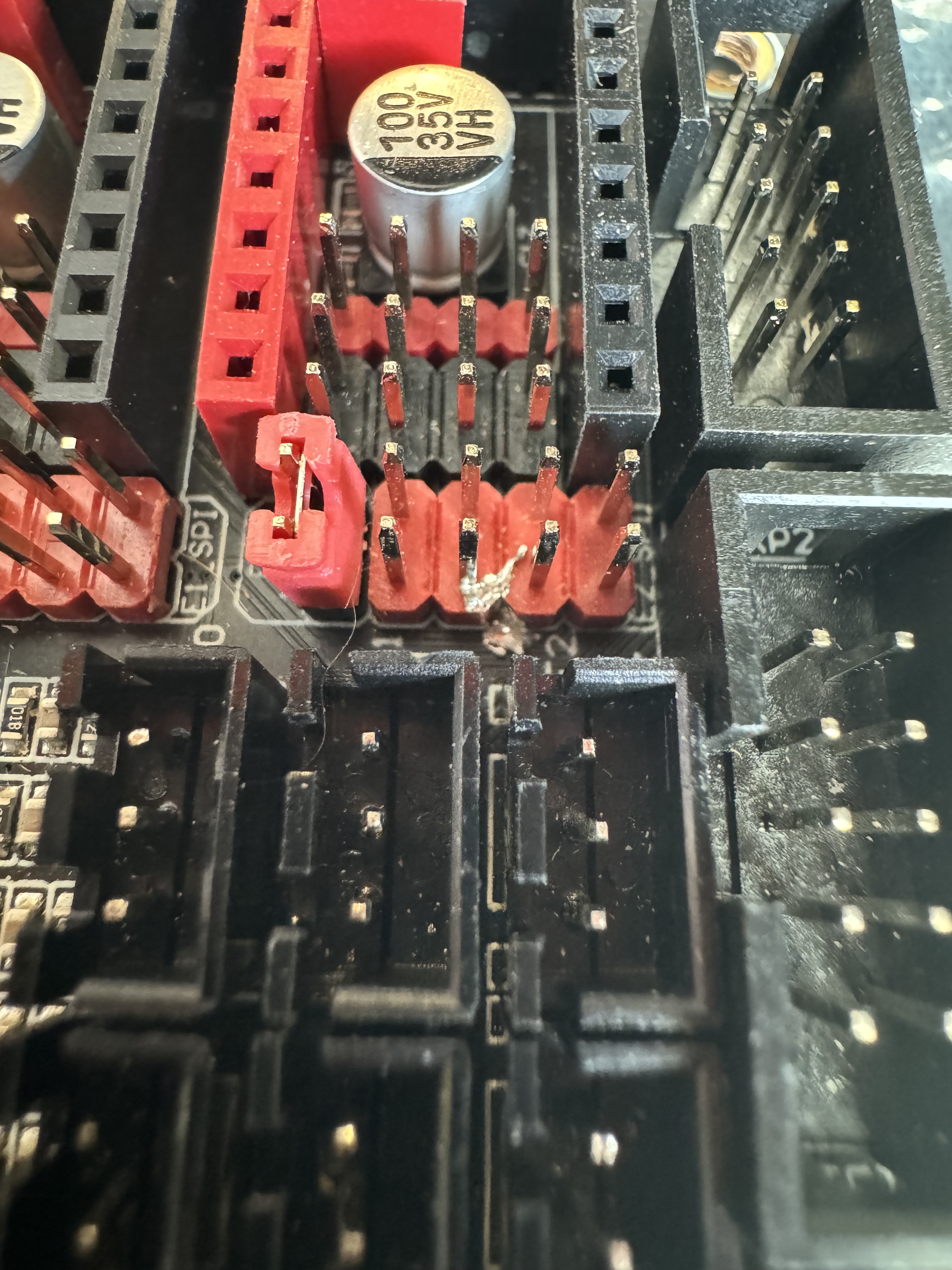

I got my old board out just now and took a detailed look, no burned spots or any physical damage that I could detect.

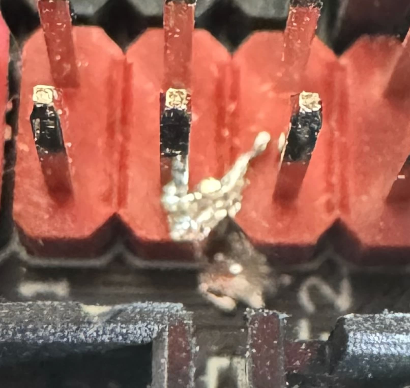

However, I did find this, which makes bo sense since I’ve never had a soldering iron near this thing…
Wow, that is weird. Interesting find

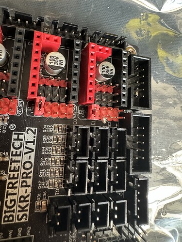

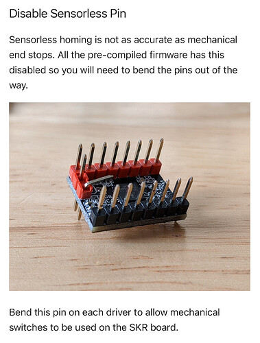

Just noticed that you didn’t bend the pins on your SKR board (as per the documentation), which very well could explain why you were having issues.
I’m not sure if I’m reading this correctly or if I missed something, but the documentation I’m seeing says to bend a pin on each driver board, not the SKR main board, right?
Am I missing another pin bend instruction somewhere else?
Also, this was running like a champ for 3 weeks and then went down, so I don’t think that was it.
I cut mine off the driver, so I think modifying the driver is preferred vs modifying the board.

Is that a solder splash? Can you use a pick or similar and clear it off?
The lower one is on the board surface and could account for an issue.
The docs do say to bend the pin on the TMC2209s, no mods to the SKR board are required. I personally don’t like bending the pin, I’d rather clip it as if I ever wanted to use sensorless homing I could always re-solder a pin or header to restore the functionality. Having the pin bent over is a recipe to short it to things, in my opinion.
No, that’s correct.
I’d suspect that workmanship issue you found up above with the solder splash has more to do with your sudden failure than anything else.
