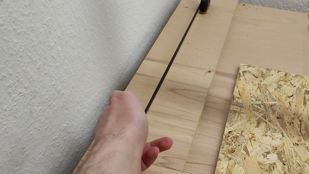

I have a 0.22mm difference between the two sides on Z, I think I can live with that. The other axis’ seem to be on point, though I could only roughly measure. :smiley:
