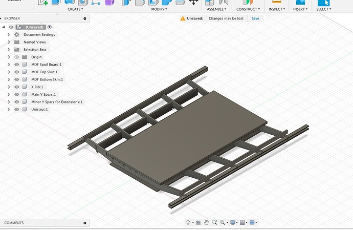

I’m pretty new to Fusion 360 so I may be missing something in the parameters, but I’ve been trying to shrink the design to template my 30 x 60 cutting area sized LR3.
I’m using CNC Table for LR3, METAL RAIL (parametric, full sheet) v8.f3d
When I enter the cutting area, the Y spars look roughly correct, but the X ribs remain very wide. When I look at the formula: Pattern_Length_for_X_ribs = Y_Spar_Length - ( 1 * Thickness_Plywood_Material ).
It seems to me that the X-rib width should be dependent on something other than the Y Spars? (Unless this is the pattern for the notches?). Anyway - I see where the Y spars adjust to my cut dimensions, but I can’t seem to get the X ribs to adjust. Any idea which parameter I’m missing in this?
Thanks for any guidance. I’m thinking the X ribs are coming out about 19 inches too long.
In looking at the screenshot, it also captures a wonky Y Spar spacing.
I am away from my computer right now, so I can’t take a shot at modifying the original file for you at this moment. I did later publish a another similar table that uses a different approach at the parameter options (hopefully a better approach), and I released various different sizes of that newer table. The link below is to a smaller size of it. It may be more well-suited for you to tweak the parameters in that one, and then the only thing left is to modify the X ribs so that they accommodate the metal strut.
Here’s a quote from there about the improvement to the parameter approach:
Compared to my original table work , these “version 2” tables have some parameter tweaks intended to make the tables more robust for scaling as needed and to make it easier to edit the number of X ribs and number of Y spars just by editing the parameters with those names.
