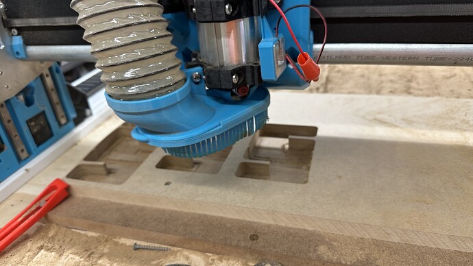

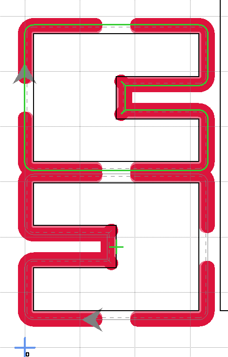

I’m playing with the LR4 torsion table generator from @franklyrosalind and cutting the test pieces to verify I have the material thickness set correctly in the generator. The pieces I’m cutting look like so
I use EstlCAM to set up the cuts, save the program and upload it to FluidNC.

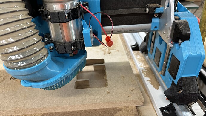

What I’m finding is that the size of the internal “notch” is different, depending on whether I cut close to Xmin or Xmax, but with the same starting Y axis location. For example, the notch (denoted by the red arrows in the pic) in the piece that was cut near Xmin is 0.7480", while the piece cut near Xmax is 0.7615". (The notch is actually supposed to 0.77" as per EstlCAM, so maybe that’s part of the problem also.)
Any ideas how to explain this difference or where to look for making adjustments? I’m starting to suspect that maybe there’s something wonky about the belts I’m using – sourced from Amazon, no idea what their lineage is.
Note also that I discovered the core was a bit loose on the X rails, so I snugged the roller bearings down a bit prior to making these cuts and don’t see the same flexing that I saw before. And if anything, I would expect that adjustment to make the cuts more accurate.

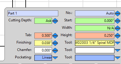

Did not use a finishing pass, that’s probably something I need to learn about.
If you’re using EstlCAM, a finish pass is quite easy to add and helps a lot with dimensional accuracy :smiley:

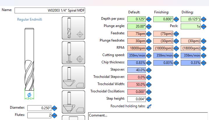

  • Reduced feed rate to 75 inches/minute (1905 mm/min), DOC to 0.125" and added a 0.038" full-depth (0.80") finishing pass.

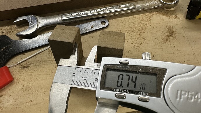

The 0.77" notch in the test cut measures 0.7410"

can you measure your bit? it is exactly the size it says on it description?
Your tool is labeled W02003, is that actually the spetool compression bit? (just for my own curiosity!)

0.802" – not the 0.77" they’re supposed to be! And the overall width of the pieces is 2.340" – but is supposed to be 2.310"
I get exactly 0.250" measuring at the tip and on the unmachined part of the bit. Glad you asked, because that would have been a nice find if was the source of the problem.

It sure looks like your bit radius is 0.015" smaller than truly 0.125". All your measurements make sense if you add a 0.015" buffer around the intended shape.
Cut a line and measure the resulting slot should confirm the actual width.
Can you measure at the tip of your bit? I have had a lot of cheap Chinese bits measurements all over the place, never had that issue with the amana bits. Try something else: get some lesser doc and only one small pass and measure (guess will be 2 passes so you can get your finishing pass in.) have any way to measure the runout of yout router with and without the collet/nut?
It’s right at .25" at the tip and at several spots along the length (hard to measure accurately). I agree that it could very well be an issue with the actual bit size, but I’m not going to plop down $75 on an Amana end mill just to find out if it works better.
