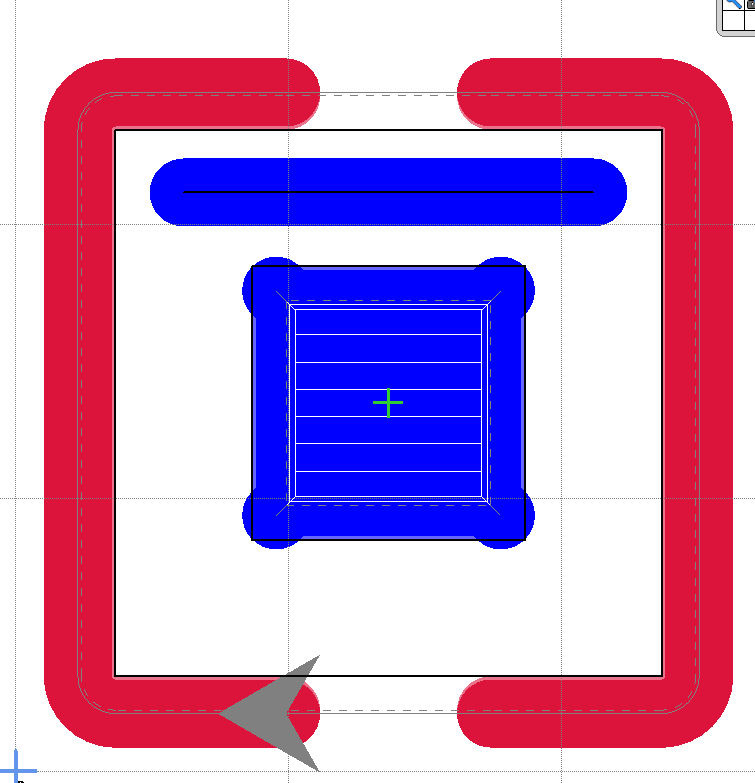

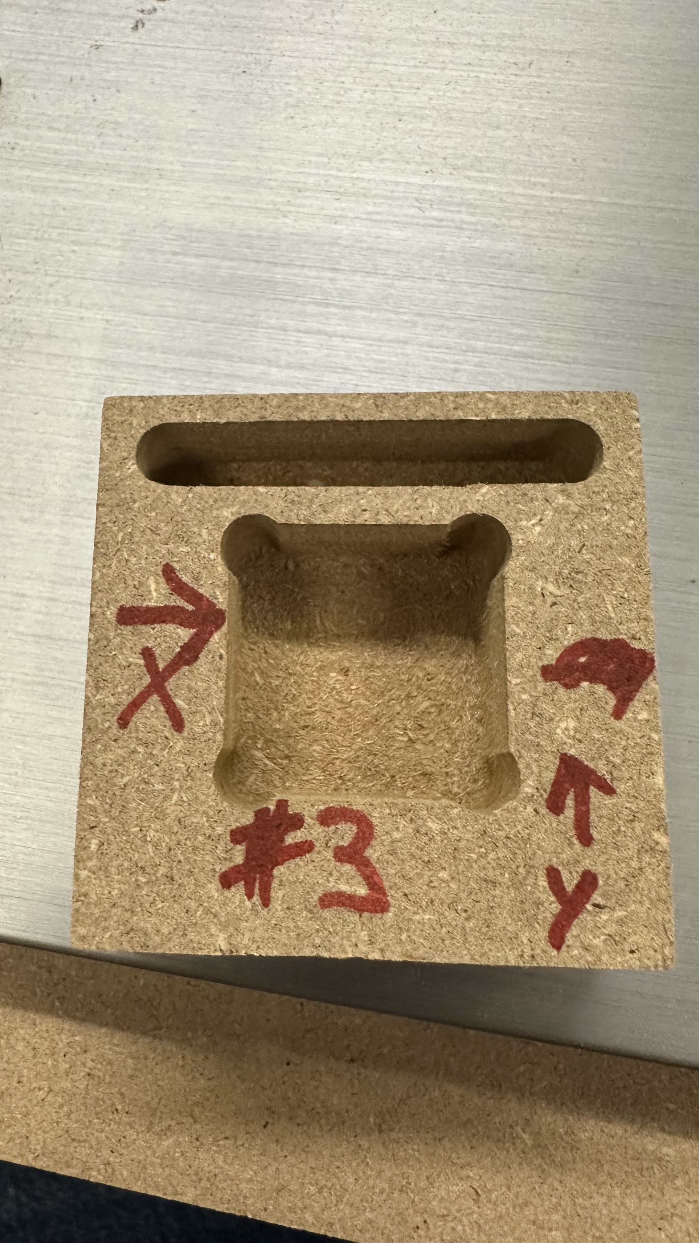

Today I made a 2" square block with a 1" square pocket in the middle and a short straight engraved line for measuring the actual cut width of the bit.
Made several cuts, measured the heck out of them and here’s what I ended up with.
Outside edge:
Width (X axis) 2.019"
Length (Y axis) 2.019"
Pocket:
Width (X axis) 0.9825"
Length (Y Axis) 0.981"
Engraved line 0.2520"
So it seems like almost everything is off by about .020" - consistently in both axes.
If it was runout in the router, I think I would expect the outside cuts to be undersized and the inside cuts to be oversized, so I don’t think that’s the problem. The width of the engraved line does sort of point to runout, though.

With respect to your cutting dimensions, if you’ve gotten all of the play you can out of the core (to rail connection), I would change your endmill diameter setting from 0.250" to 0.231". And then verify on both your 2" square block cut and something much larger.
I also ponder whether you’re seeing some effects of the pressboard material you’re cutting and/or issues with chip evacuation (that could result in the slot being wider than the endmill) and/or with router speed… most how many RPMs are you running at? Most people here see to recommend single flute endmills due to not being able to cut slow enough for a dual flute endmill.
Only had time for a quick test, but making this change resulted in almost dead-on measurements on my 2x2 block - inside and outside.
So what does that really say?
Seems like either the endmill cuts that diameter or you’ve got about 0.019" of play in your router/spindle bearing(s). The latter might explain the 0.2520" slot width.
I’d try a different endmill and compare results.
If it’s spindle bearing play of 0.019" you should be able to feel it.

Ok, so I ran one more test, this time with a 1/4” upcut bit.
Outside dimensions are almost perfect, inside dimensions are under by 0.008” and the slot width is about 0.008” wider than it should be.
So this feels like progress. Though I’m not sure what the controlling variable is…
