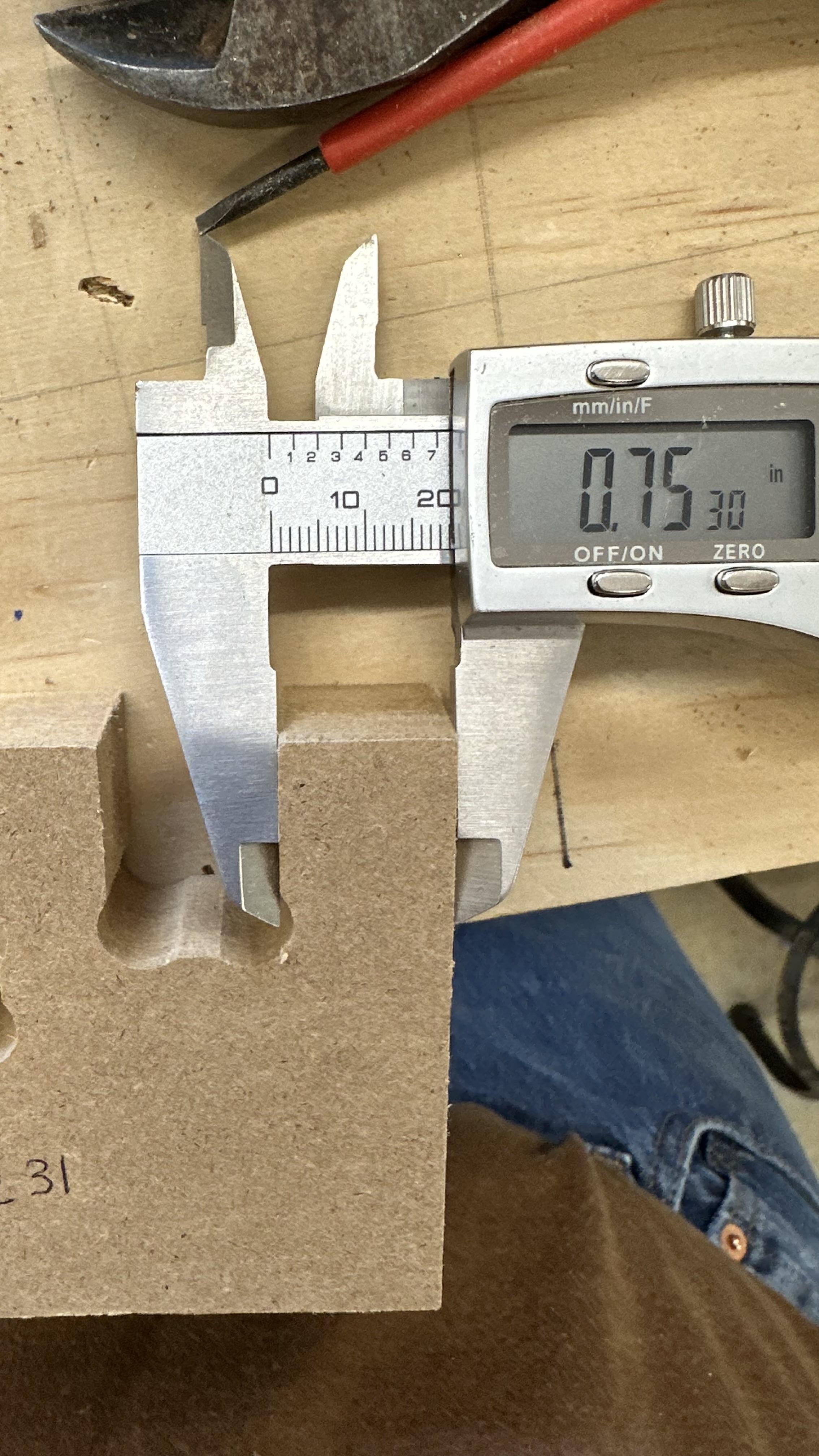

My results:
  • Material: 3/4" MDF
  • Endmill: SpeTools 1/4" 2-flute upcut
  • Feeds and speeds: 60 in/min (1524 mm/min), .25" depth of cut, 0.02" finishing pass at full depth. Approx. 14000 RPM on a Carbide 3D router (Makita knockoff). Holding tabs at the top just left of center, and on the right and bottom at about center.
  • Measurements:
    .75" notch on the left is .735"; the notch on the top is .725" and both .75" “stubs” are .775. Overall width and length is 3.02".

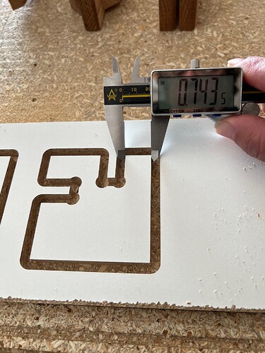

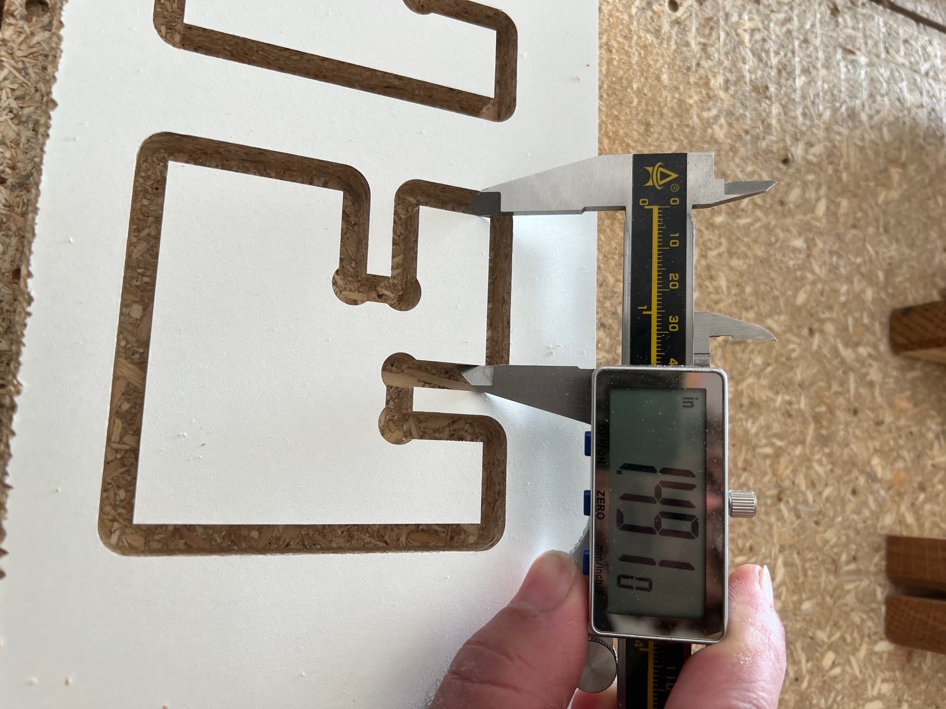

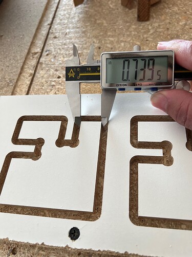

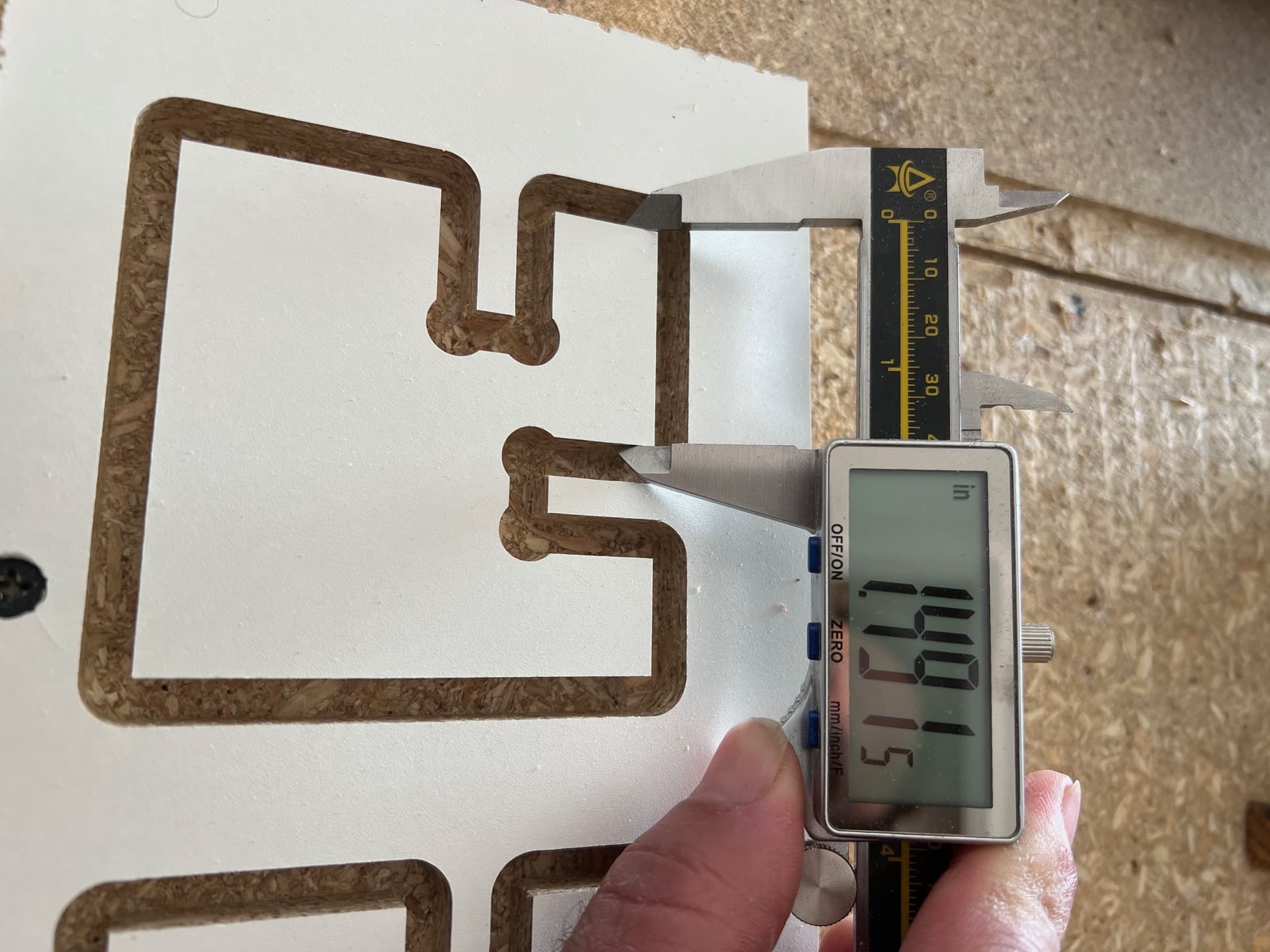

Here is my test @anon32961777, first one is no finishing pass, 2nd one is with .2mm finishing
Just wanna put this out there, for wood, -0.12446mm error is pretty good in my book.
Can it better, yes, Again though I would do that test in 0.25" or less material to cancel out tramming.

But (from my original results above), try taking a .750" piece of MDF and fitting it in a .735" wide slot. You might be able to jam it in there or force it in with a hammer, but it’s not a proper fit. But - as I’ve learned - once you figure out that you can lie to your CAM software about the width of your end mill, you can achieve a near-perfect fit.
