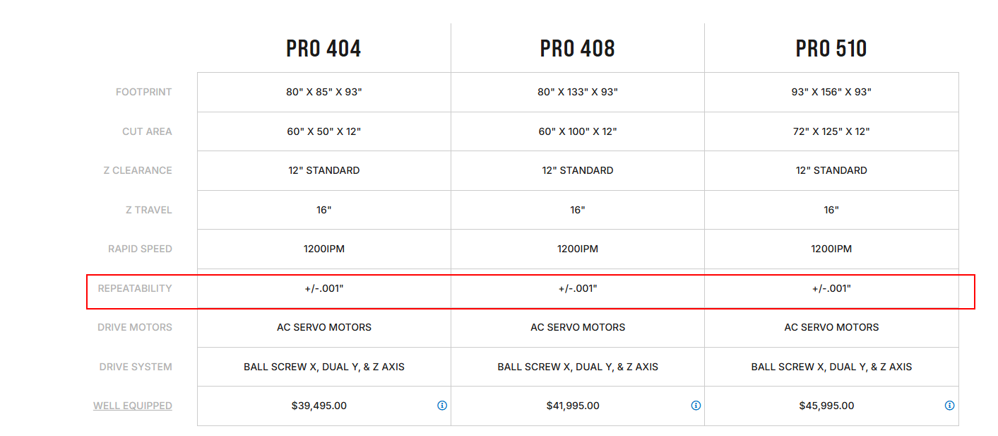

Even the next step up in Price even for DIY, PrintNC, only claims “The achieved accuracy with PrintNCs is in the range of 0.1- 0.03 mm.”, though this will depend on build quality too I presume
Avid at $25K says
ShopSabre at $40K+ says
At less than $1k, LR4 I’d say holds its own pretty well.

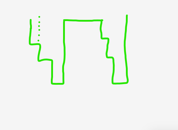

Why? Tramming is setting the router to your beam, it has nothing to do with your table. If you want better than 0.1mm you need to tram your router, surface your table, tram your router again, and surface your table again.
Think about that for a second. Imagine you are cutting out a square.
The dotted line is where the part should actually be.

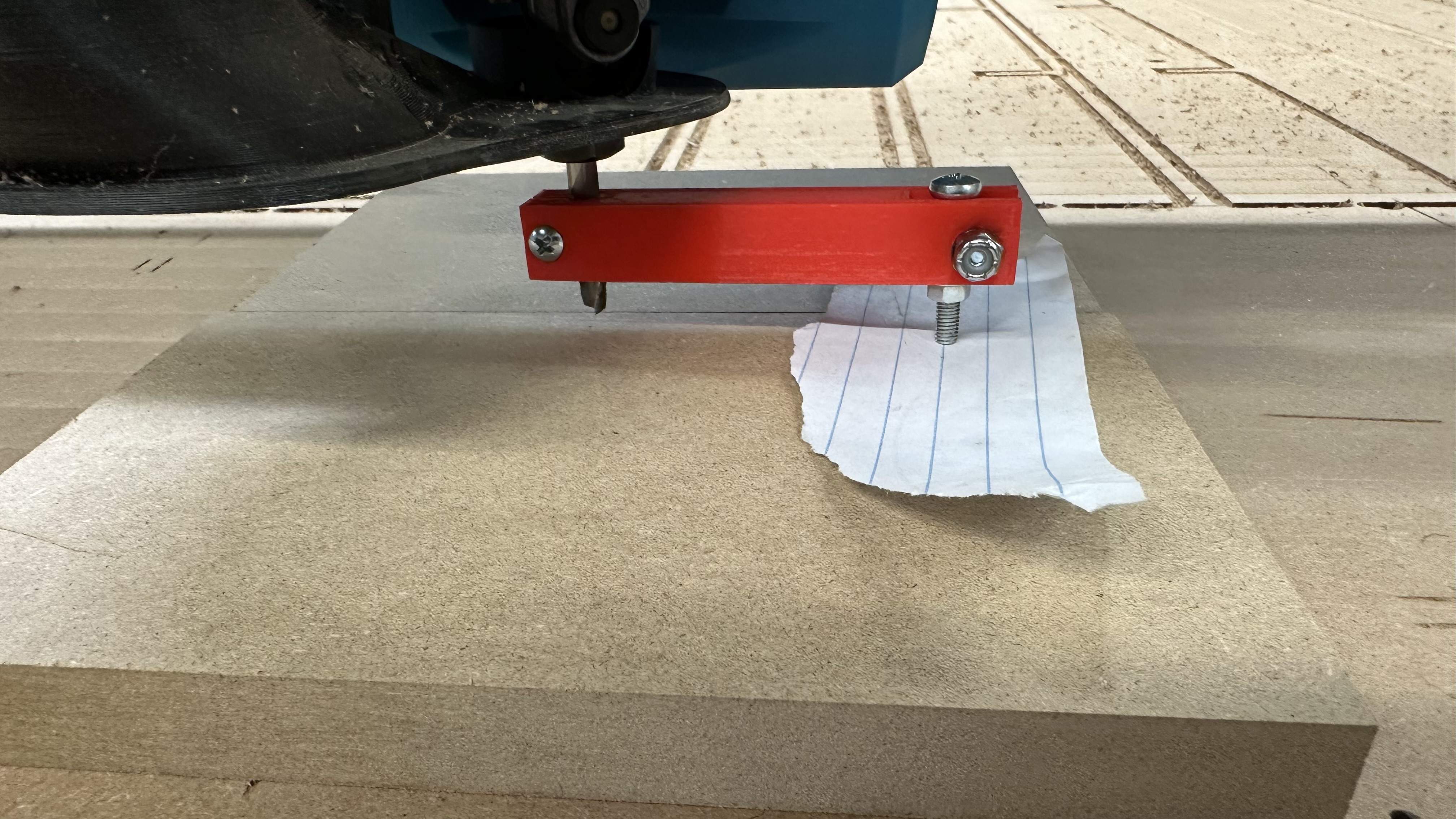

Ok. So I surfaced a section of my spoilboard, and measured the tram distance, using a piece of paper under the screw (kind of like I’d do with a 3D printer to calibrate the bed) and looking for where it grabs the paper.
X axis is maybe 0.1mm off from left to right, with the right side being just a touch lower.
Y axis is about 0.7mm higher in the back than the front (that is, the screw was .7mm above the surface in back compared to front). And that measurement is borne out by the horizontal lines from the surfacing run - my 1.5" surfacing bit was clearly cutting a tad deeper on the “front” side.
So I’ll add a shim at the back of the bottom mounting ring and surface again and re-check the tramming. Will report back either this evening or tomorrow.

After shimming the bottom bracket at the mounting holes with .015 worth of brass shims, my surfacing pass looks nearly perfect. I’ll double-check tram tomorrow and do a test cut to see how much better it is.
@vicious1 - thanks for the bit recommendations; I’ve ordered a few of each and look forward to trying them out.
Understood. I still recommend cutting by hand to see what your end mill is actually doing.
Your build is remarkably good in terms of all calibrations so something is extra funky here.
Re-checked the tramming today after shimming and re-surfacing last night.
I measure less than 0.2mm on Y from front to back and maybe 0.1mm on X from left to right. Don’t think it’s going to get any better than that.

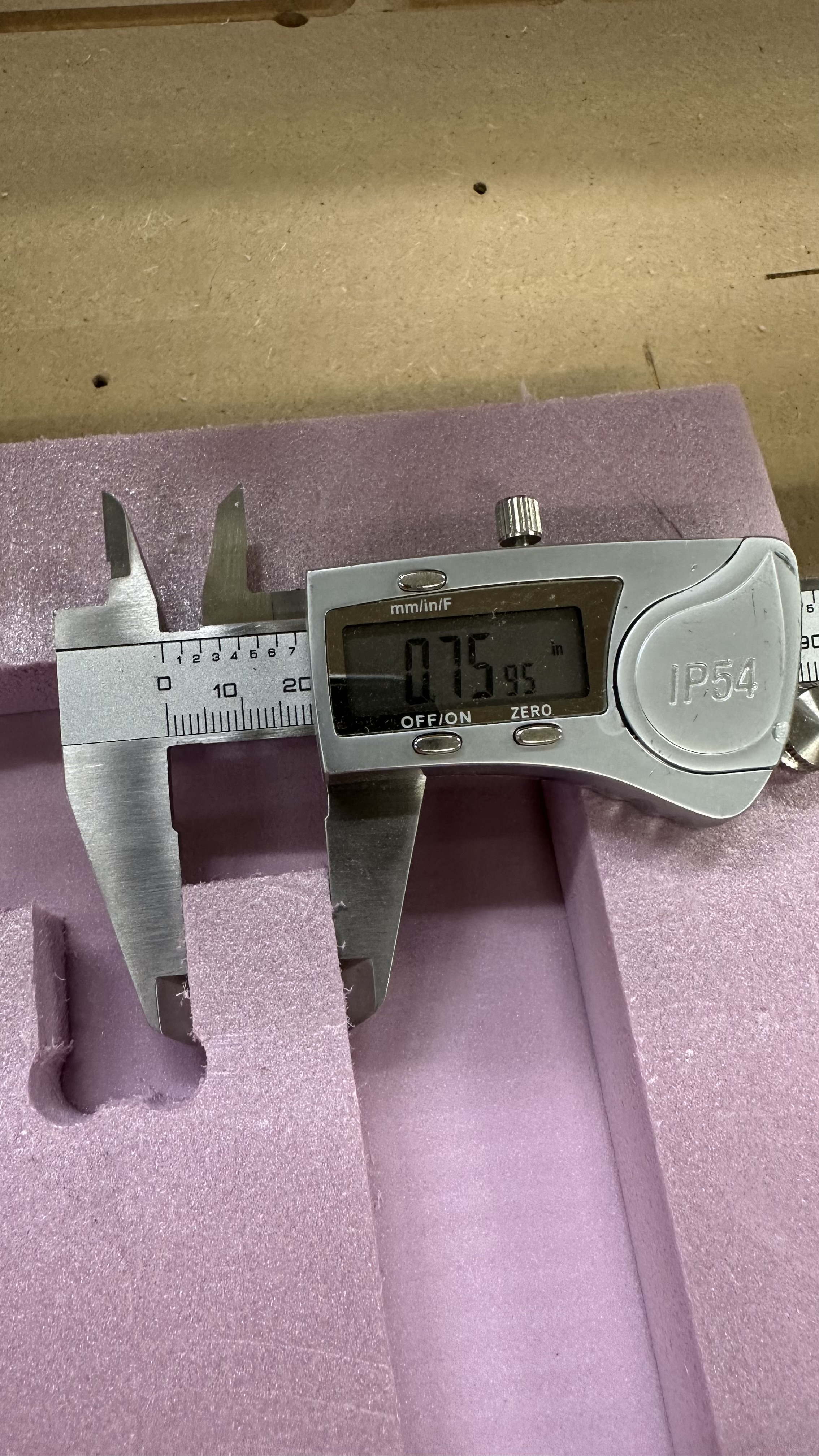

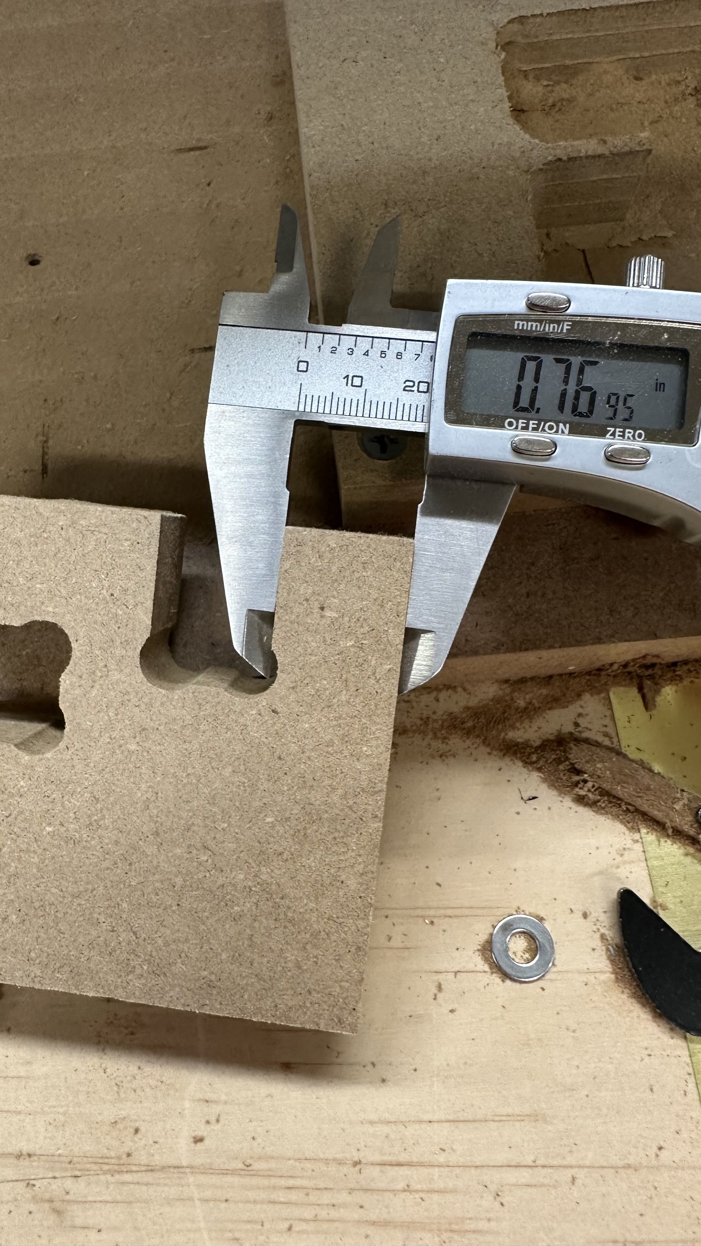

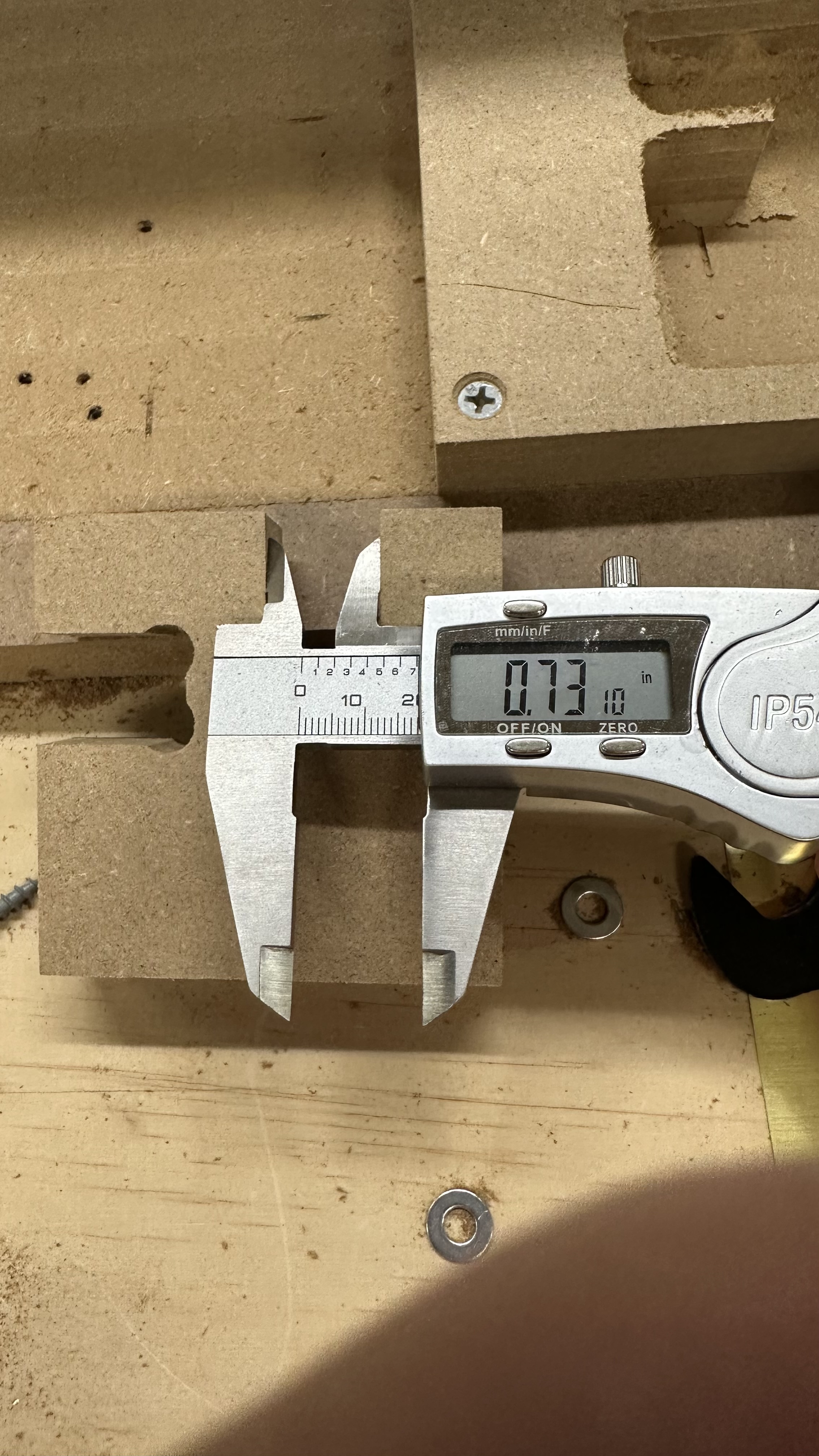

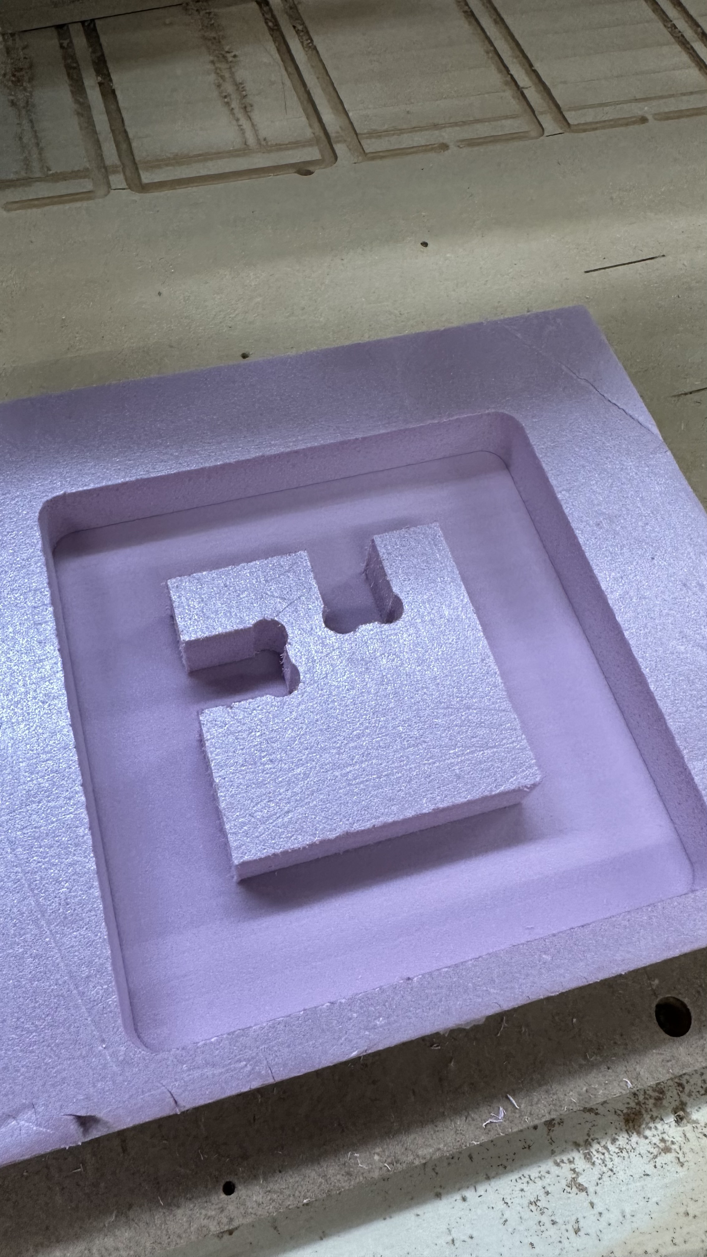

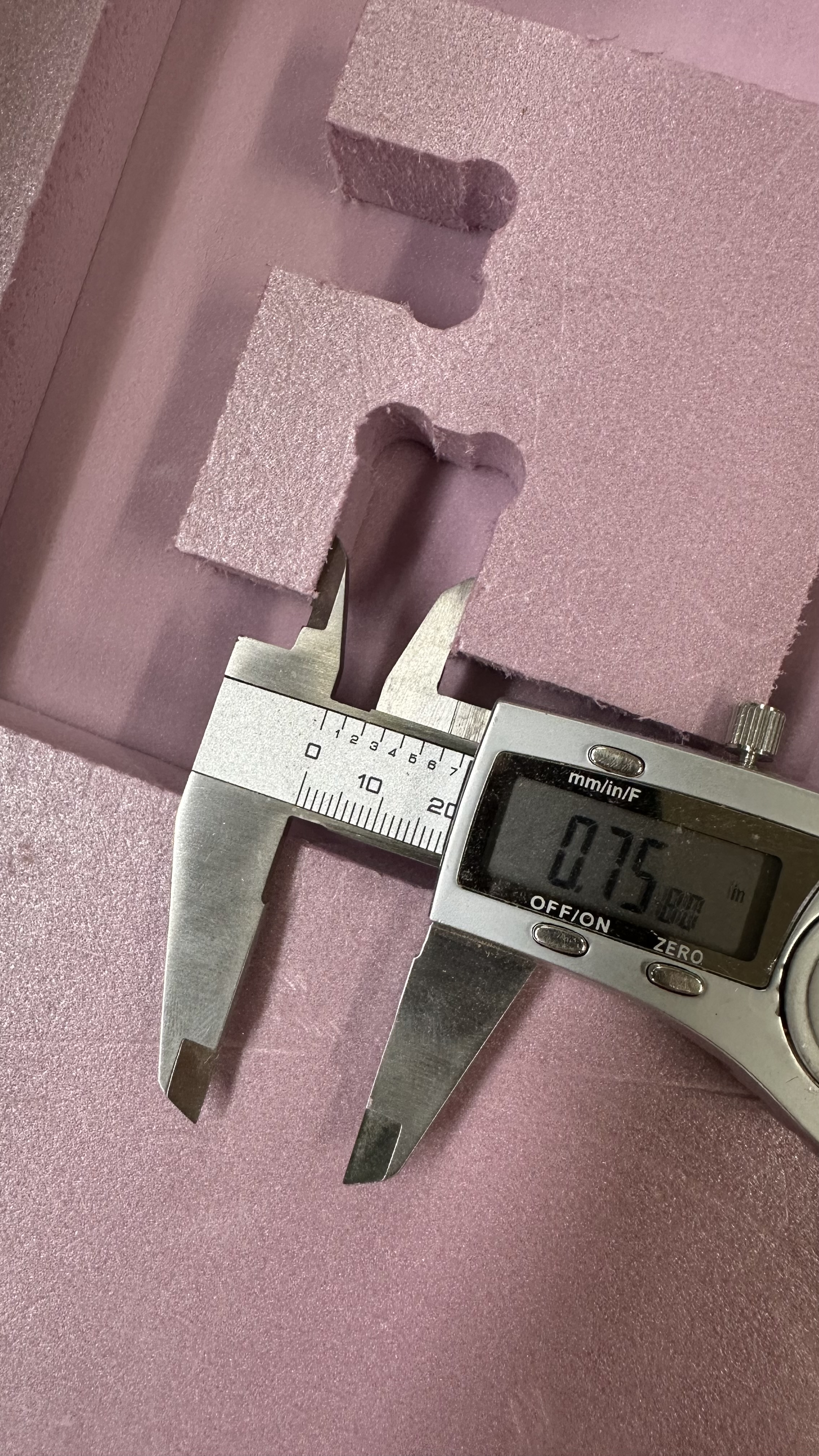

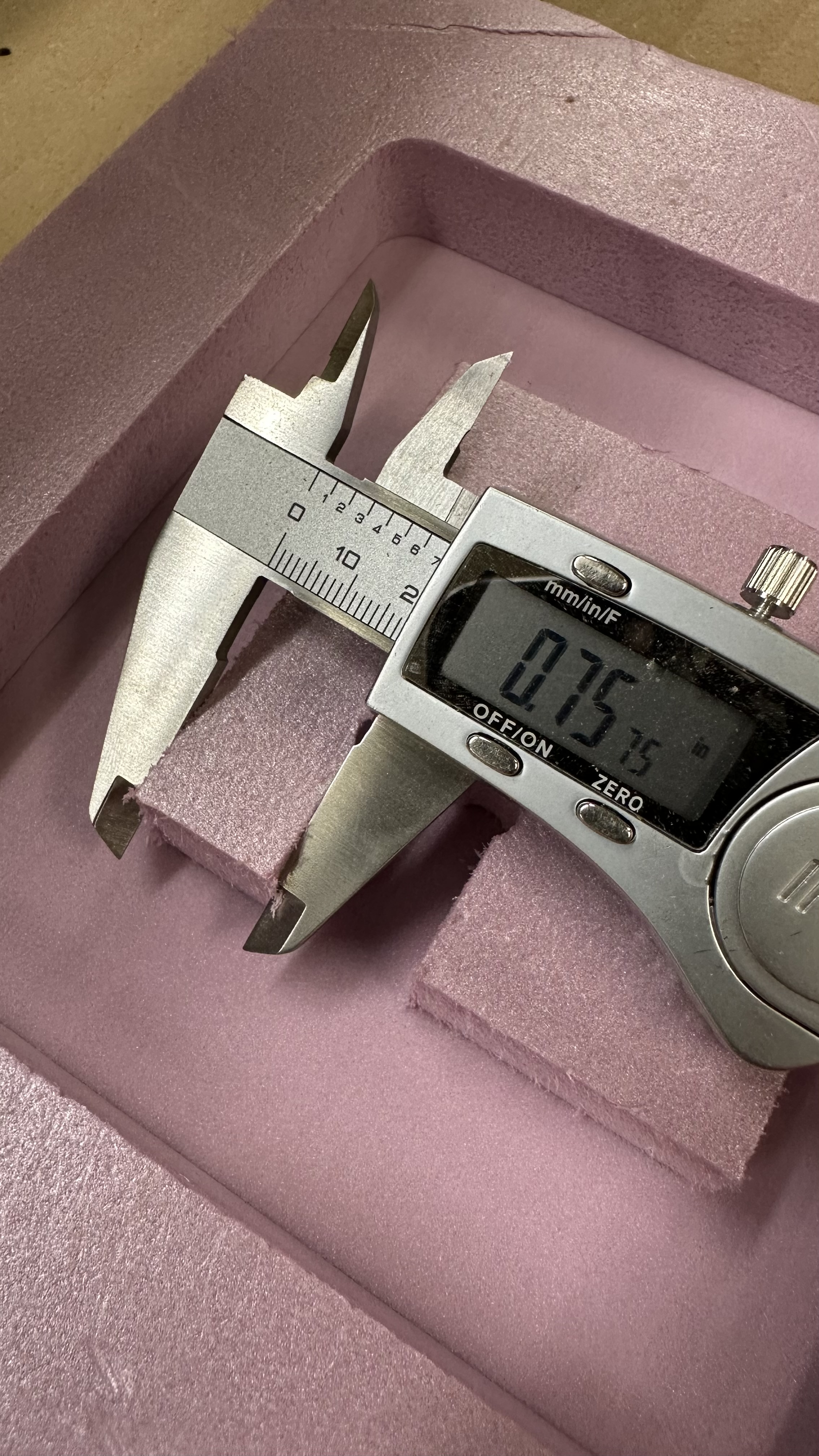

Ran another test cut using my drawing from above, in 3/4" MDF with a SPE Tools W03001 1/4" “O” flute up cut end mill. 60in/min feed rate, .25" depth of cut, 0.05" full-thickness (.75" ) finishing pass and about 14000 RPM.
No difference in final results: slot width was still about .730" and tab width was still about .77"

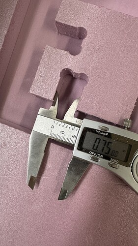

Then I ran another test in 1.5" extruded foam, same feeds and speeds but altered the program slightly to do an “island” cut around the test drawing. Same 0.05" finishing pass and all other parameters the same.
It’s hard to measure inside gaps in foam, but it looks like the cuts were very close to what they were supposed to be - a tad oversized, actually but again, it’s hard to measure foam…
So it seems to me that the issue at this point is all about flex/deflection when cutting. But I don’t have any ideas what else I can do to improve it. Shallower depth of cut? Slower feed rate? Different RPM? I feel like the parameters I’m using should be pretty reasonable - 60 in/min and .25" depth of cut
