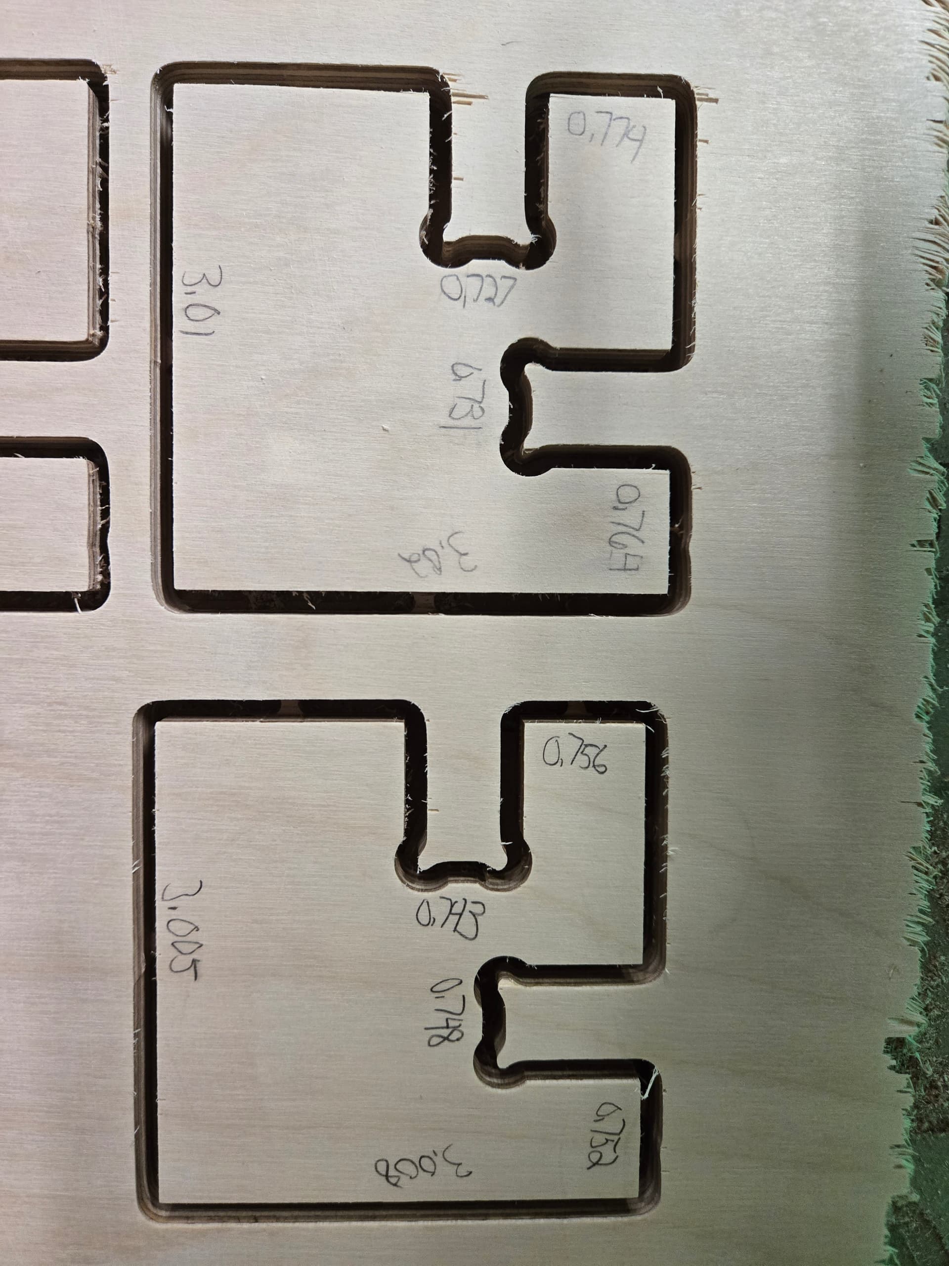

Can you try this test cut for me?

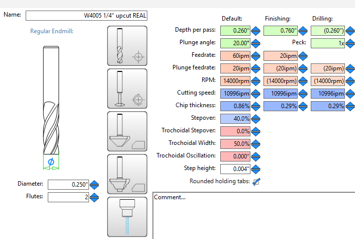

What depth of cut should I be using on the finishing pass? I’ve been using a “full depth” (i.e., 3/4") finishing but haven’t seen any guidance one way or the other.

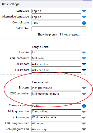

Check me on EstlCAM settings – I think I’ve got the right combination under general settings (I use Imperial units for display because… I’m a 'Merican…)
Settings for my endmill (with updated, slower rate for the finishing pass. Haven’t tested that yet.)

Even with imperial, I usually see inches per second. You are the first I have seen use inches per minute.
Change the normal feedrate from 60ipm down to around 35ipm.
Change your depth from 0.26" down to like 0.09"
You’ll probably need to take the speed on the router all the way down too.
Yes, full depth finishing.

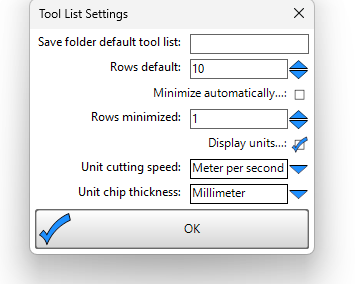

You can change your chip thickness display to something potentially more useful… I have no idea what chip thickness in percentage means when I’m looking at it.
After setting it to mm, I was able to get a better feel for starting points on feeds and speeds
Another test, 25 mm/s and .26" DOC, then .02" finishing at 10mm/s and .26" DOC, all with the router on the slowest speed setting. Might have improved the results by .010" at most, so I guess that’s a little bit of progress.
Well, even your foam cuts are not the right size. I suggest cutting a slot by hand to verify the end mill cutting width.
Seems like that gets you to exactly what your foam cuts are?

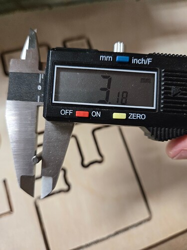

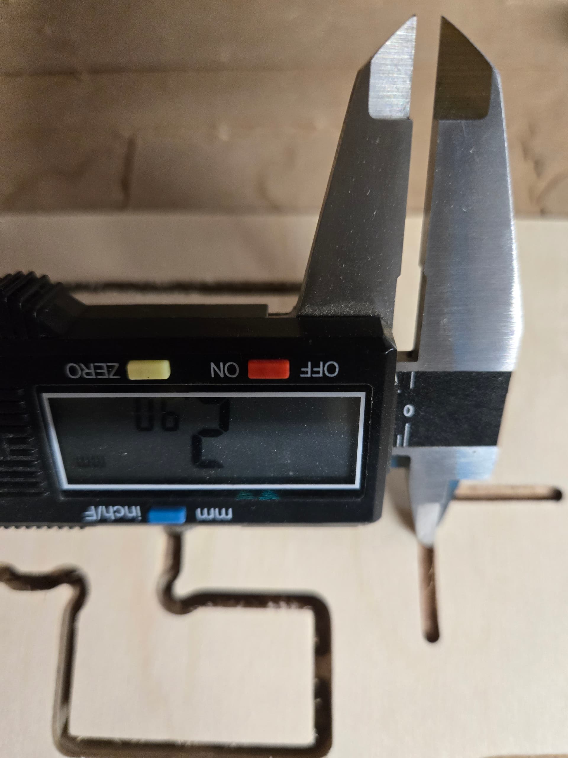

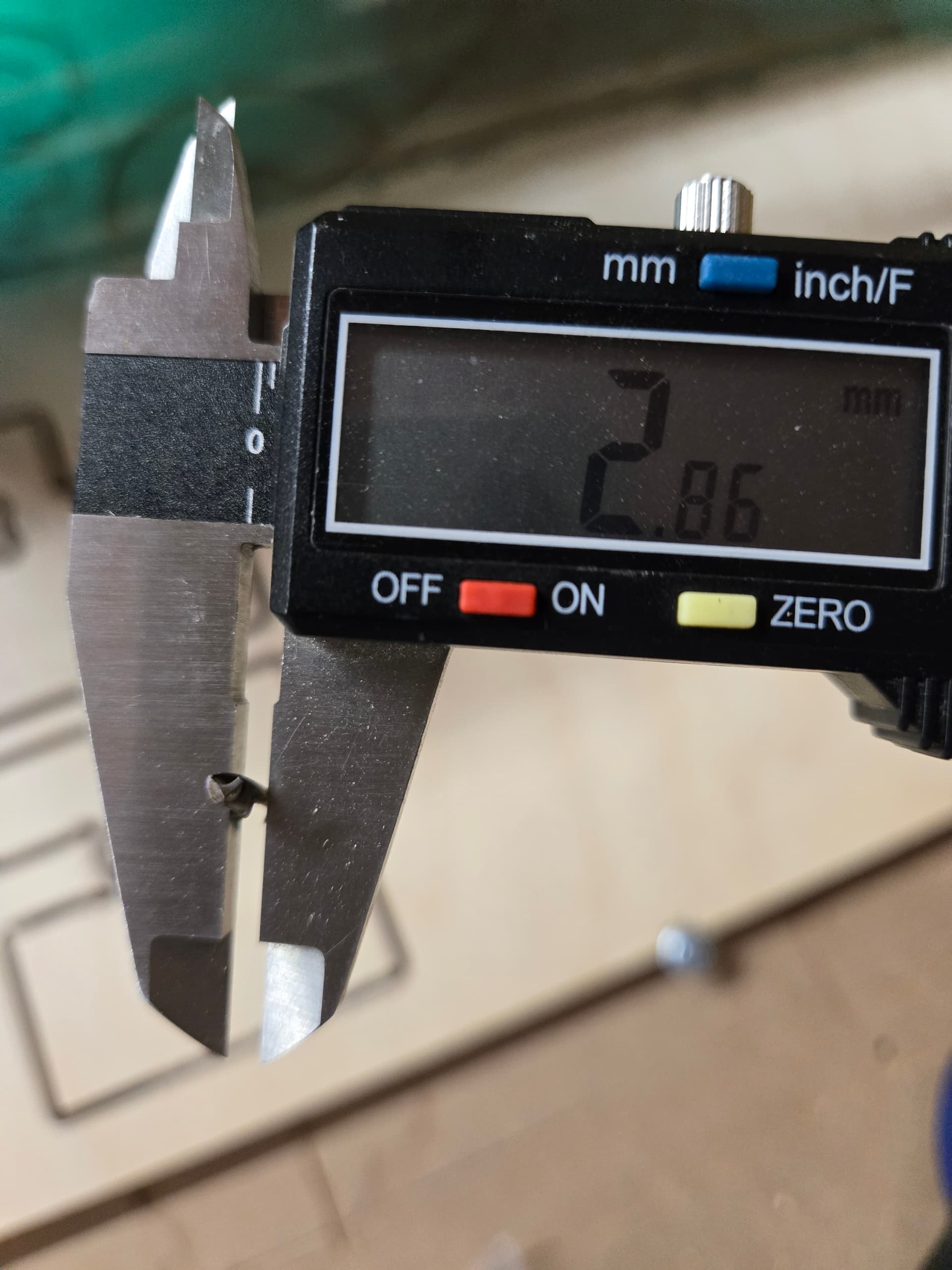

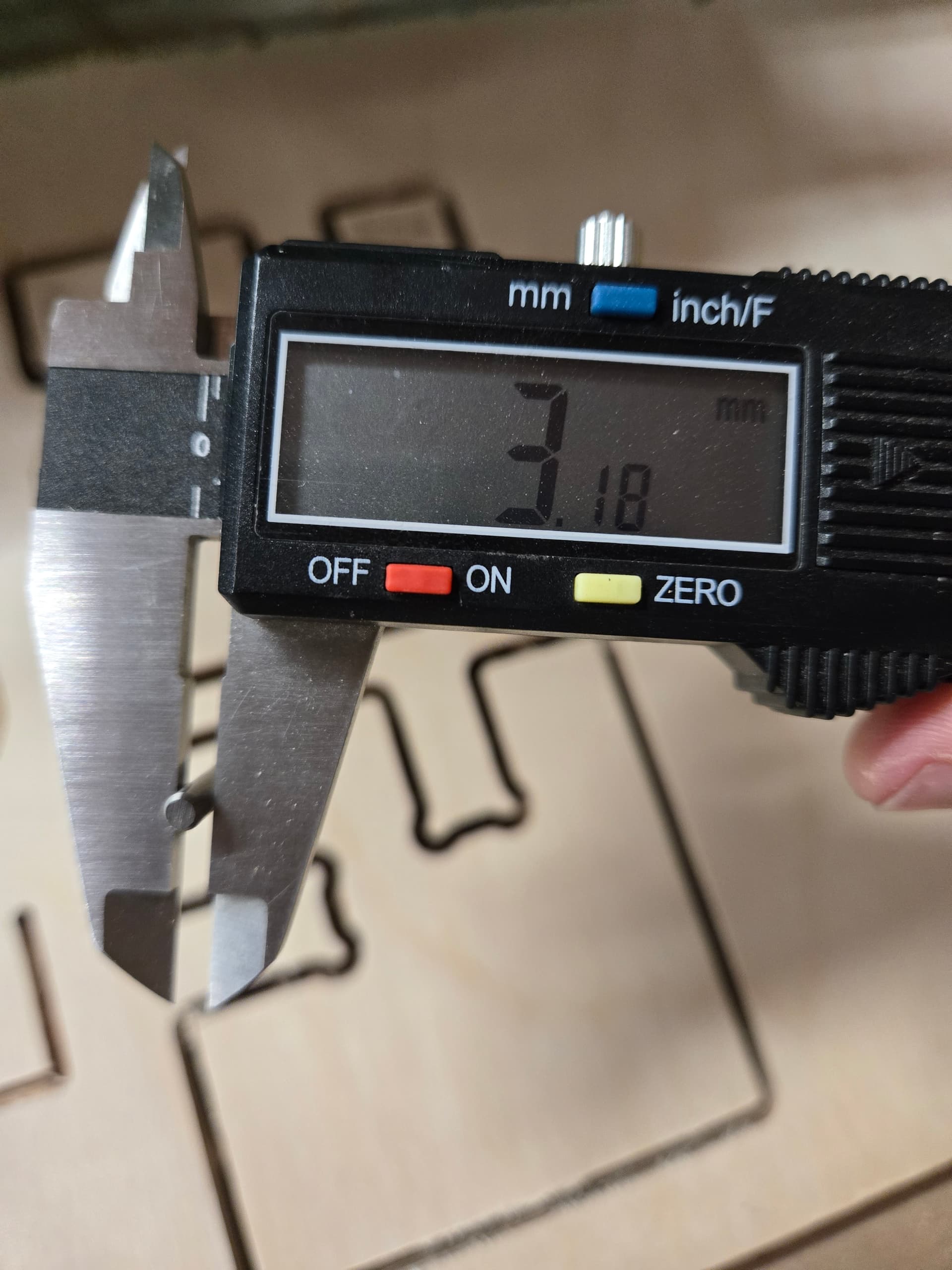

Alright, curiosity got the best of me so, I gave this test cut a try. Note I have an LR3. First round, I whoops and added the finishing allowance but forgot to set the tool. So, those numbers were bad since that means it adds that buffer but doesn’t remove it. Second round, I fixed that and saw very similar results to Marty. It’s an 1/8" bit and I had it in CAM as 3.18mm. This is the standard 1/8" bit from the V1 store. When I measured the shaft of the bit, it was 3.18mm. However, when I measured the cutting portion, it came out around 2.87mm. I then cut a slot and measured it. It was around 2.8 to 2.9 mm (a bit difficult to measure). So, I updated the CAM to treat the bit as 2.87. Then it came out much more accurately.
So, I didn’t lie about the bit size. A difference of 0.3mm matters. I measured it and the slot it cuts which is not the same as the shaft of the bit.
It makes sense in my head that the cutting width is smaller than the shaft of the bit. I’m assuming these bits are made out of a piece of 1/8" carbide rod. So, when they add the cutting part and sharpen it, it would be smaller than the shaft.

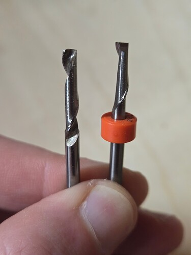

Well shoot, makes sense but dang. Can you show me what bit it is. I had some off the shelf ones then 6 months back or so I started getting them custom made. I really hope the custom ones are not that far off.
The one without the collar is the one I used. It’s older than the one with the collar which it looks like I bought about a year ago. I never looked close enough to notice they were different.

I always naively assumed everyone does like I do- which, as Ryan requested REPEATEDLY in this thread, is to cut a shallow slot by hand and measure it.

I still say it’s better to measure the resulting slot (cut) than the bit as it’s the cutting results that matter to the user, and is an explanation for why “misconfiguring” the CAM tool size can produce quite good results.

I agree that measuring the bit is tricky. I tried to measure the widest part but depending on bit design, that might not work.
I just cut the slot to measure by jogging. It wasn’t very deep. That’s a bit tricky to measure too. You’re pushing the “sharp” part of the calipers into soft wood making it pretty easy to push too hard.
