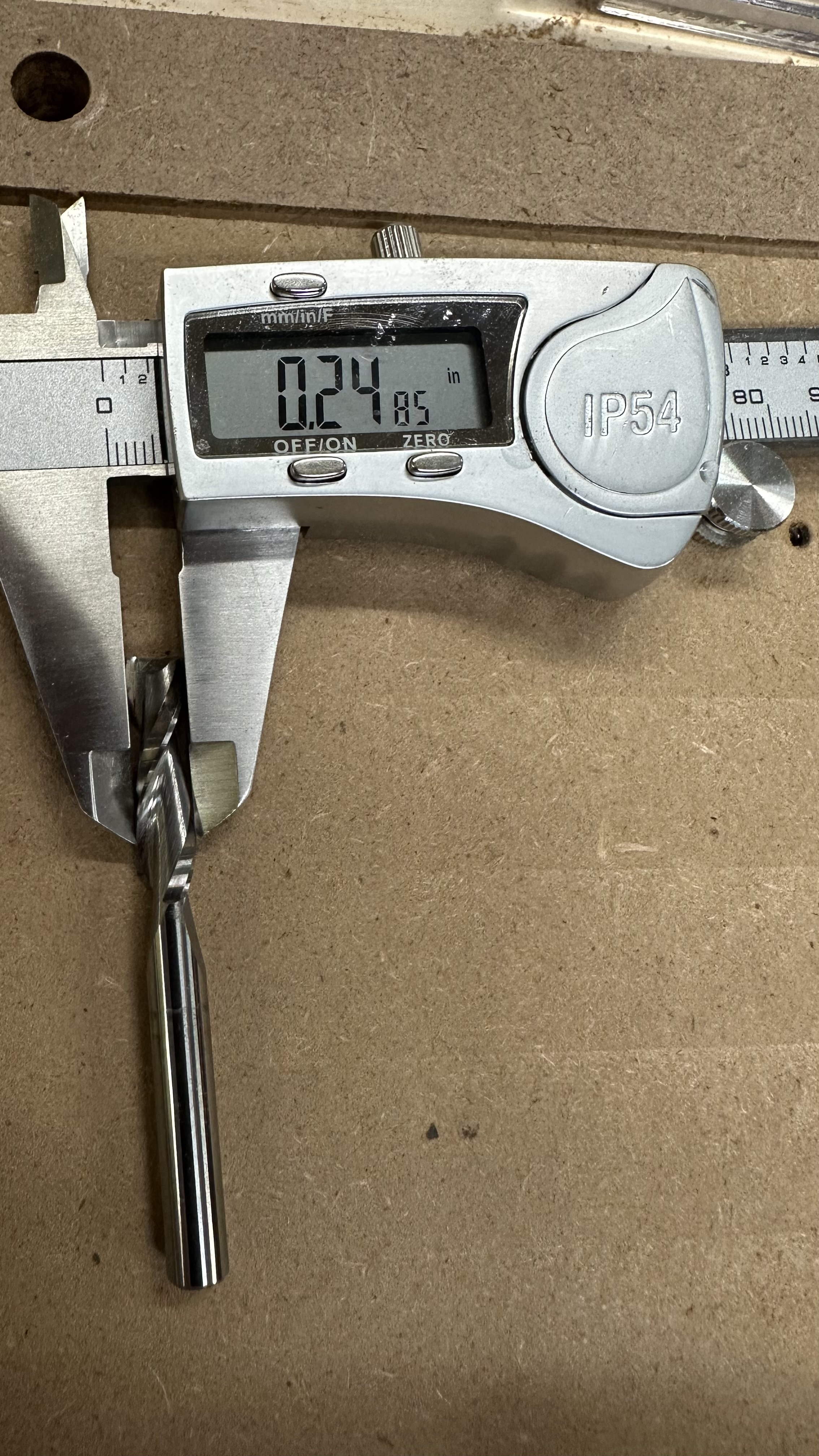

Ok. SPE Tools W04005 1/4” 2-flute up cut bit.
Measuring is hard. Taking pictures of your measurements is even harder.
Bit:

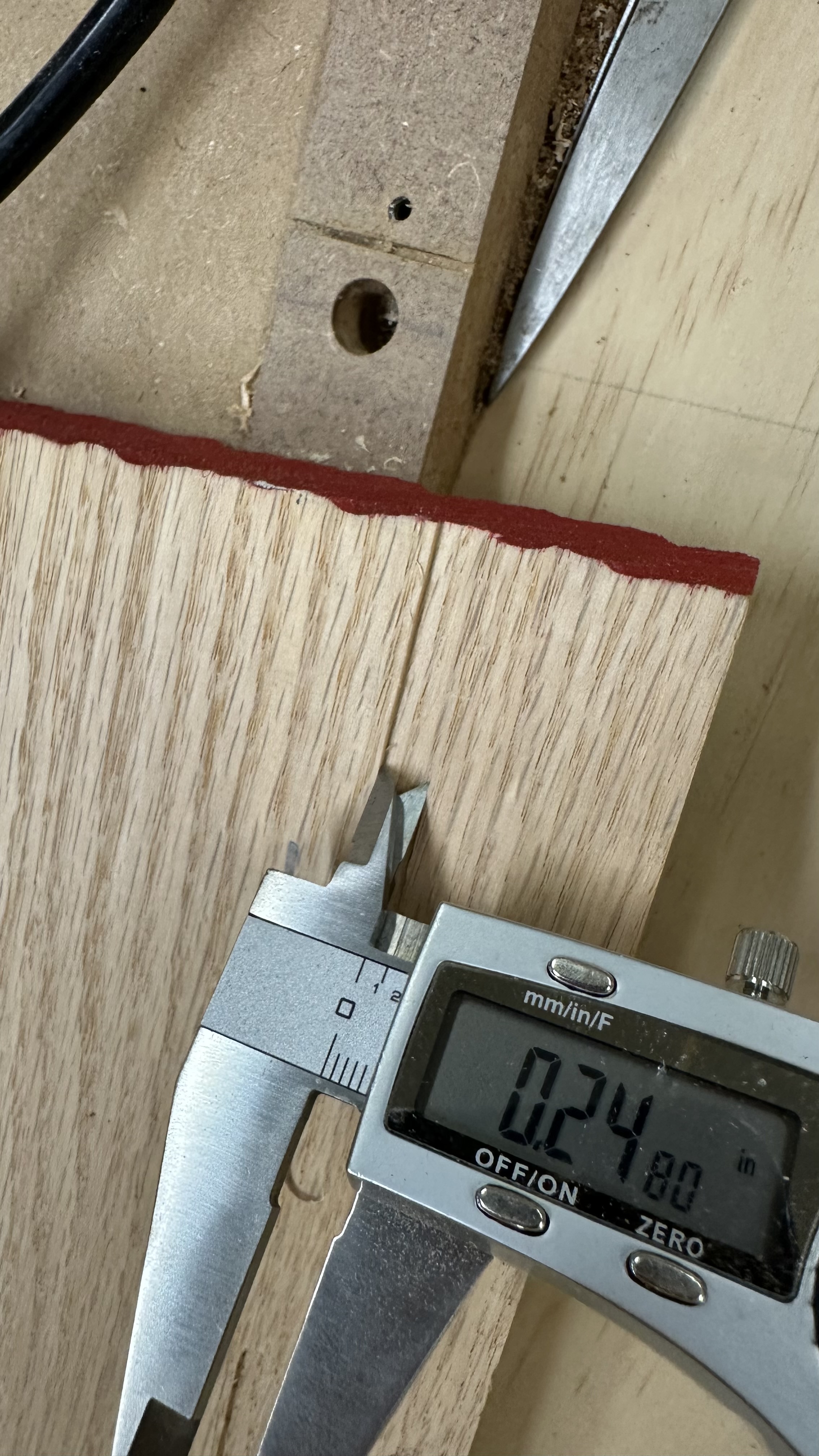

Cut results: about 2mm deep in red oak, using the straight edge guide (carbide 3d router in a Makita base), speed at about 2 on the dial.
Climb cut:
Conventional cut:
So the bit may be off by a few thousandths, but not enough to explain the results I’m getting.
You lost me, could you please explain the difference between a climb cut and a conventional cut in a single pass slot?
I assume he means cutting with the spin of the end mill or against the spin
I wonder what would happen if you cut the slot in your MDF instead of oak. Maybe the MDF is cutting differently
Maybe it has to do with which side of the router was against a fence? It should be conventional for this test. The bit should pull into the fence so there is less wobble.
I’m at a bit of a loss otherwise.
More or less. One cut was left to right and the other was right to left. Fence in the same side both times. No idea why the resulting slot is different width.
But the bottom line is that the endmill diameter isn’t the smoking gun we were looking for.
