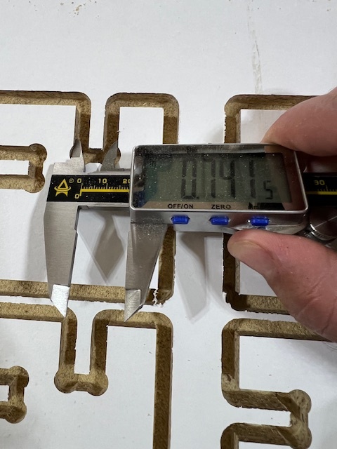

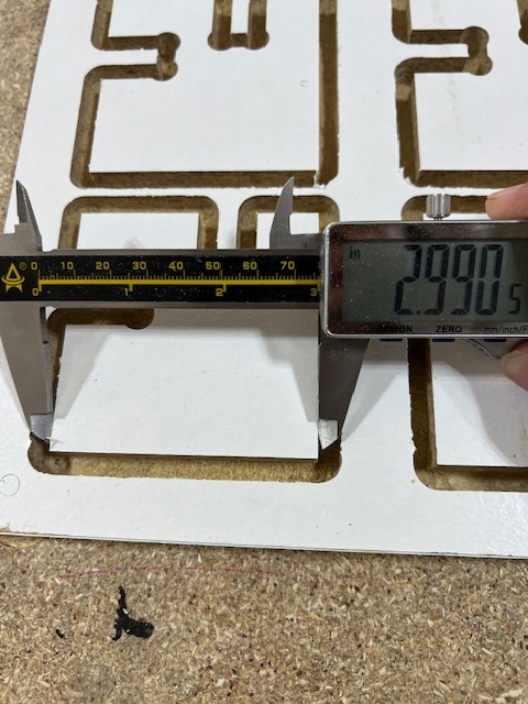

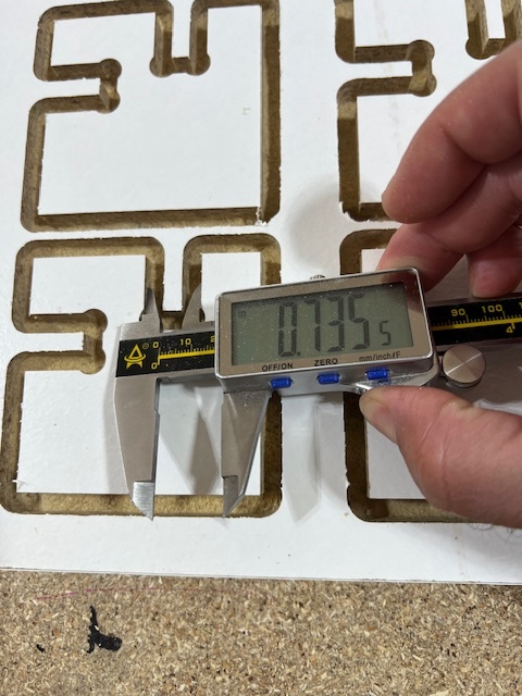

Can you try this test cut for me?
I just changed Estlcam to ask what it imports, now it works.
Camera angles are shitty and my measuring thingy is not the best, so it might still be off.
Settings:
Also: my last inlay in hardwood failed spectacularly, it didn’t fit at all. MDF is pretty easy to machine.
Great job displaying that your Vorshubgeschwindigkeit and Eintauchgeschwindigkeit produce accurate results!!!
Results better than the measuring tools can measure… A suitably German result. :wink:
Wow, I apparently need to figure out how to tap into my German ancestry.

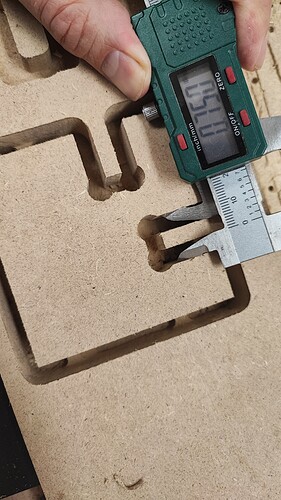

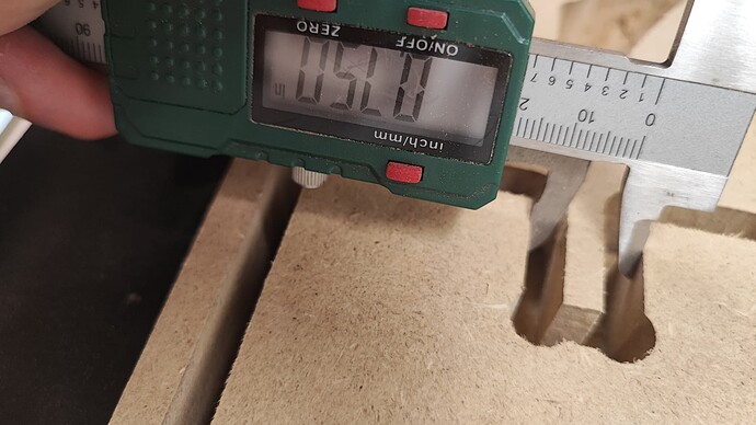

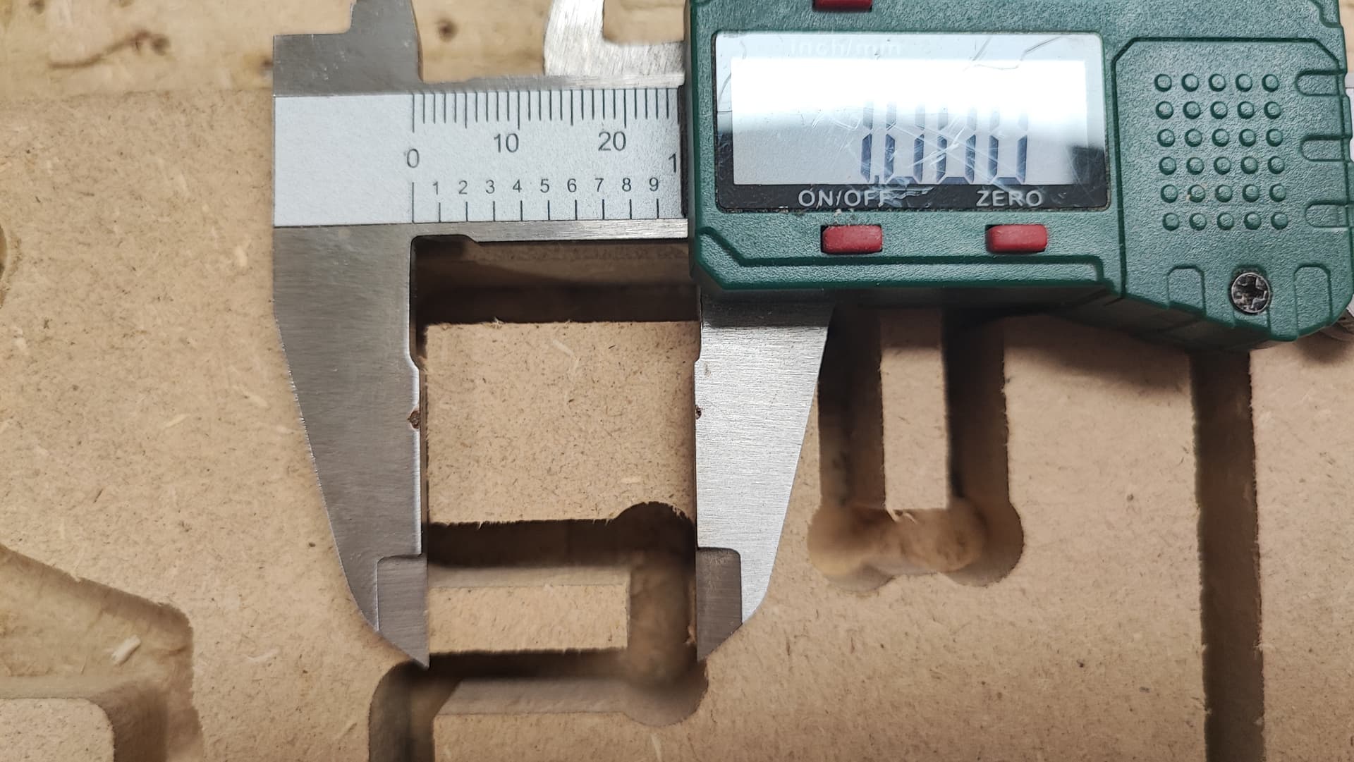

My issues must be something different, here is my slot :-1:
and here is my outside, :+1:
If I attempt to get the slot closer by dropping to .24in instead of .25in, closer but :-1:
My outside then shrinks, :-1:
Any ideas from the accuracy geniuses here? Fixed my tram by shimming the router, and resurfaced.
My 1/16" seems fine, the 1/4" seems fine. Both 1/8" end mills cut a 3mm slot though import and Kyocera…

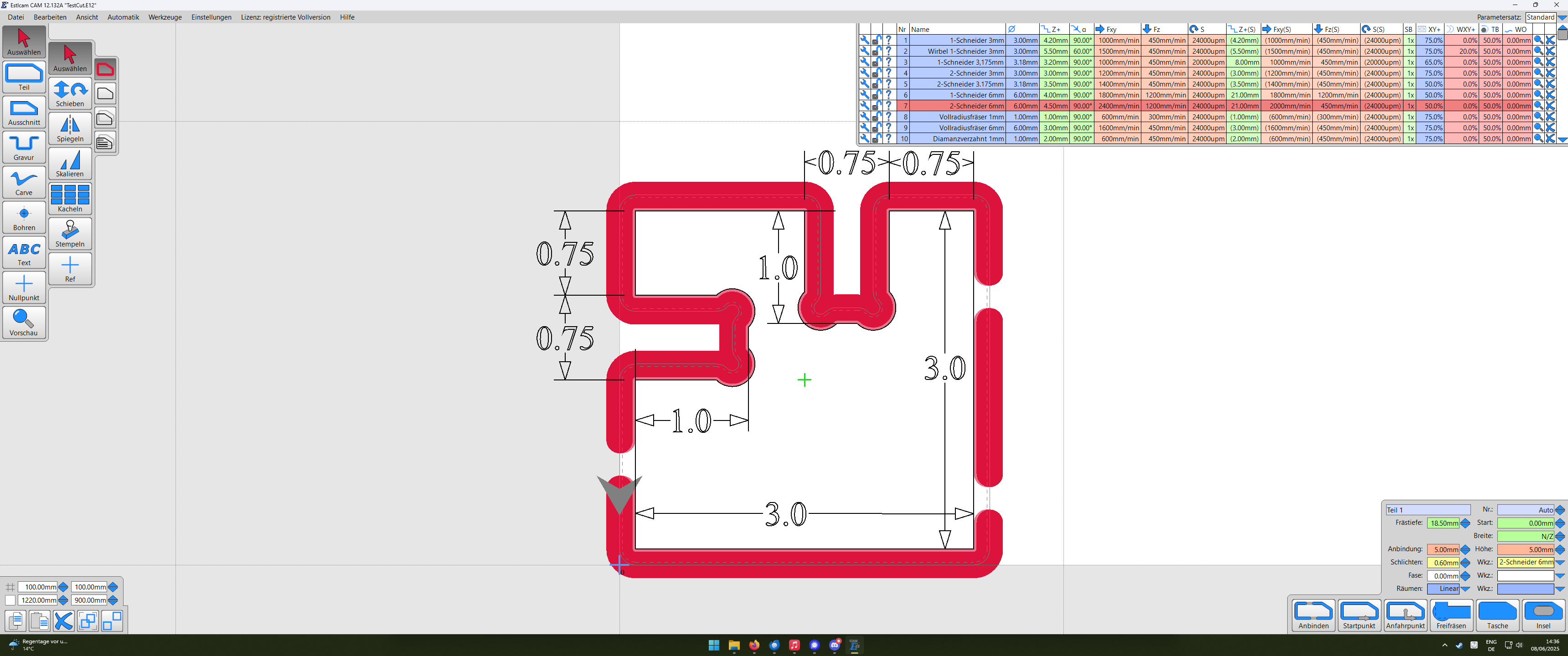

The DXF in this thread is a very useful test cut.
Maybe we need a progression of tests or even simple projects ramping up the difficulty.

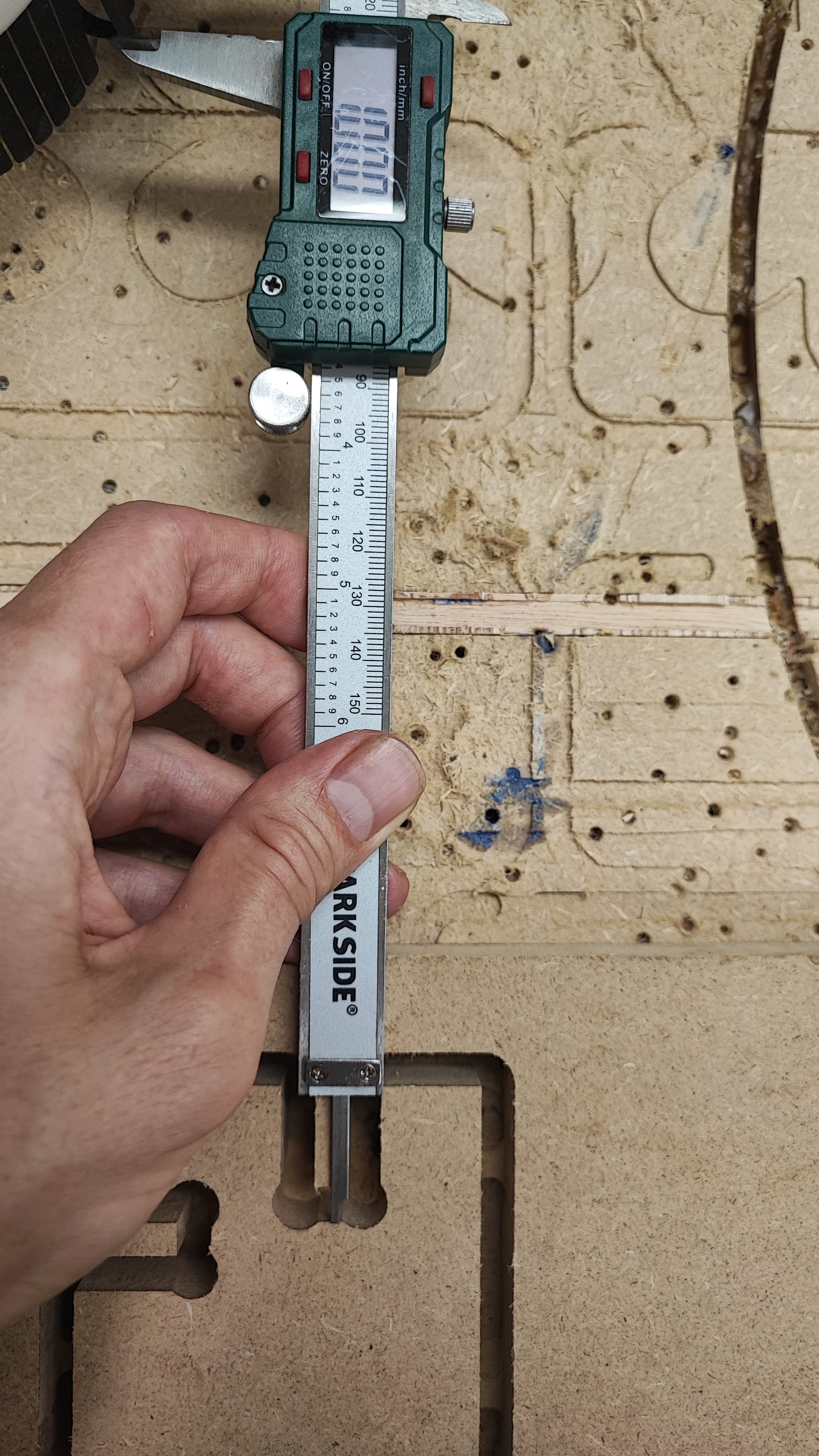

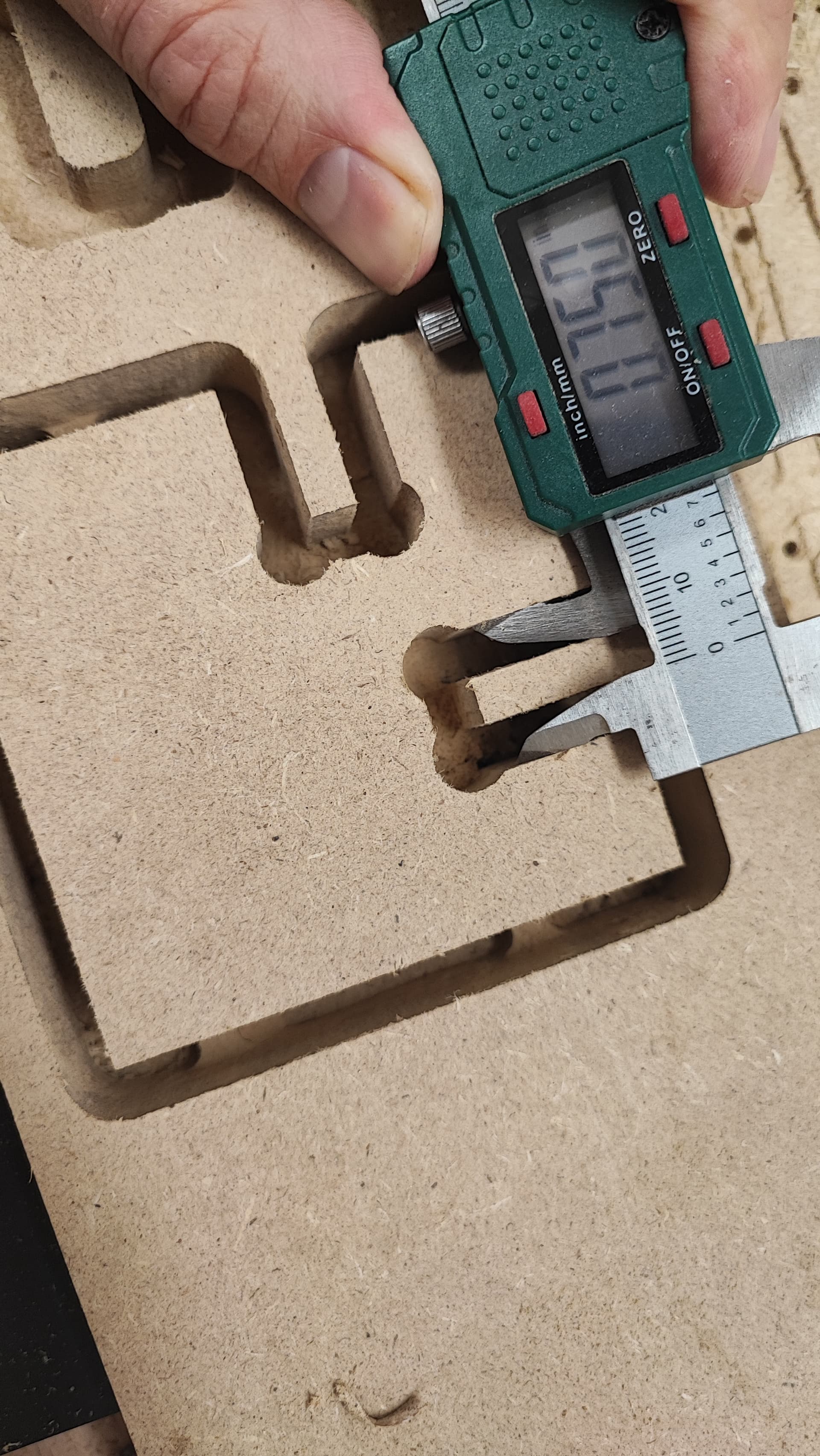

Yeah I am not sure how to make that progression just yet. It was pretty hard to measure the hand made slots. 100% have to use a straight edge (if doing it by hand). I had a collet dirty enough that it was spinning and extra 0.2mm, really throwing me off when I was getting 3.4mm slots at first.
Tenths of a millimeter are tiny.

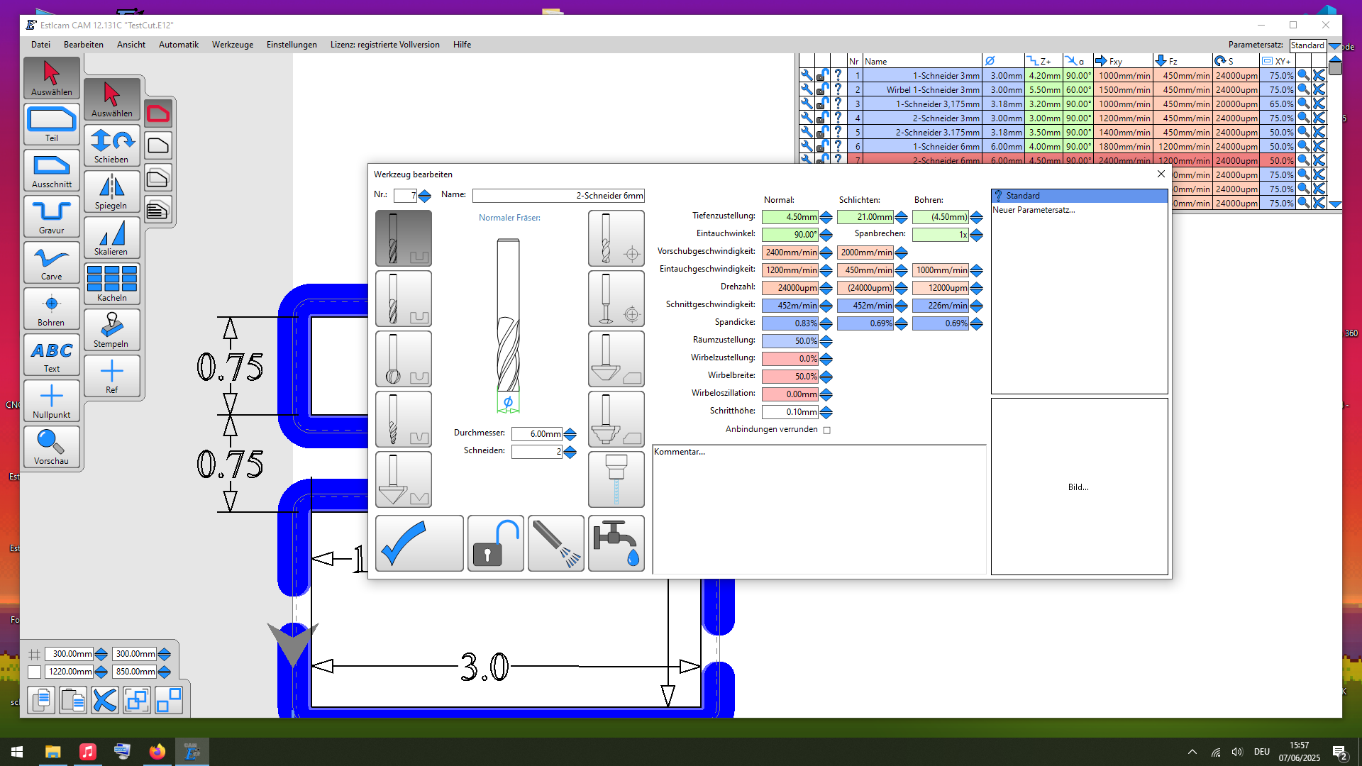

Here are my settings, I do a 0.6mm finishing pass:
Also, to be fair, I used a brand new endmill. It was one of Sorotec’s in-house brand that are cheaper than the other ones, but still cost 22€ a pop and are manufactured in Germany, so I am absolutely sure it is 6mm wide.

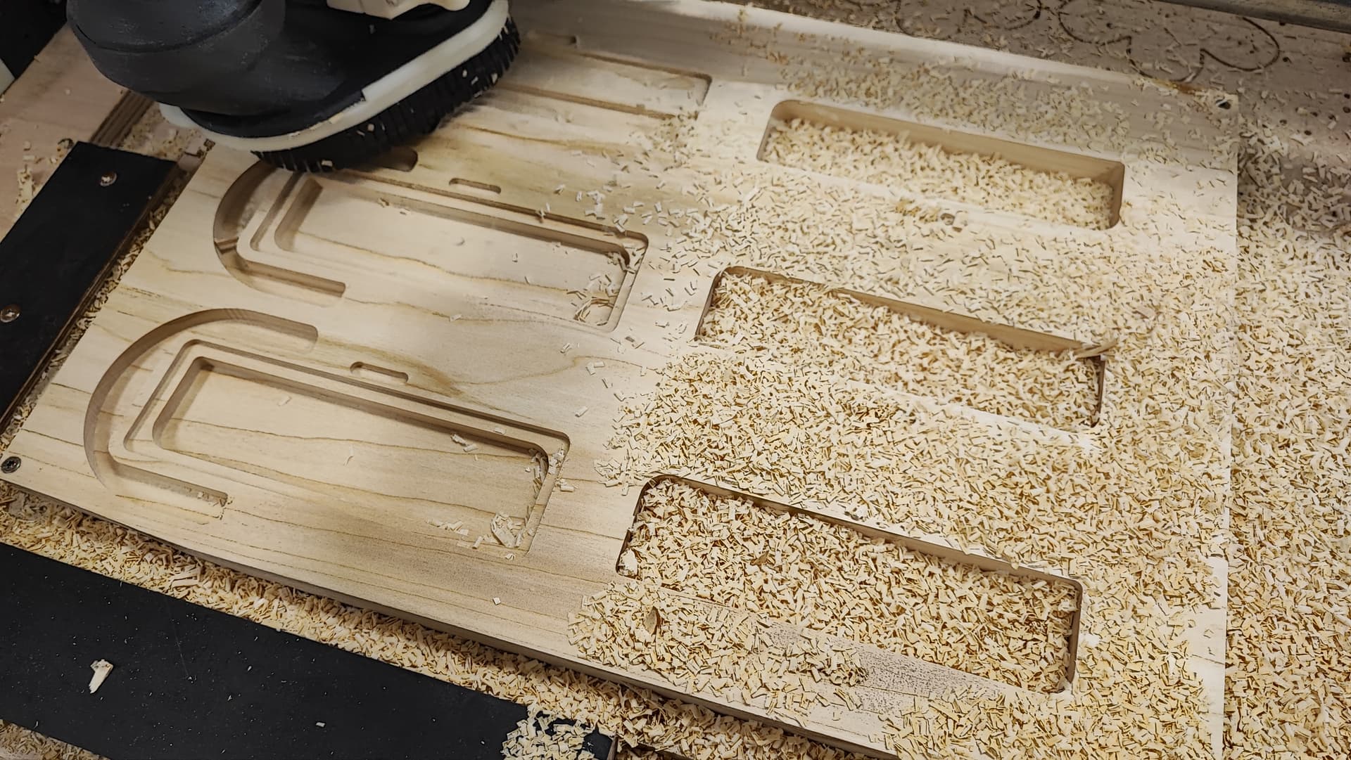

I usually go 24k RPM and used to go 3000mm/min with it and 6mm deep in hardwood, but after the bitter realization that Purple Heart and Satinwood are much too hard for that, I dialed it down to 2400mm/min and 4.5mm DOC. So I basically just threw in my standard settings for hardwood. You can see looking at the chips that the RPM are completely fine with that speed. :stuck_out_tongue:
I also have a closed loop stepper on X, since that’s the only one that is doing the work on its own… :smiley:
Your are cheatin, that single motor outperforms both y axis motors :sweat_smile:
Neat. What torque/ oz motor, and current?
It’s the same like the one Ryan sells. But closed loop. I haven’t had it skip steps, if it did, Estlcam would immediately stop the program. The stepper is connected to an alarm that triggers a pause in the program. I had Y wander in Purple Heart, the X never did… :stuck_out_tongue:

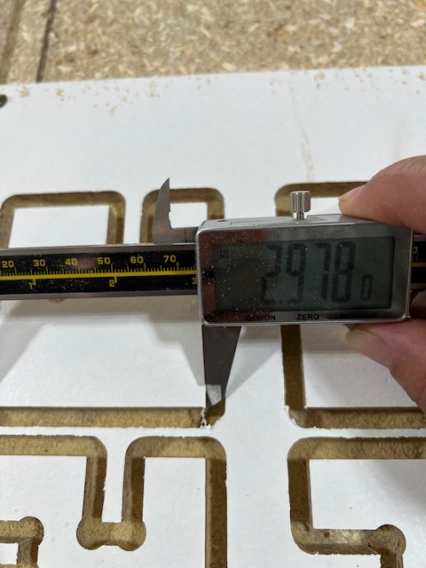

I tired a metric version of this test over the weekend and it helped me tune in a little more accuracy. My 4mm 1F upcut bit measures 4.00mm in diameter when checked with calipers but by calling it “3.90mm” in ESTLcam I got the slots virtually spot on. Seems to me +/- 0.1mm is about what’s possible on my machine with a 2.5m x 1.22m cutting area and I am happy with that. Other cutting details were:
Test cut in 16mm MDF, 4.25mm DOC at 25mm/s with a finishing pass of 0.6mm at 35mm/s.
