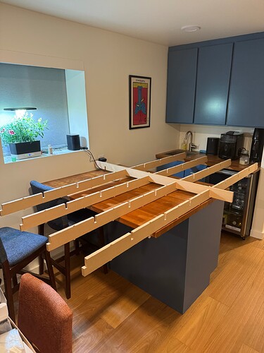

Test parts are cut and look pretty sweet. On to the Y spars!

So now I have a bunch of Y-struts cut. I cut an X-strut to make sure everything fit together as expected:
The table is coming together!
