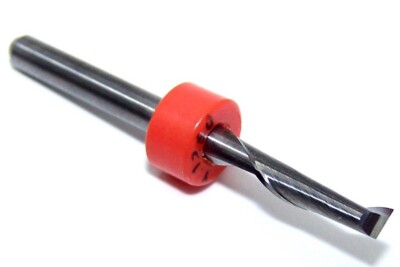

While I didn’t do a ton of spindle work on my old machine my go to cutter has been these single flue kyocera bits from “drillman1” on ebay (now oliver tool company):
They’re also available in 5 packs. For the price they’re a great bit for smaller work and do great on acrylic and polycarbonate (which is what prompted me to try them) as well as wood.
They have other kyocera bits in other sizes and flute counts as well at great prices, shipping is usually really quick to and gets to me in AZ in just a few days.
