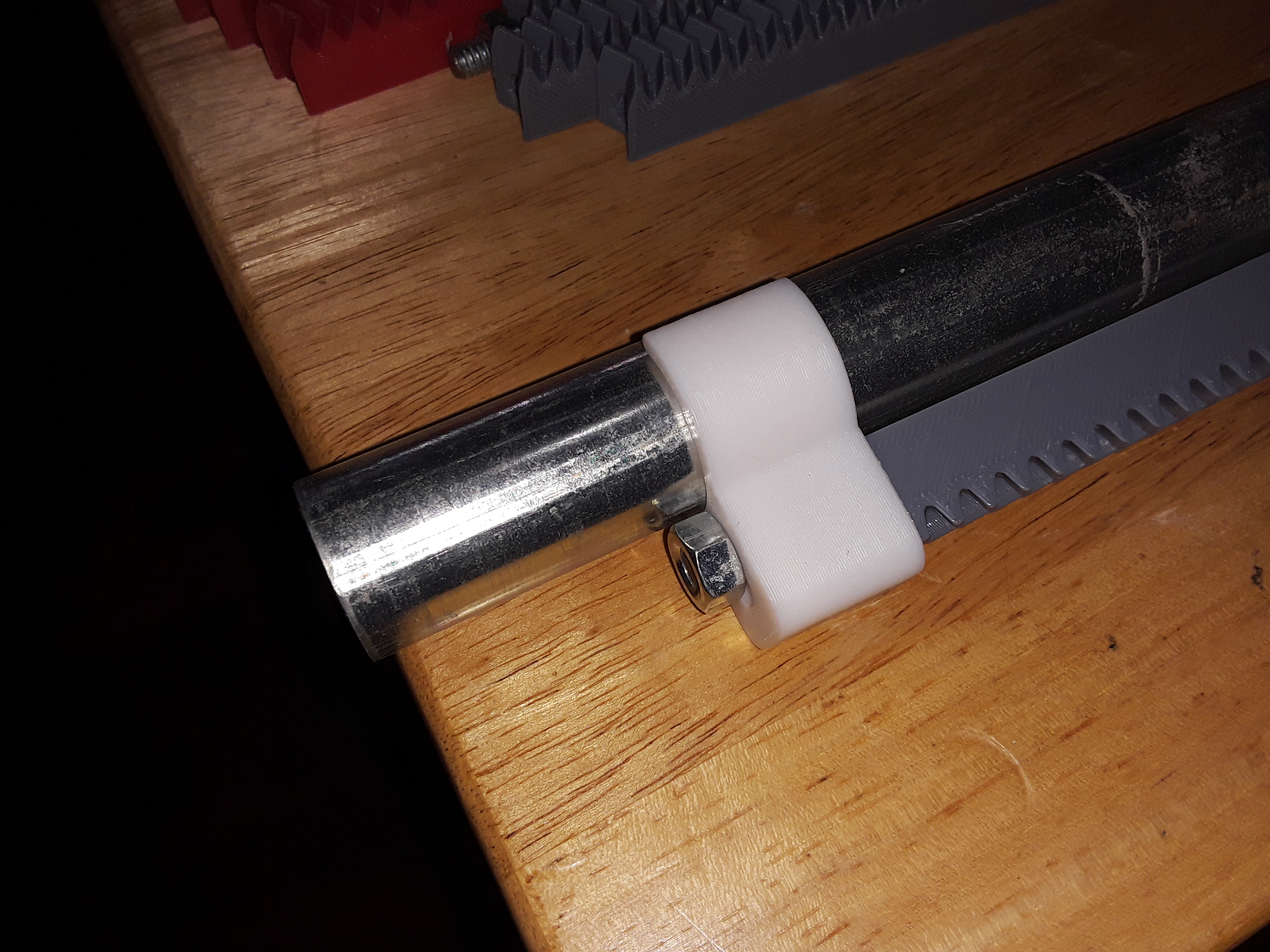

Getting closer to having a complete axis built…
The rack sections are printed with a 1/4" hole through the center… which allows multiple sections to be put on a threaded rod to build up whatever length is needed. Onshape screenshot and photos of rack detail…

A complete axis? Actual travel shown here is 360mm…
I’ve tried to honor the outer rail to gantry rail distance and make the roller assembly a drop-in replacement for the MPCNC roller… thinking that if I ever feel brave and frisky enough I could just swap out one axis on either of my two working MPCNC’s, “Joe” and “Henry”. But being commemorative and calibrated, I’m really not leaning that way right now.
