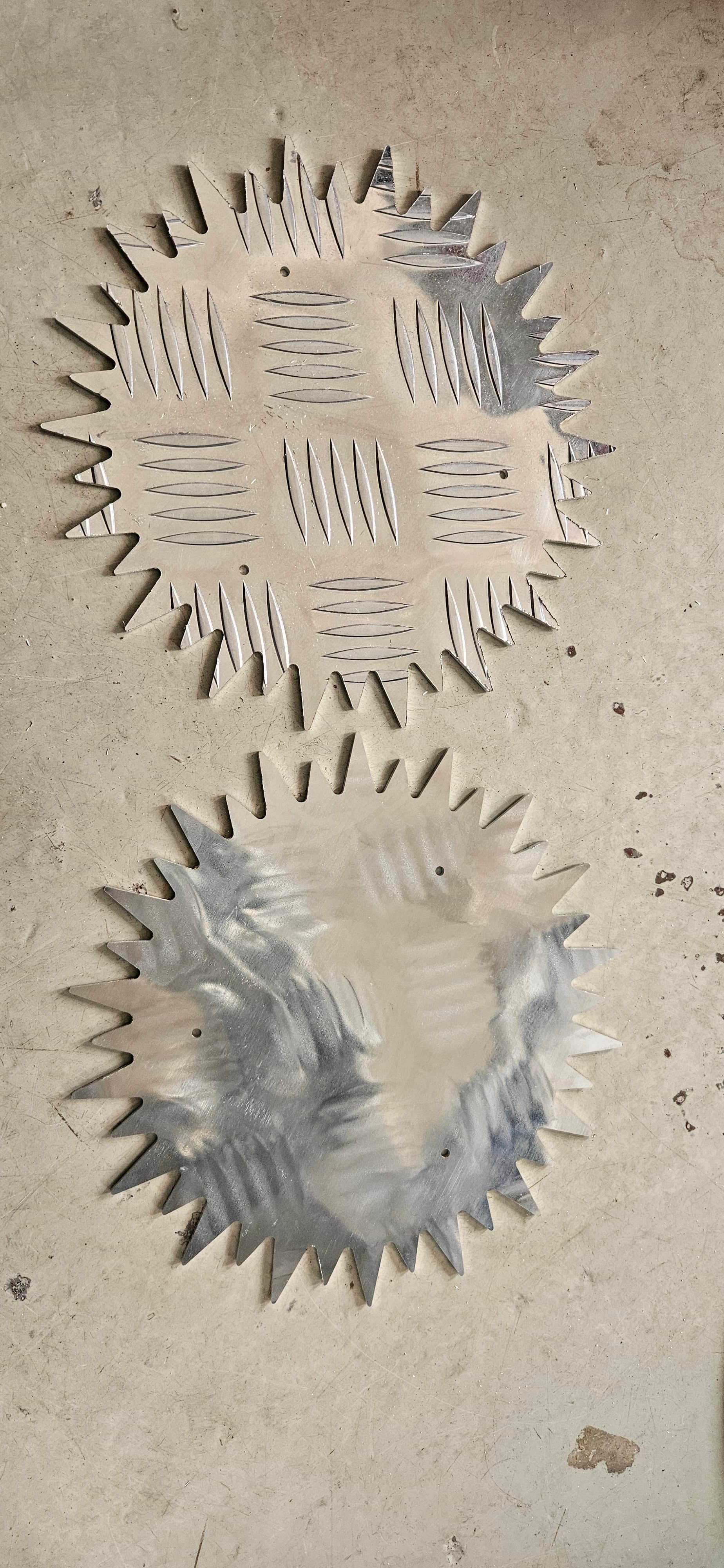

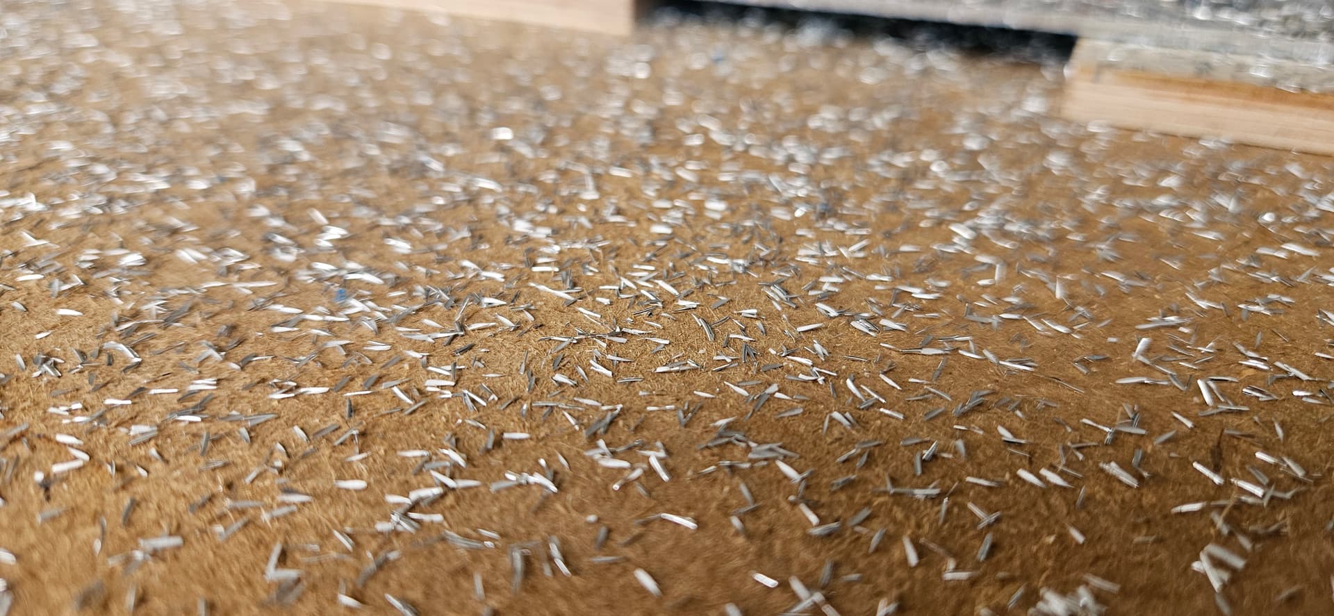

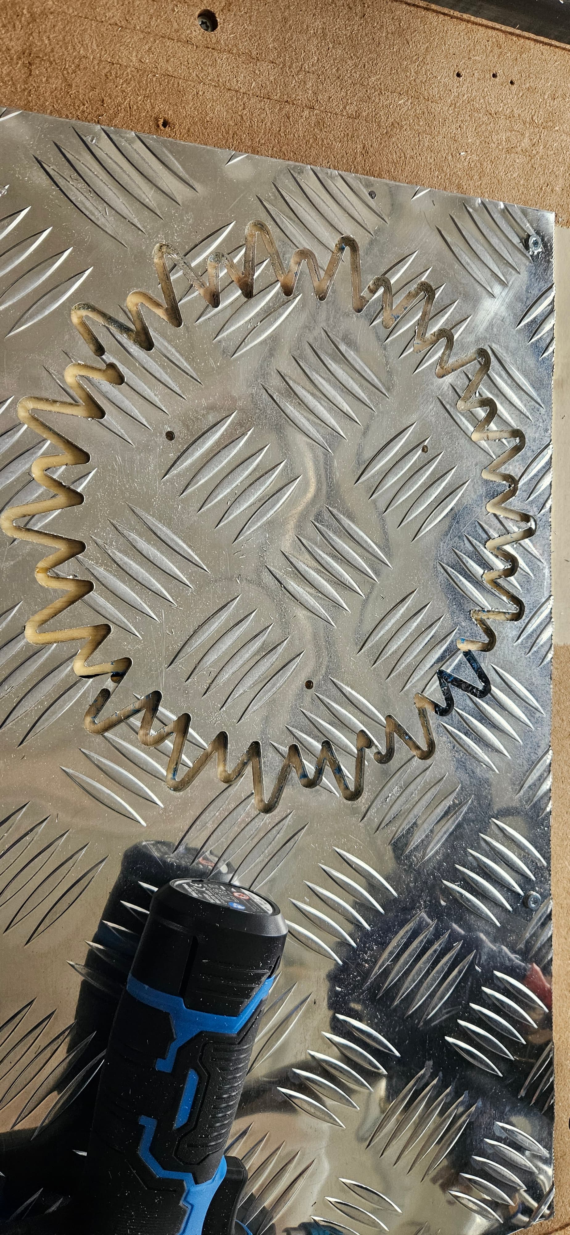

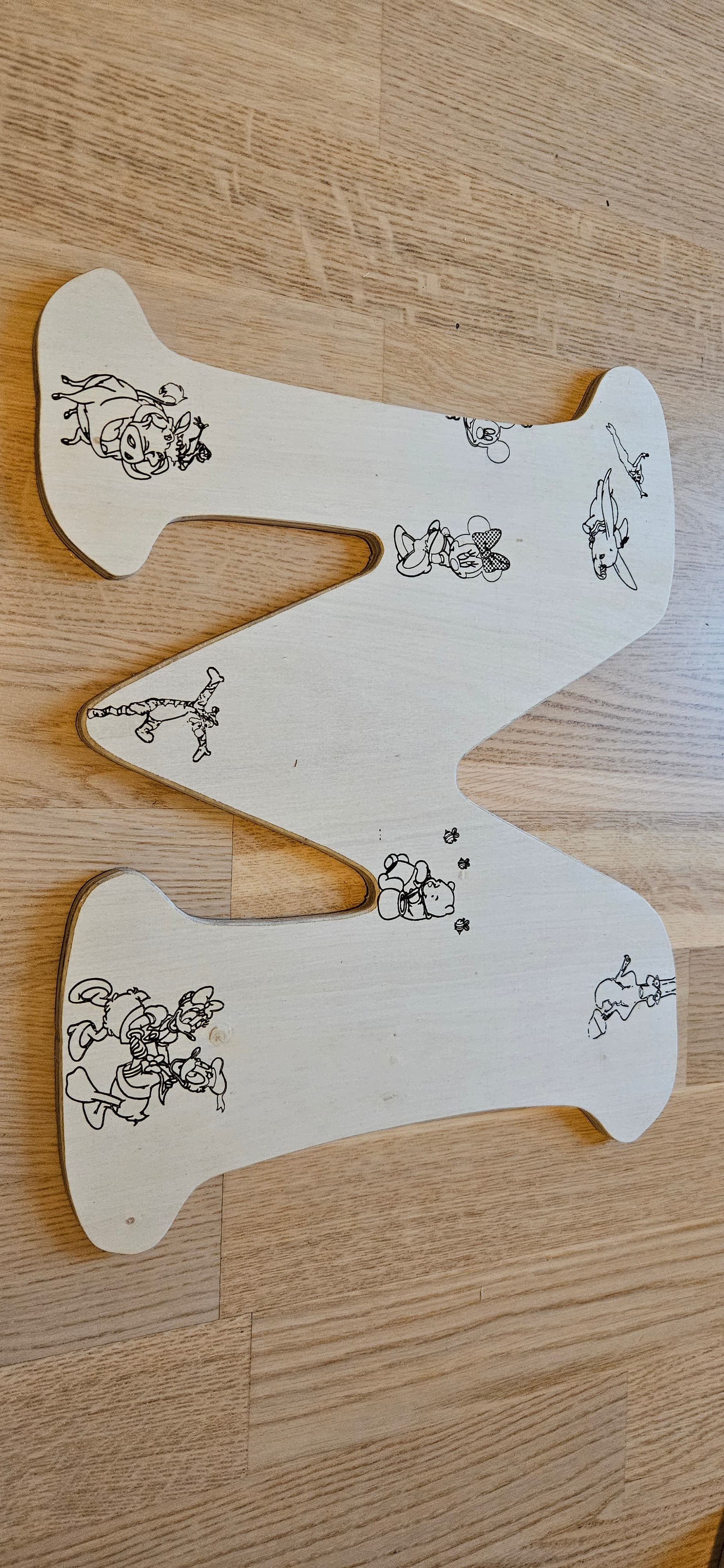

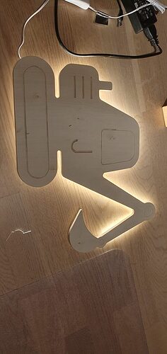

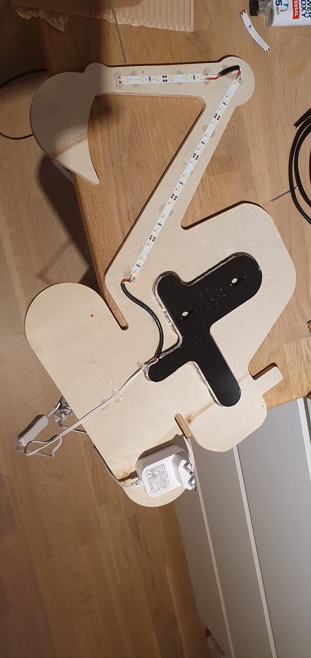

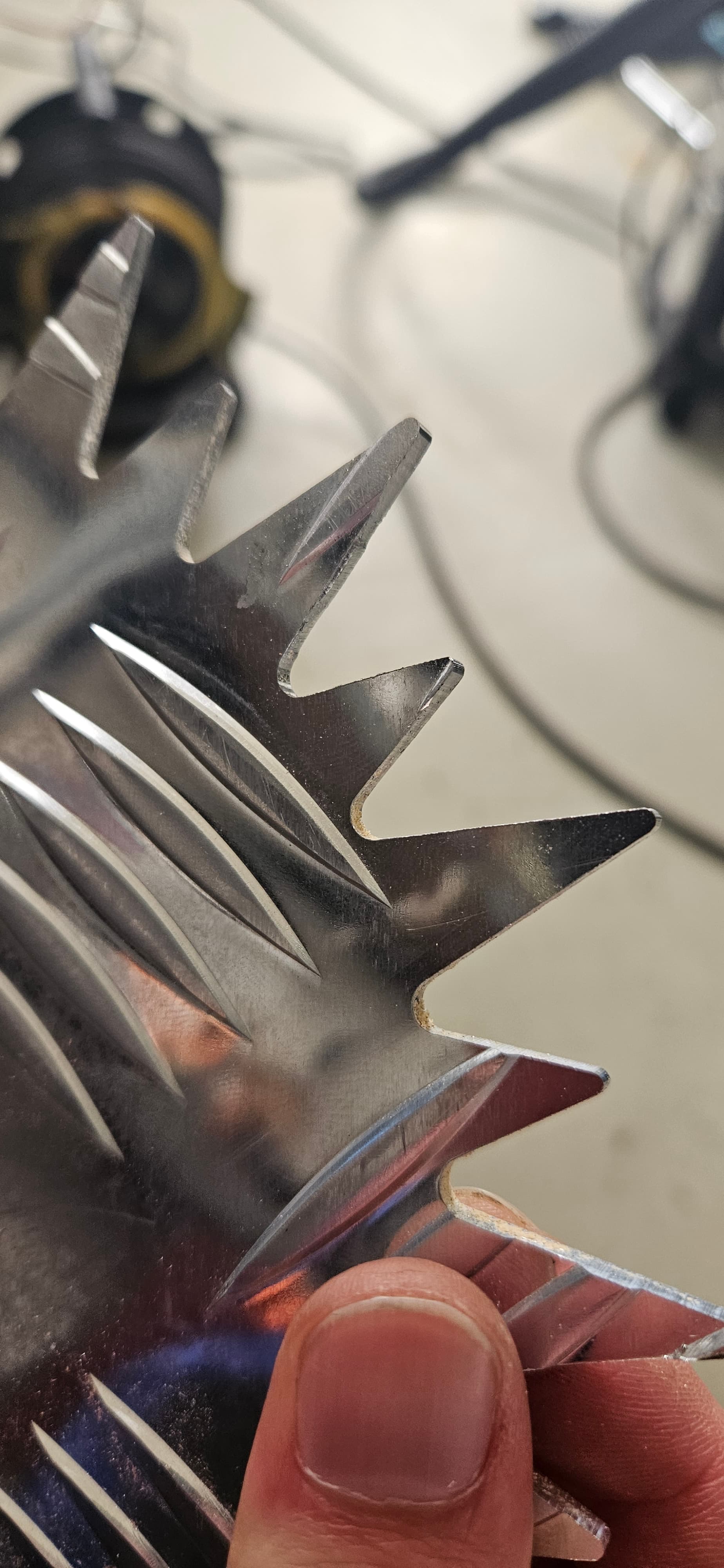

Very long time and no activity from my side on the page yet again. The MPCNC is working, but I am not using it much, this again makes each use a struggle as I dont know remember how to use it :sweat_smile: Turns out i had more fun making the MPCNC than actual usecases for it :upside_down_face: It has made chips a couple of times though. I have made a nightlight for one of my nephews, some aluminium spike wheels for my robotic mower, and last weekend I made a simple doorsign for the daughter of a friend of mine. The laser engraving is done by a seperate small laser. Some pictures of the projects attached below.
