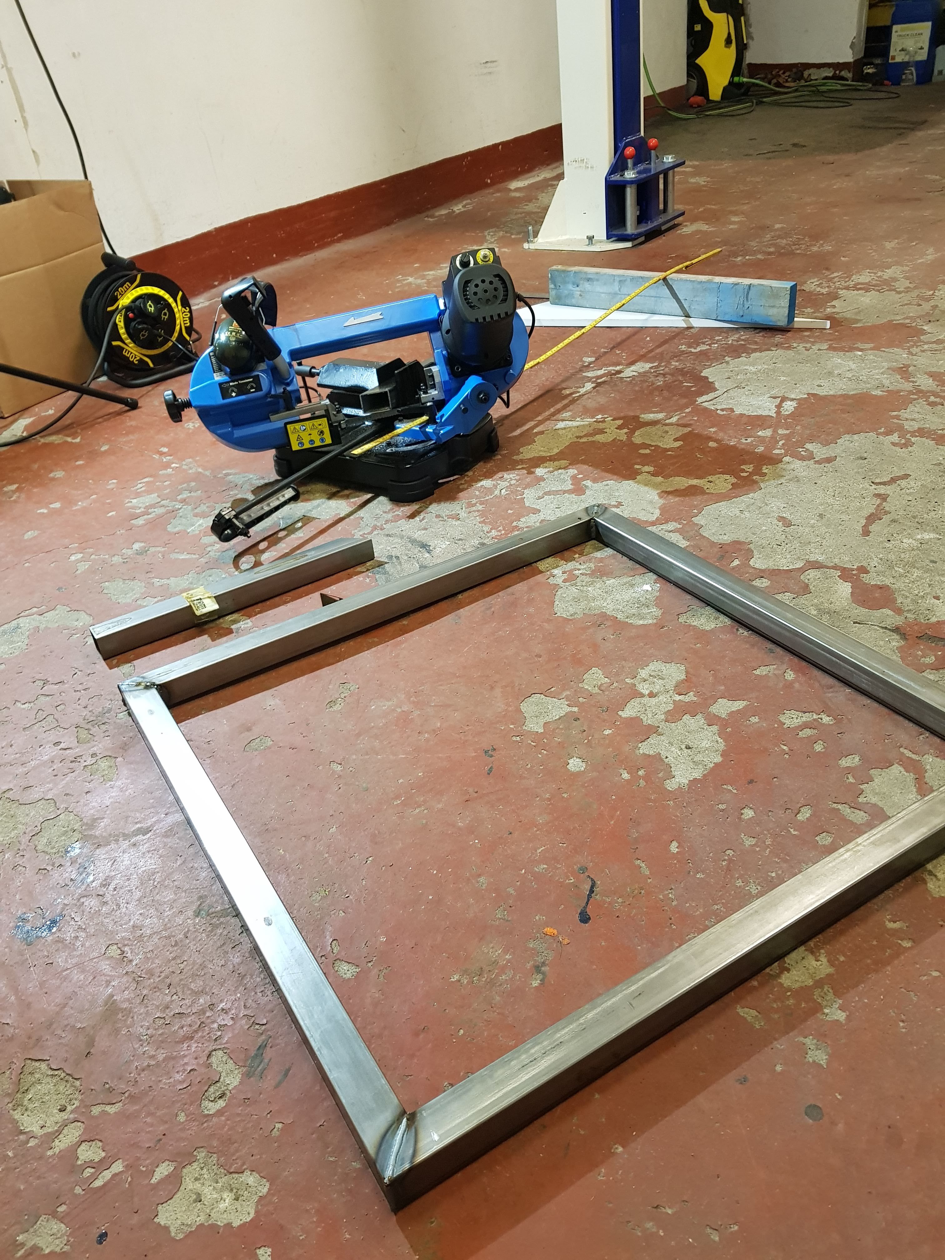

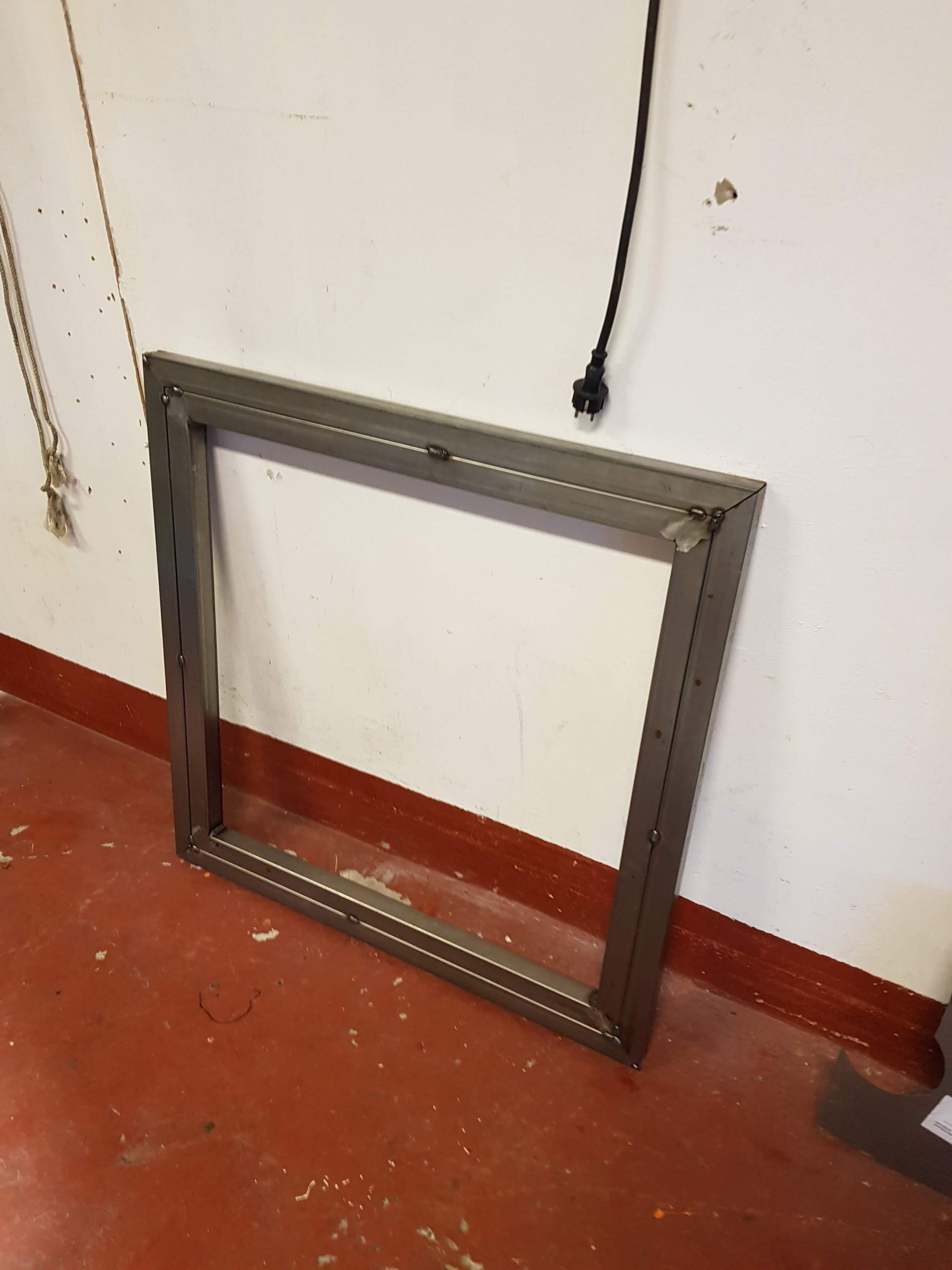

Slooooow progress with me lately, but I finally got tired of waiting for the saw I was supposed to borrow, so i bought one for my self. I also got a makita rt0700 for christmas so this might become a CNBC router instead of a plasma cutter. I got started on my steel framing for the table a few days ago and I have been making some progress.

Nice and heavy duty!
Love the build so far!
Have the exact same bandsaw (maybe different branded though).
What type of plasma cutter are you using?
I have a cheap chinese plasma cutter, nothing spesial at all. Im probably not going to use it much on the cnc though.

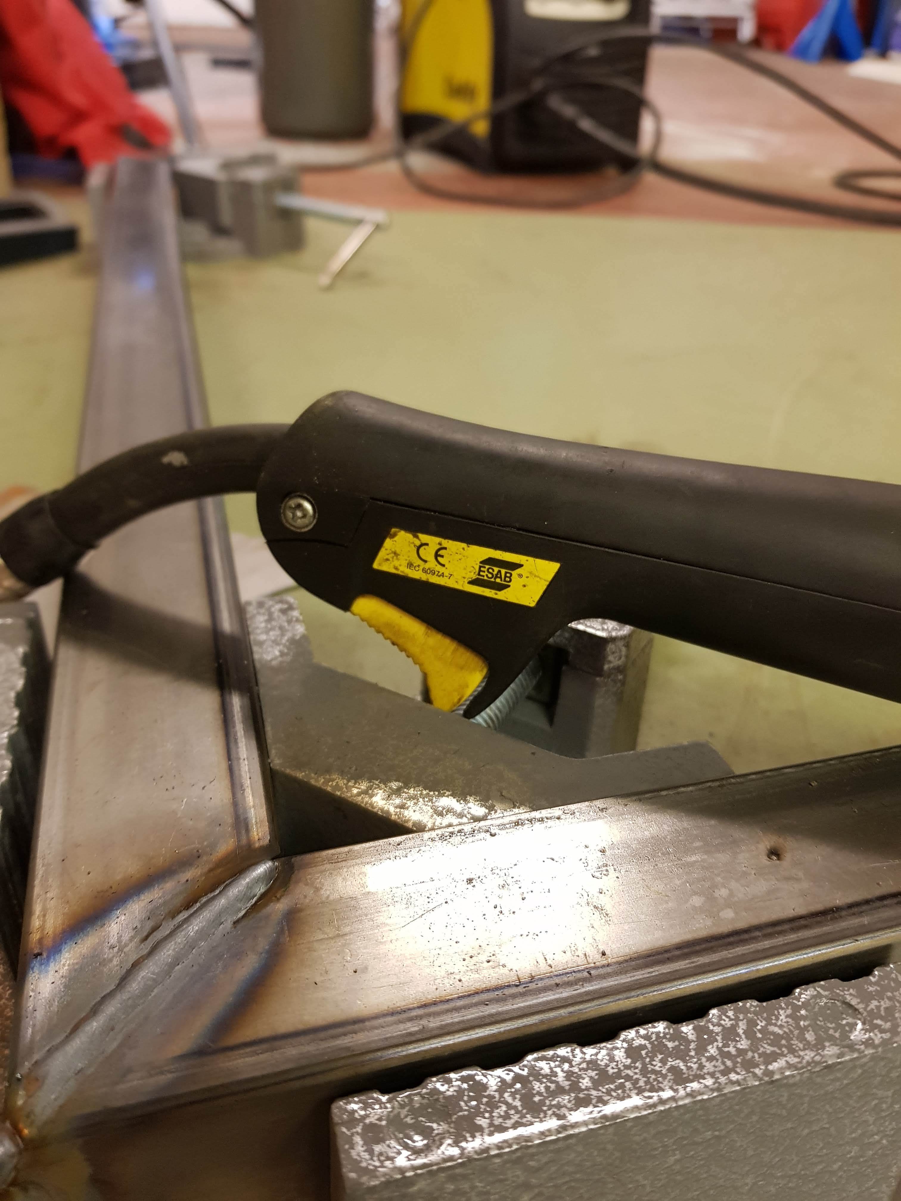

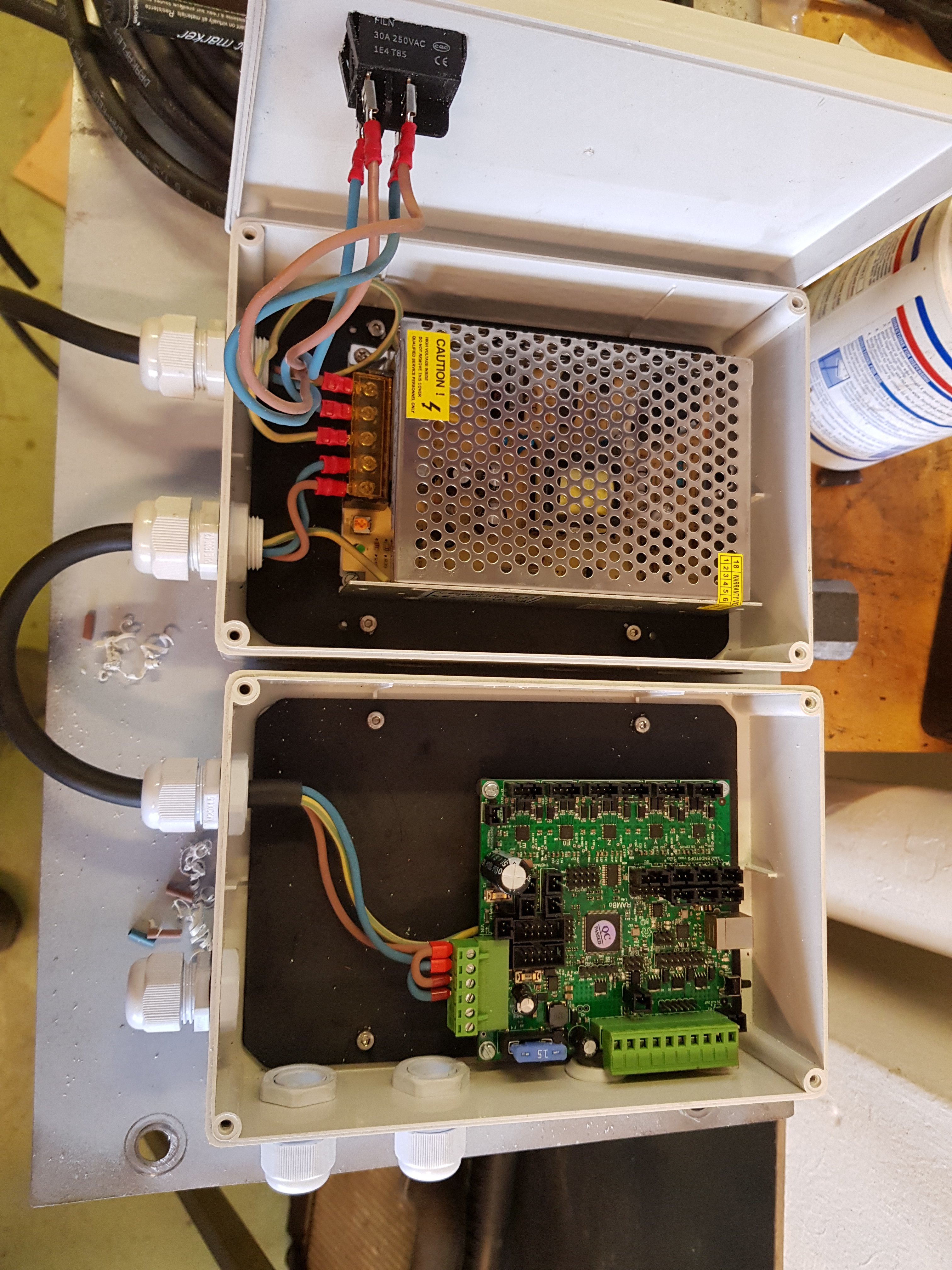

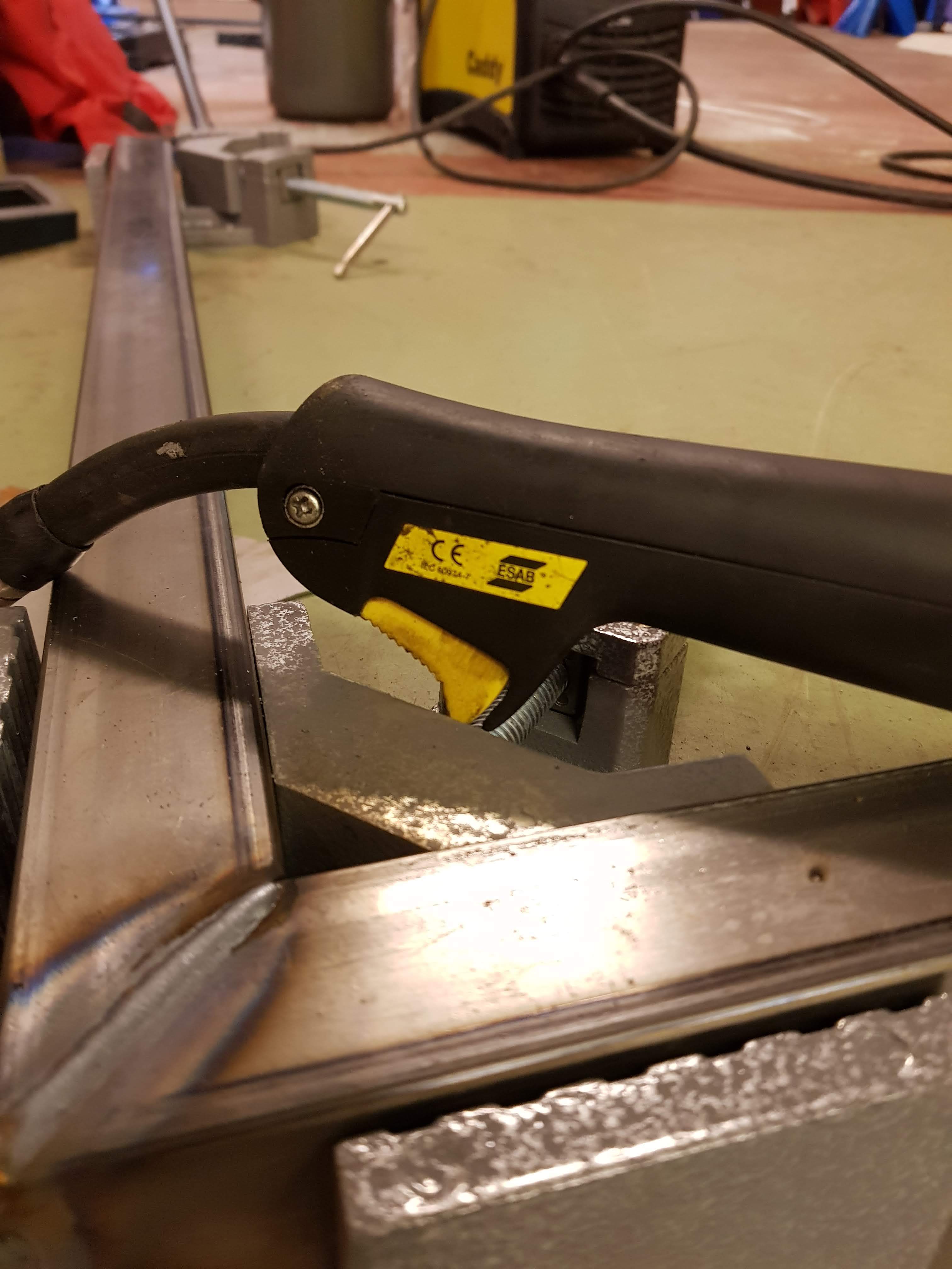

Some pictures of how assembly is coming along, my electronics, the plasma I have and the welder I’m using

Im making some progress on the build, and hopefully it’s ready for testing soon. Slow and steady wins the race right? ? and as always, pics or it didn’t happen ? the cable routing is temporary (and not finished) and will be routed through cable chains when I get them.
