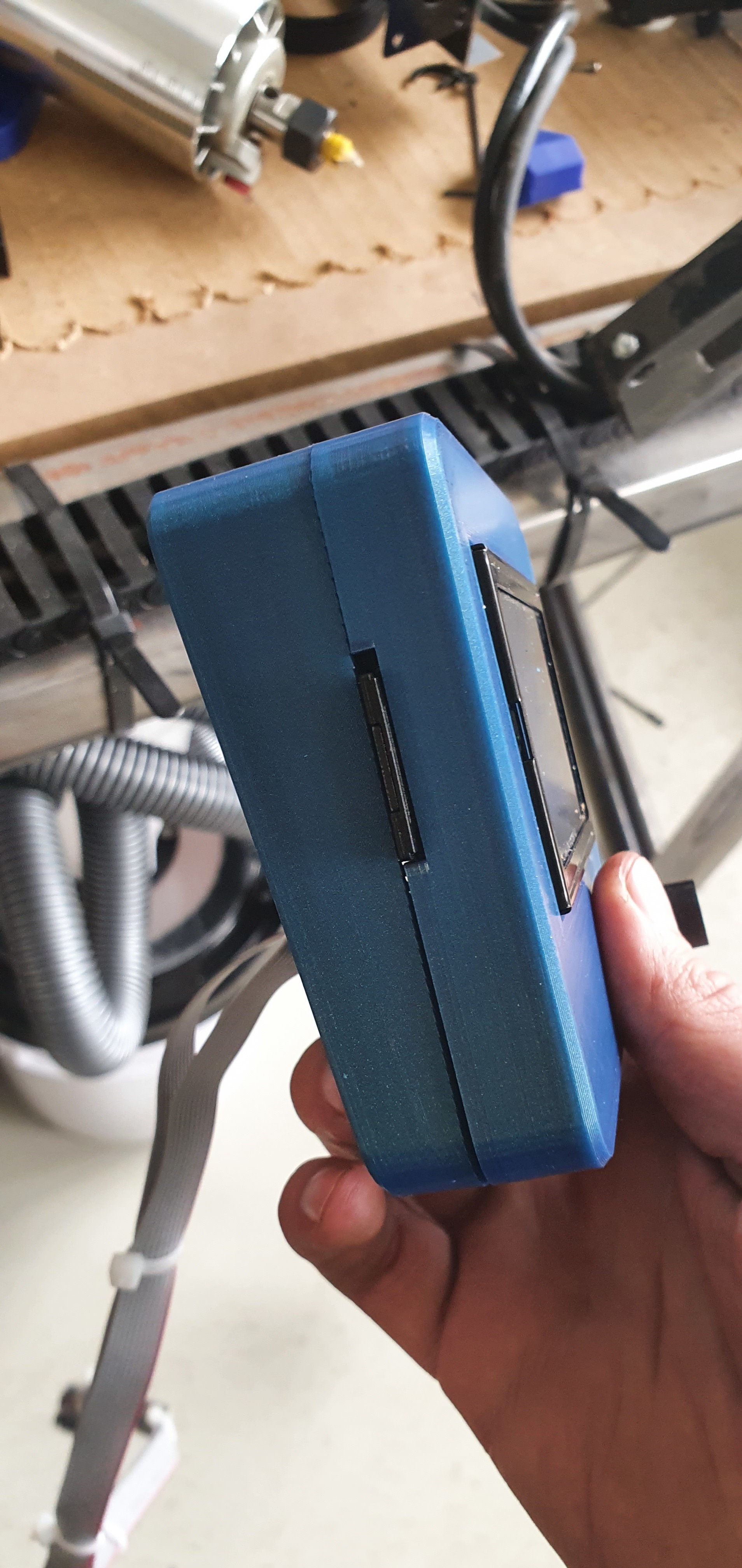

All of the printed parts are ready, and i have started assembly. I’m lacking some steel tubes though. I have also planned to go for dual endstop this time, And partly because of that i have purchased a proper steel cabinet for the electronics. The old solution with the display/controller stuck to the side was inpracticle, so I designed a box for it, and I will also fit it with proper connectors when I receive them to be able to disconnect it if I want to. I fitted the case with magnets, but they are probably to weak to hold the cables as well.

I made some cables for the display to be removable, but turns out either the plugs make some sort of problem, or the cables are to long. They display doesnt work properly, so i have to use regular ribbon cables or shorten the ones i have. A shame, as I really liked the solution.
Heres how the display looks with the extended cabling
Plugs on the back of the display
Connections inside the electronics enclosure.

The cables I ship are about as long as you can reliably go without LCD issues, unfortunately.
