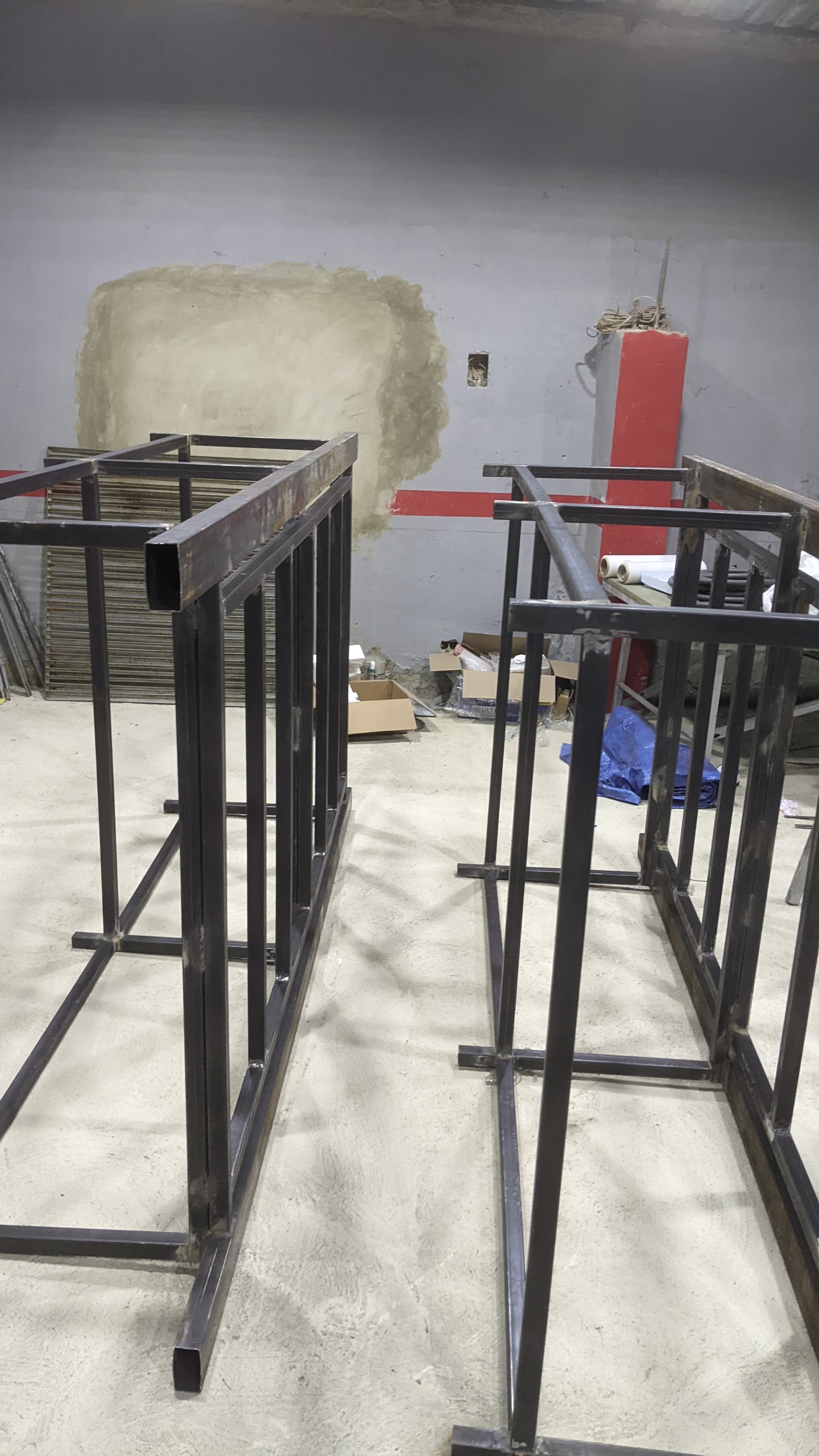

the table is a cad model availabe on Onshape: 3 actually, one from Ryan, one from Jonathan and one from doug ( i didnt read the full context of your message and asumed you were asking for the cnc model not the table )
i went with steel tables, ended up being 1/2 price of mdf/wood

Steel table or even alum would be great, but I don’t have the abilities or equipment to solder, and I already have a very sturdy wood table I built for the LR2, so a slight mod with side slats should do the job, or so I hope :man_facepalming:
wood has became extremly prohibitive here, as aluminium. i did 2 tables in steel tubes for the price of 1 wood table.
Over here is the same, both are very expensive, even the cheapest quality sheet of plywood made out of poplar tree is expensive.

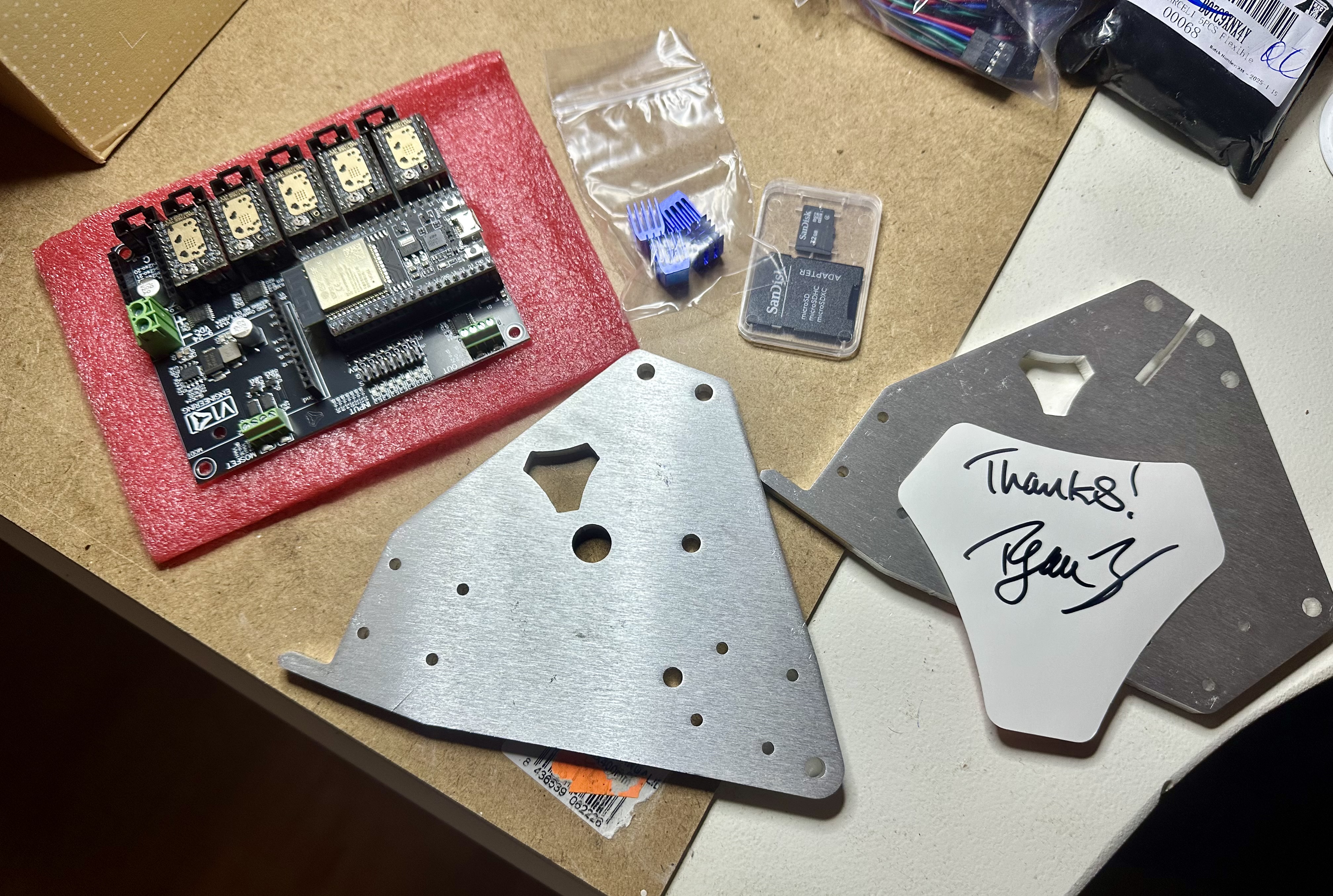

Feel like a child on new boots, thanks @vicious1 Ryan, it’s been a very fast delivery !!!
Oh…a Ryan Z, I was feeling spicy, I rarely do that.
This will probably sound stupid, but I like those details when I order things from relatively young or small companies, means that someone it’s on the other side caring for business, not just a robot…if you know what I mean.
