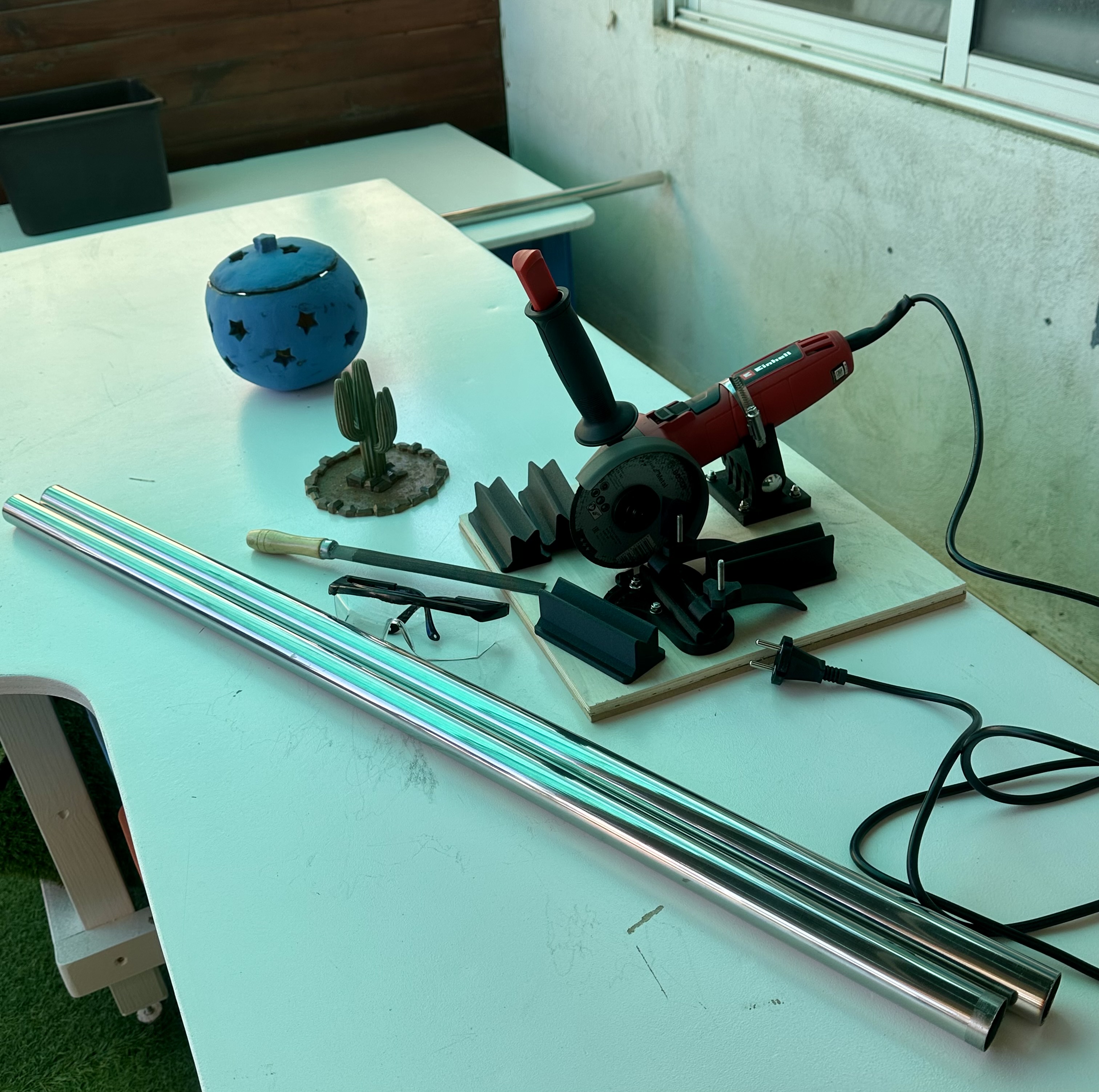

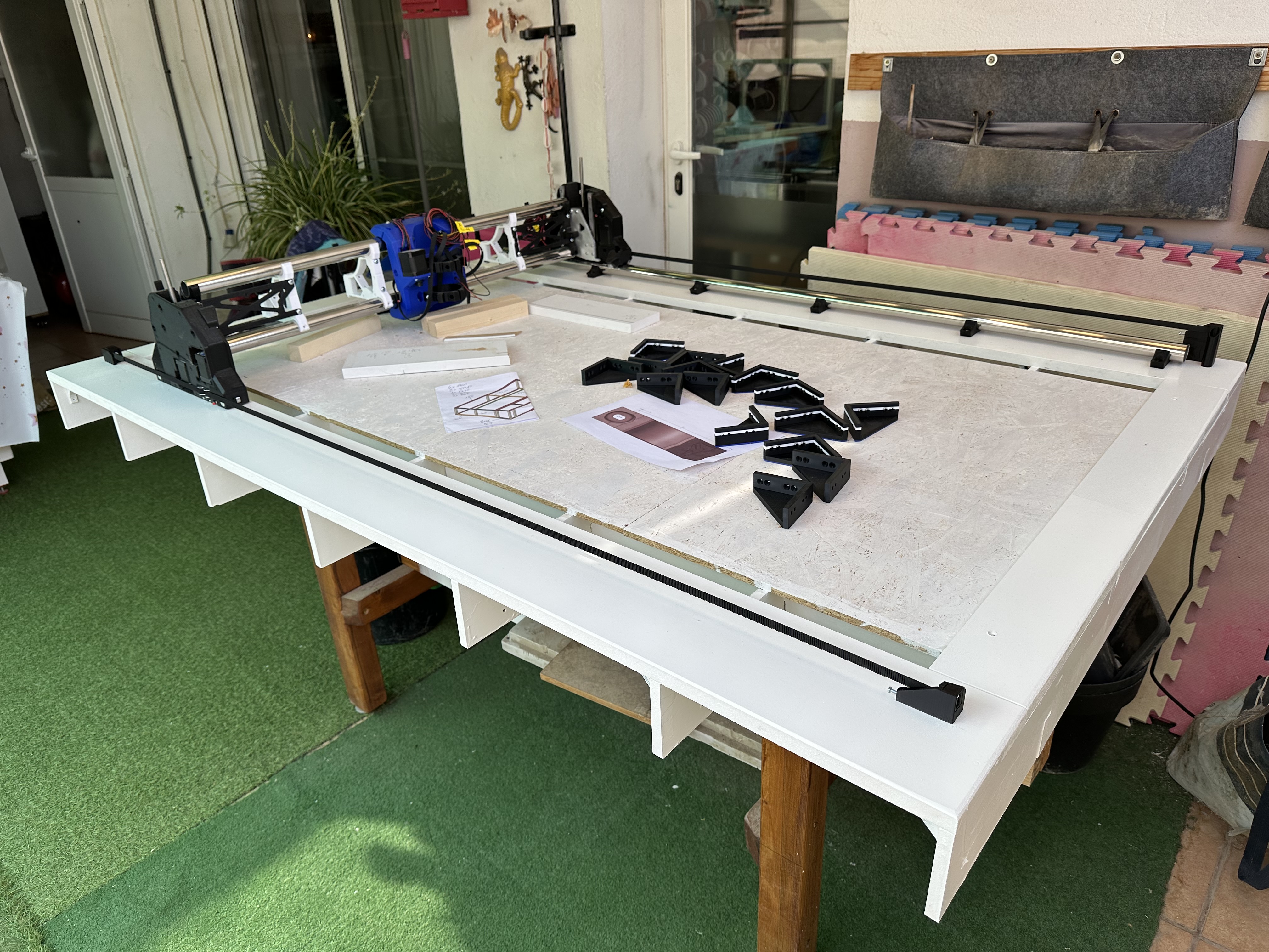

Got my tubing cut to desired size, new to using a grinder so I decided to adapt a design cutting jig to get the tubes cut nice and safe.
Now back to assembling !!!
Slowly getting there… :wink:

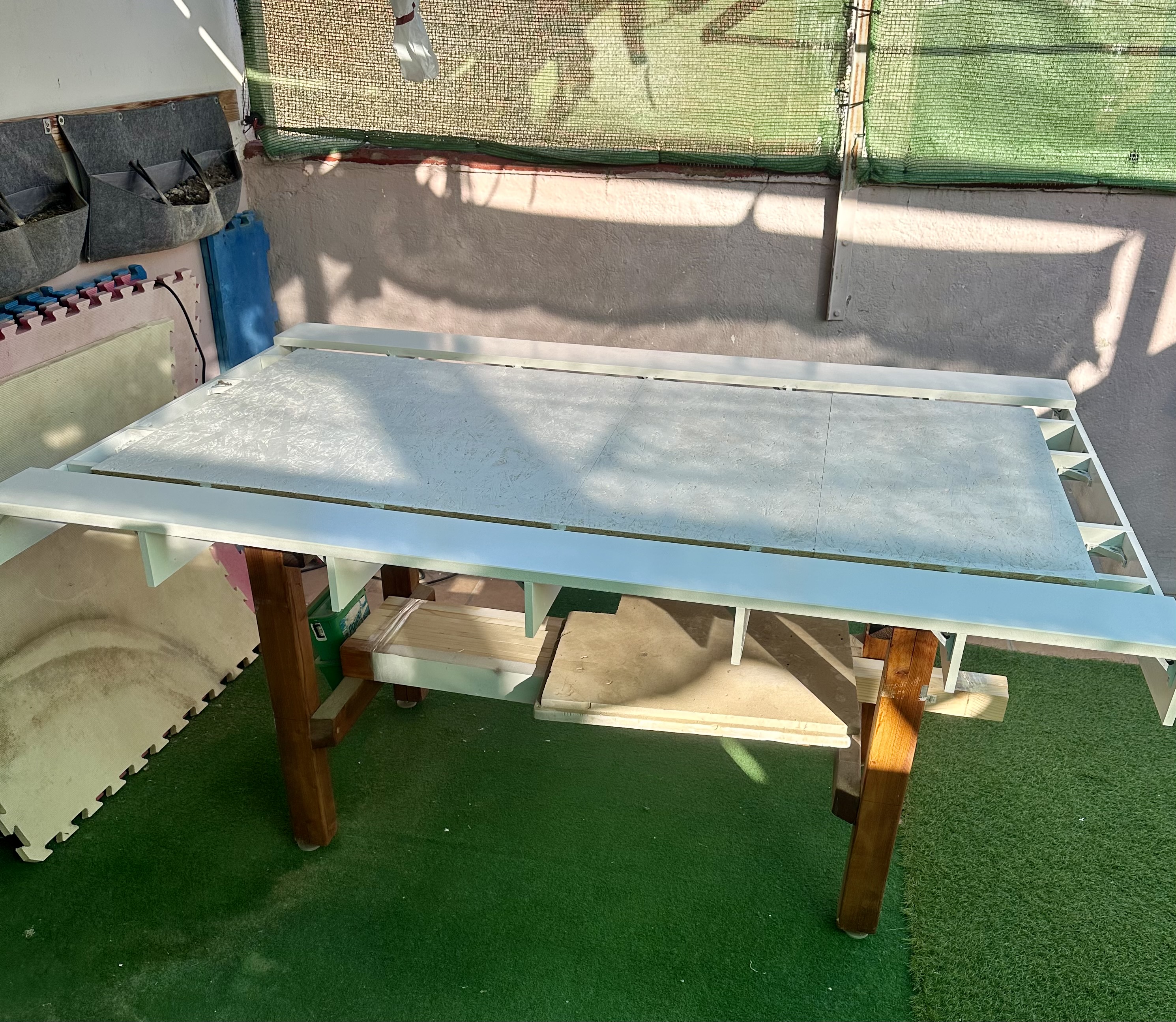

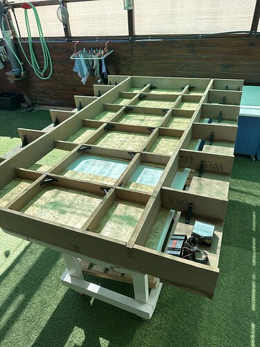

I’m finally going to rebuilt my table top, it’s been exposed to rain (although covered) for too long and as I intended to make it wider and longer, it’s a good time to rebuild it and build it properly.
And I’ll have time to design how I’m going to enclose it and make it waterproof.
So it will take a bit longer to see the LR4 running on it.
I’ll do some wiring while I wait for the wood pieces to get cut to size, going to build it with the cross structure to hold the spoil board.
Àlex

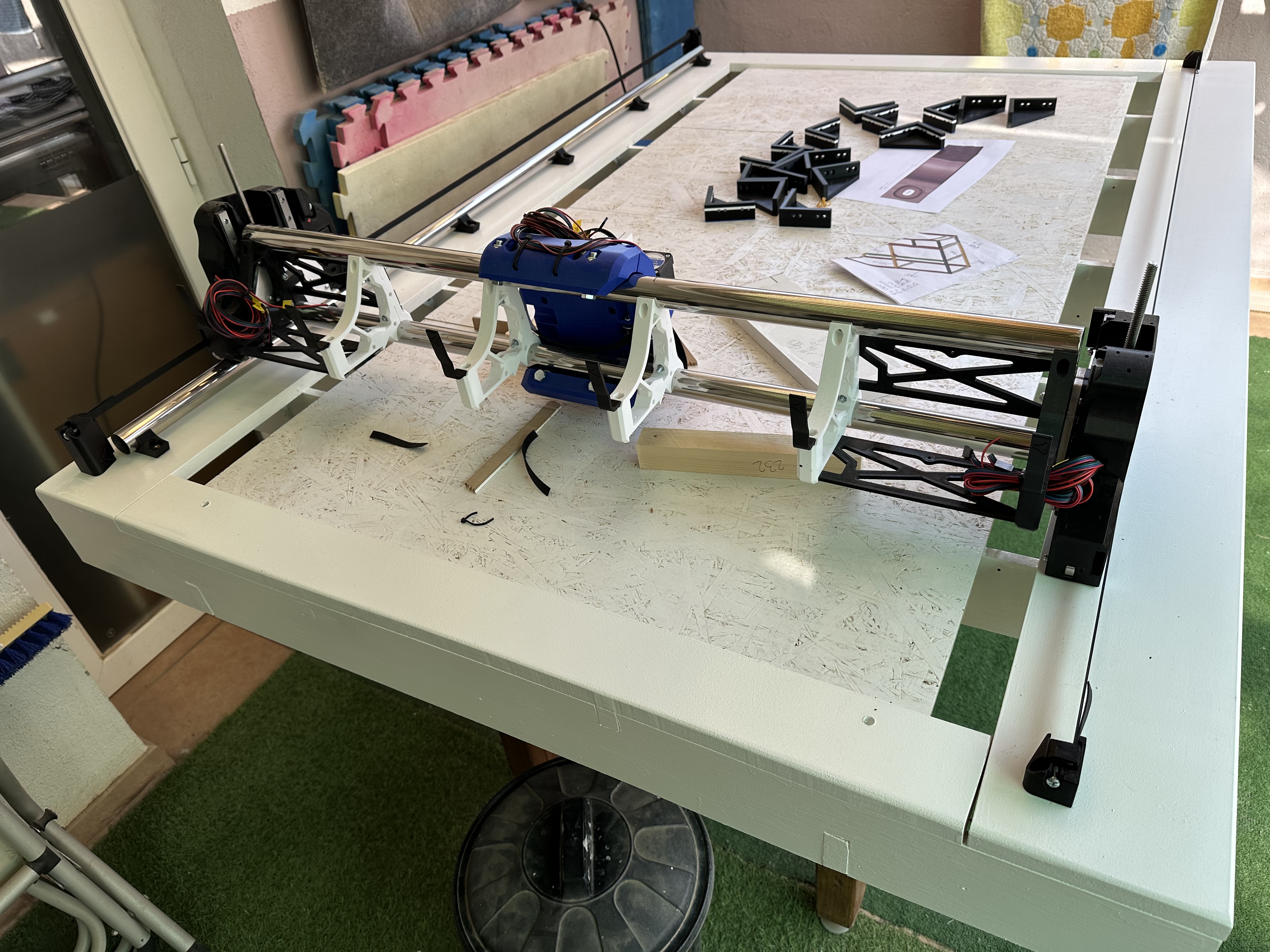

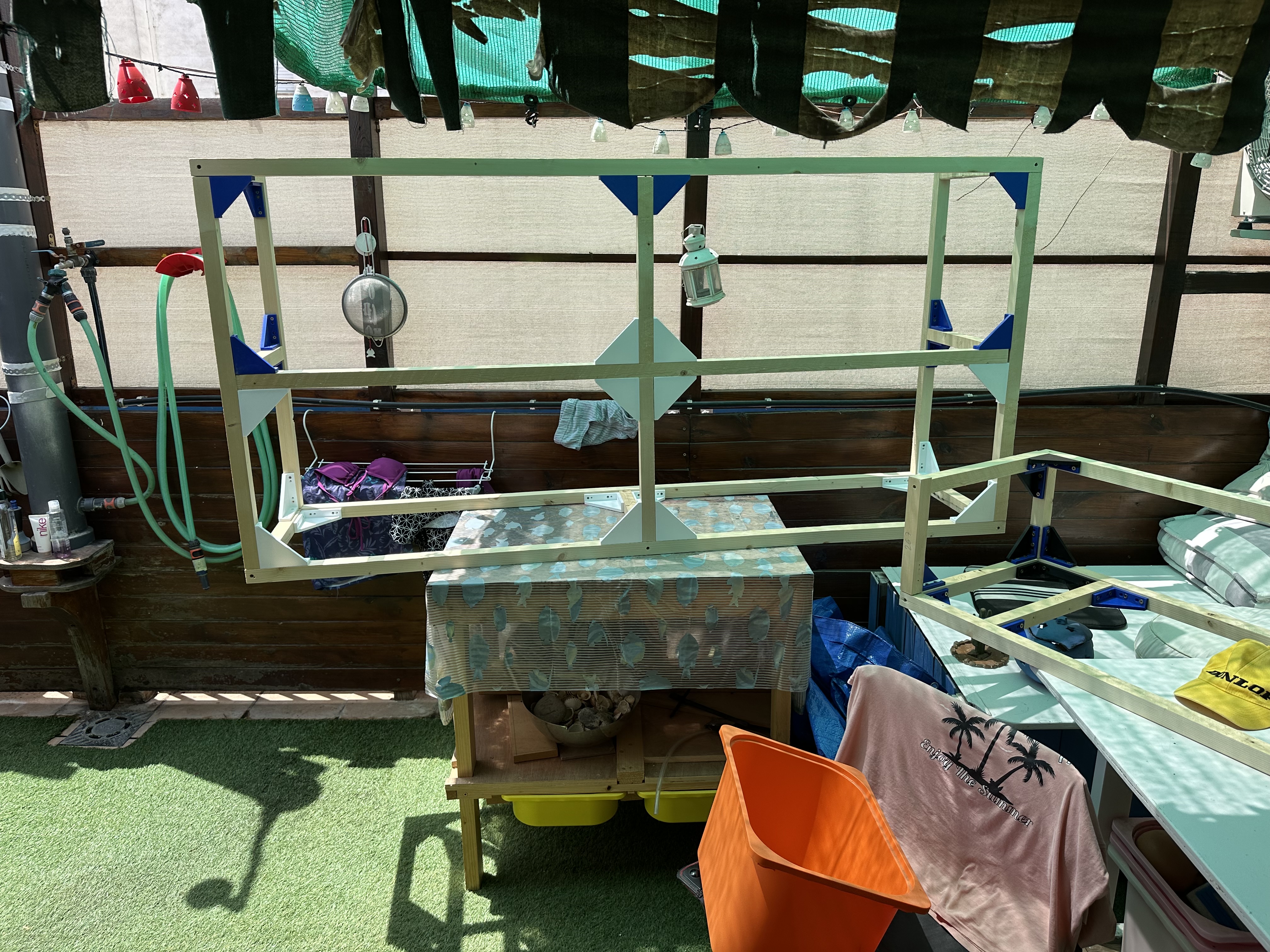

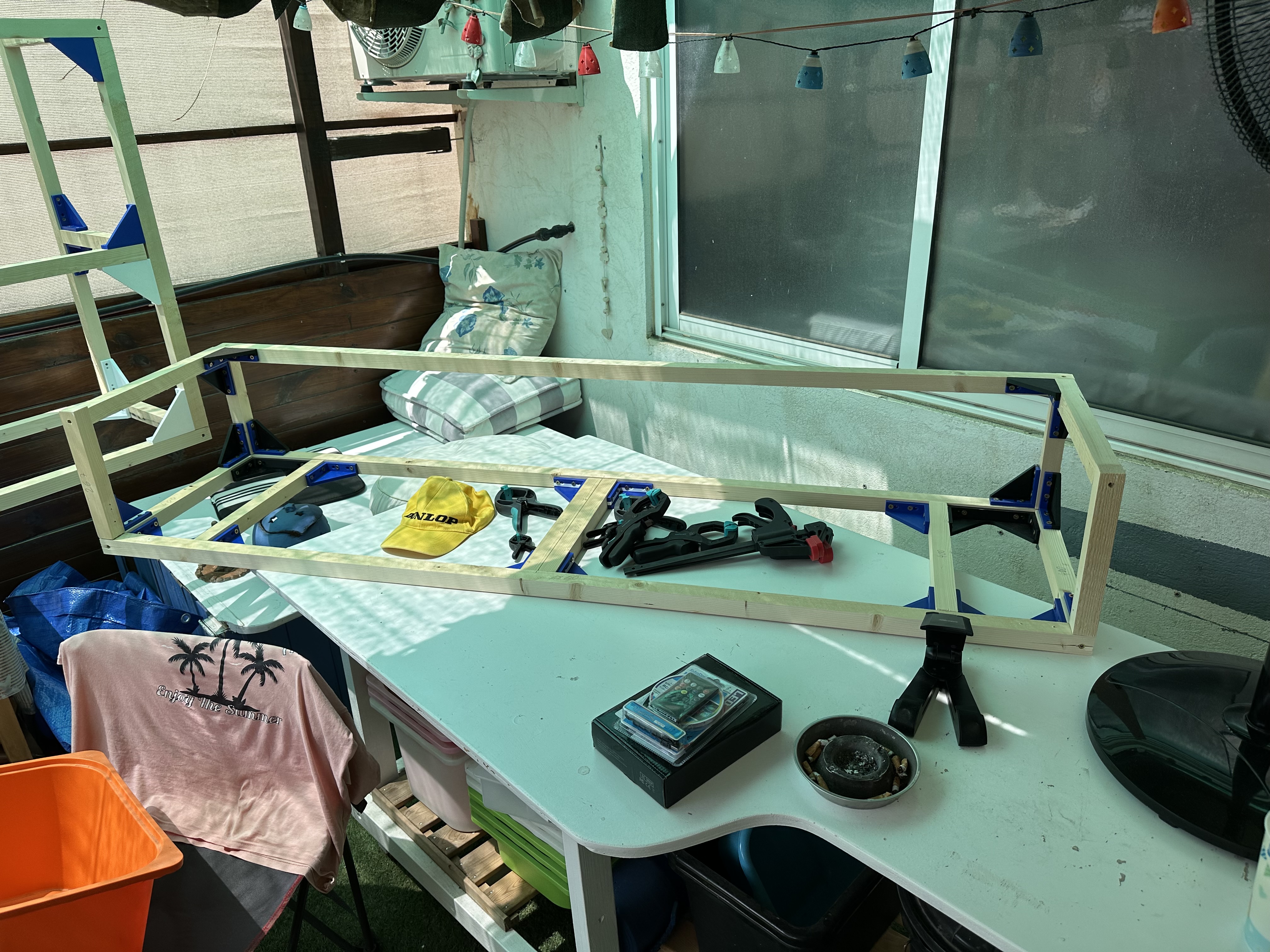

Slowly getting the table done…it’s been rainy here lately :man_facepalming:
Done some painting already, now need to figure out enclosure :man_facepalming:
Will change spoil board too to extend it to the side rails, but first I want to see it running.

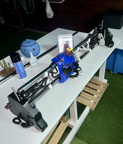

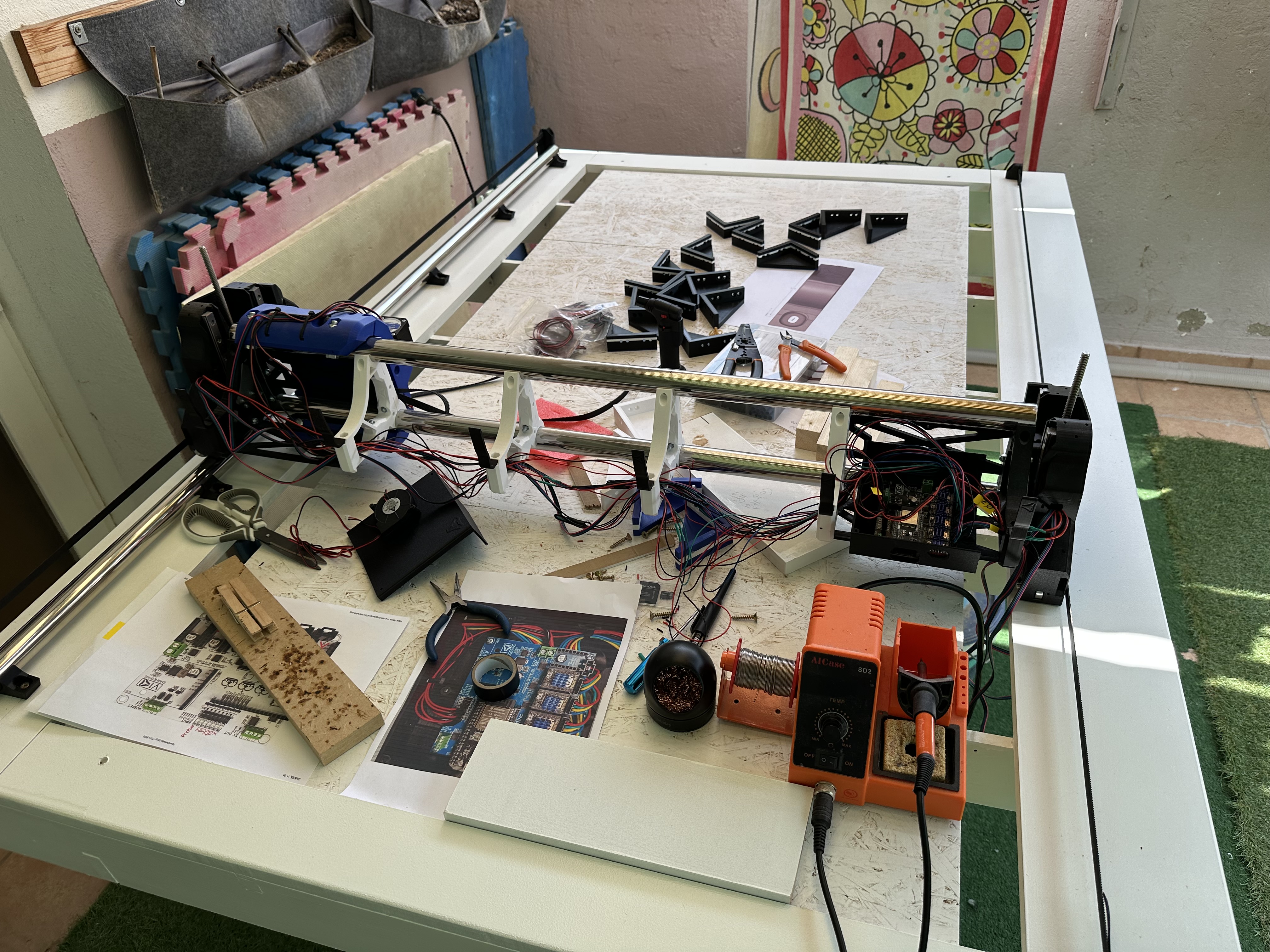

Had some time to go forward on the LR4 assembly…it’s been 36 degrees these past days and working at the terrace is killing me but got some work done and I’m happy for that !!!
Enclosure is still under works :joy::joy::joy::joy:

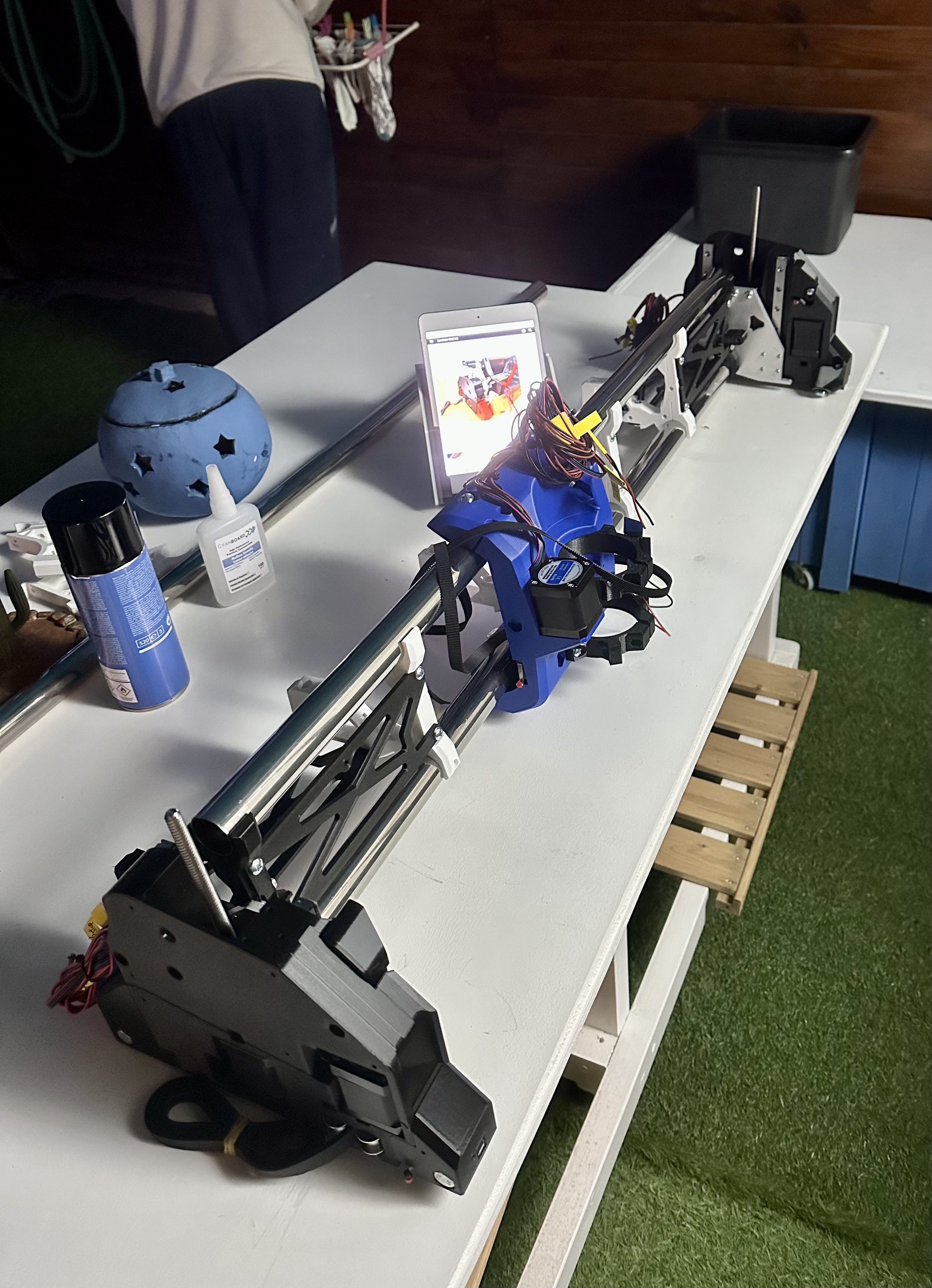

Enclosure structure nearly done, wiring nearly done too…needs tidying up and then if I have time the next coming days will fire it up and see if everything runs fine.

Finished tidying up the board box wiring, had to stop due to an alarm on the mobile of summer storm, suddenly wind went from 0 km/h at 40 degrees to 50 km/h at 30 degrees in 2 minutes, had to cover everything up, just in case it finally rains.
I will try to do some more work overnight when temps are lower, my poor old brain boils when it’s so hot outside.
Wiring issues are not that terrible in my opinion, only had a bit of a hard on first side build, once this was done and using the tips second one was easier, and it looks really clean.
