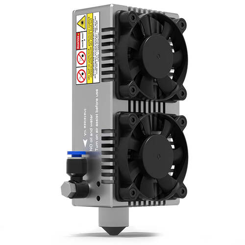

I’m finishing the table base for the LR4 and I’ve been thinking on trying a Laser build instead of a router, mainly cutting plywood and thin MDF with a max width of 10-12mm, it’s a matter of noise reduction.
Here’s the build thread New LR4 Build in Catalunya - #95 by AlexBondCat
I’d like to find a decent laser of 40-100W and would like to know what changes need to be made in terms of board config, etc…and if @vicious1 board will be able to control a laser, etc
Thanks in advance.
Àlex
You can find stacked diode UV lasers in the roughly 40W optical power range, but they won’t have nearly the cutting power of even a 40W optical power CO2 (IR) tube laser.
Cutting 12mm plywood with an LR4 is a stretch with a stacked UV doide laser, may be a stretch too far.
Here’s an example:
Edit: though not around 40W of optical power.
You’d want a looooong focal length lens on such a dioide laser; a way to get rid of lots of smoke; and a good supply of water to put out the inevitable fires.
Cutting thicker than 1/4" plywood is hit or miss with short focal lengths and MDF is a non-starter in my experience.

Something is seriously wrong with your CO2 laser machine. A 100W CO2 laser should blast through 5-6mm plywood and should outperform all diode laser machines. I use a 12W diode laser, and routinely cut 5.4mm plywood.
A 40W diode laser should be able to cut 12mm plywood. You will see YouTube tests of these lasers cutting 12mm and thicker material, but 12mm is probably the outer limit for good cutting.
Also be careful of advertised power of laser modules. Ads are misleading and sometimes contain outright lies. There are few true 40W diode laser modules that can be used on a Lowrider, and expect to pay $600 or more. If the price is lower, you are probably getting scammed. Laser Tree is the only brand of 40W module I’ve seen on the forum successfully used on an MPCNC.
