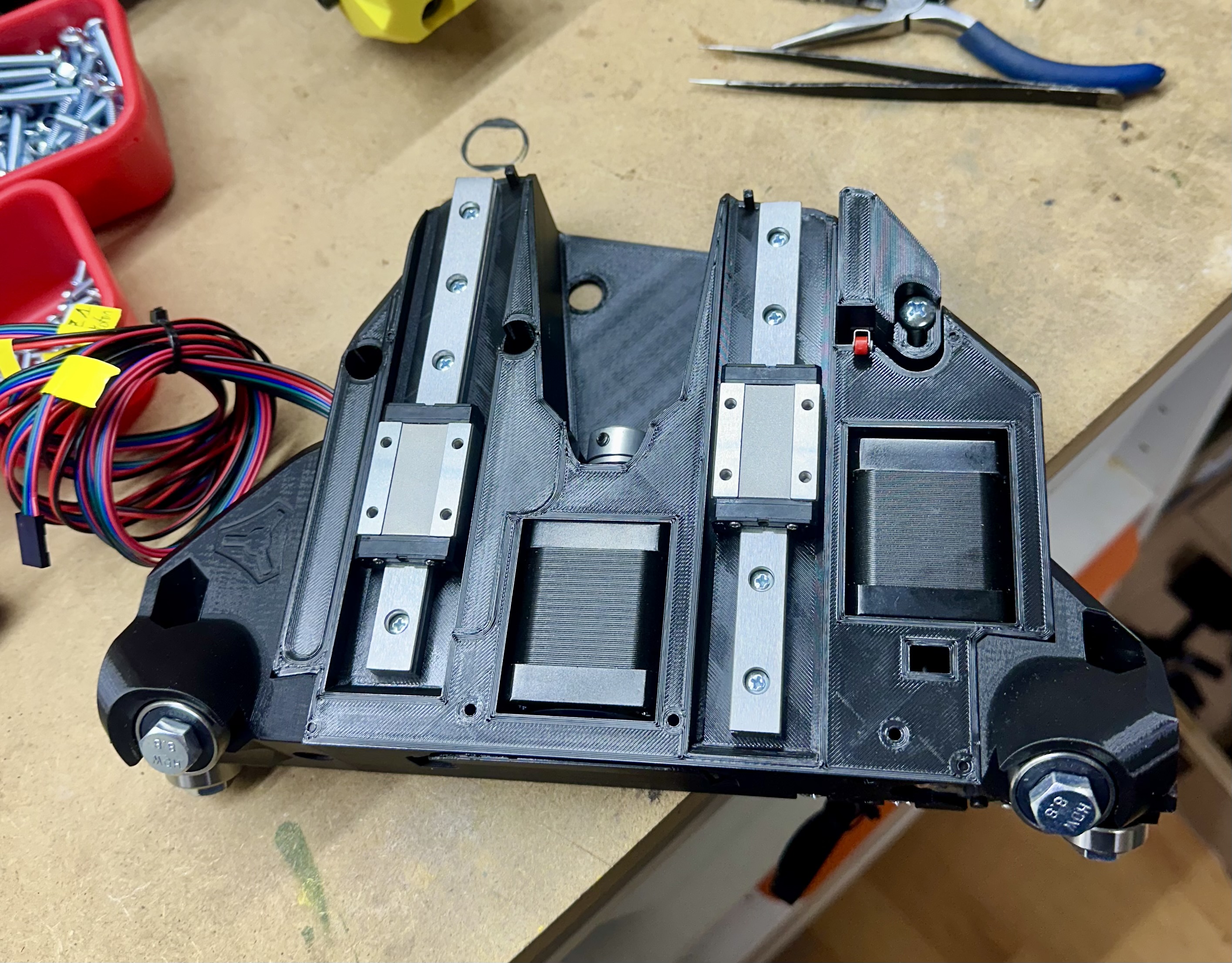

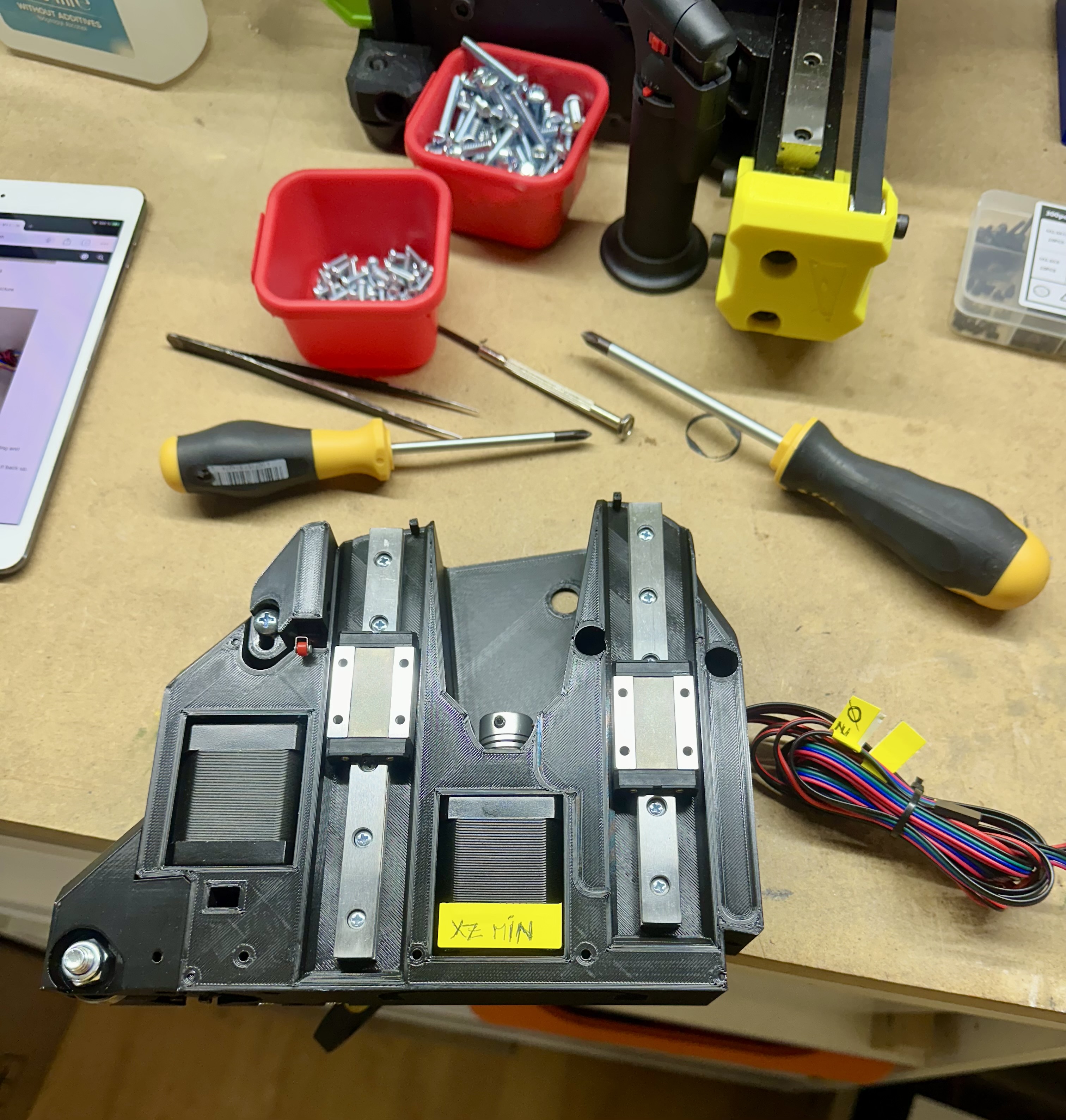

XZ Min done, waiting for V1 order to arrive to finish it.
Wiring has been a test, finally found out the best way is to get all motor wiring through holes first and then the rest.
It’s not the first language for most of the people around here… Take that for what you will. :wink:
Time to start XZ Max…and find the T8 lead screws I used on the never finished built of the LR3. Don’t ask why never got it to run, it’s a too long story.
XZ Max almost done !!! This one was easier to get wires through guidance holes :stuck_out_tongue_winking_eye:
