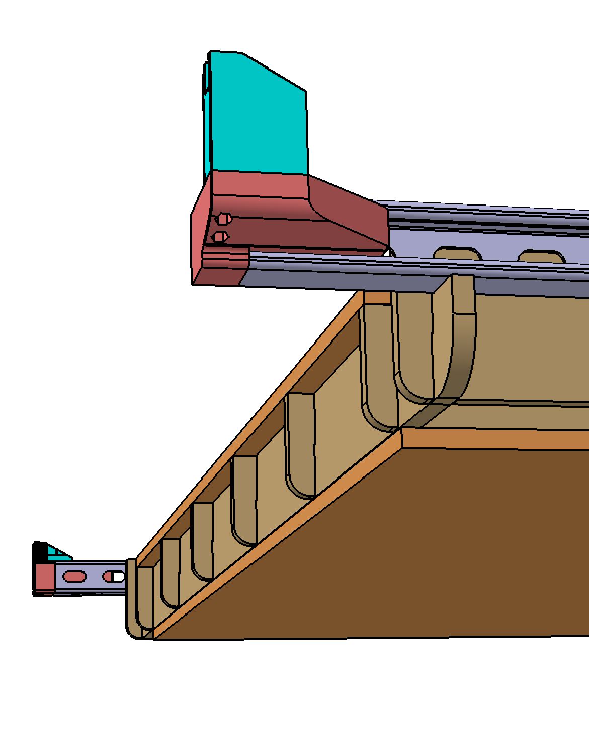

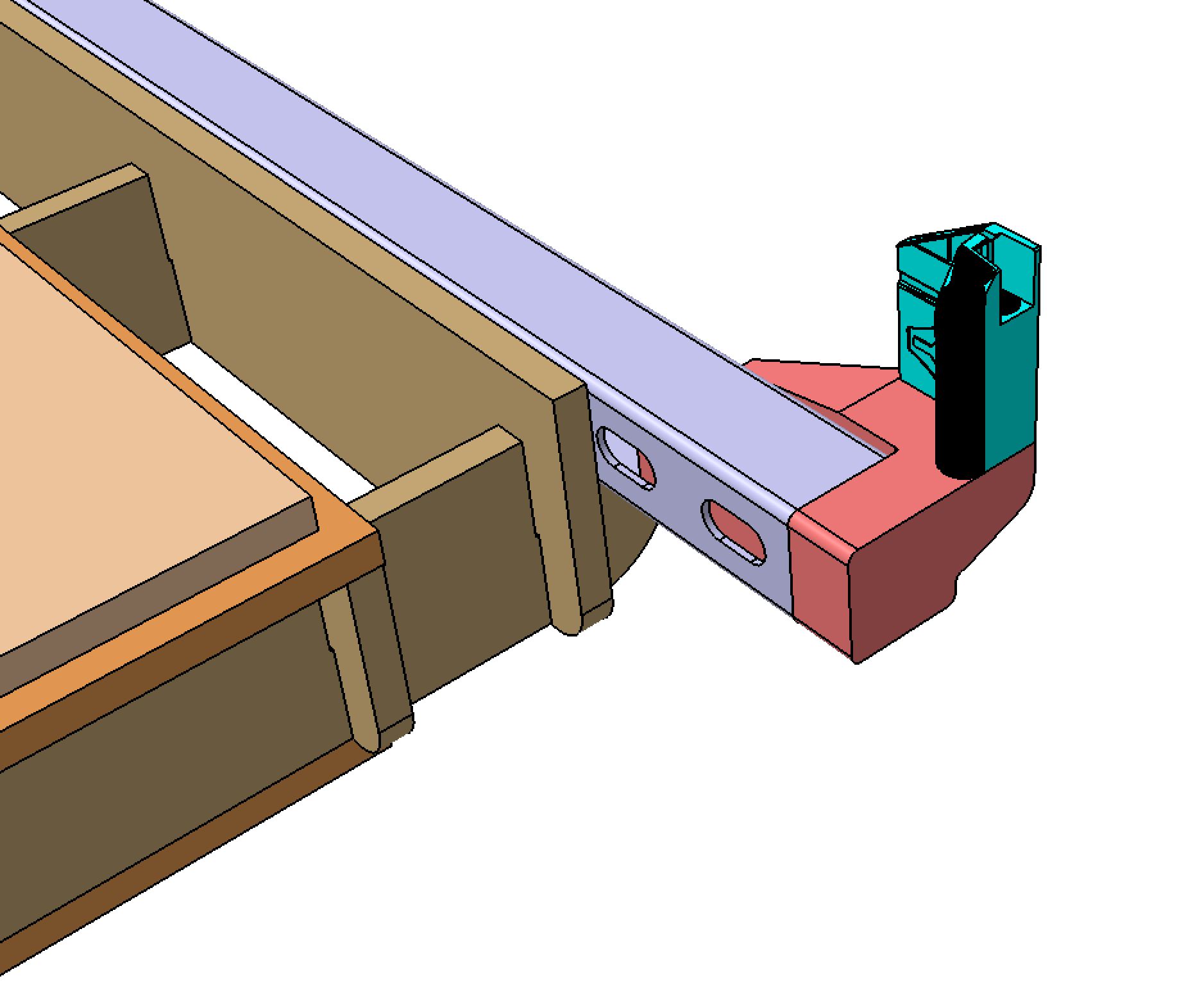

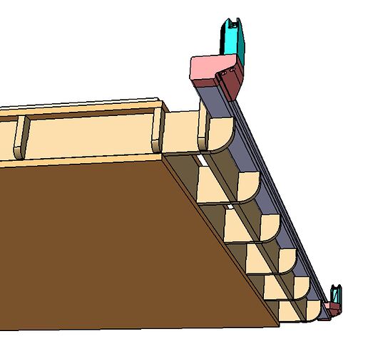

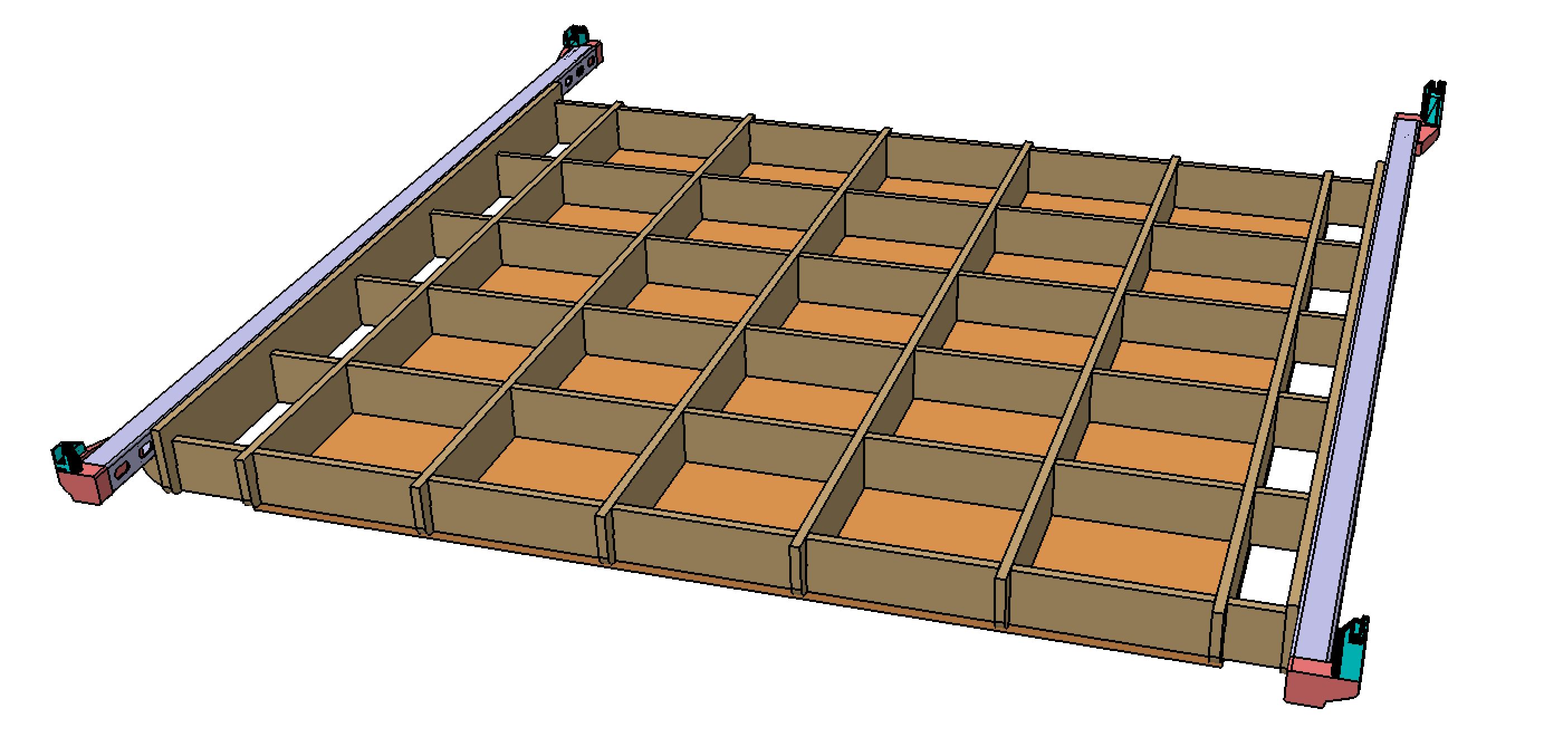

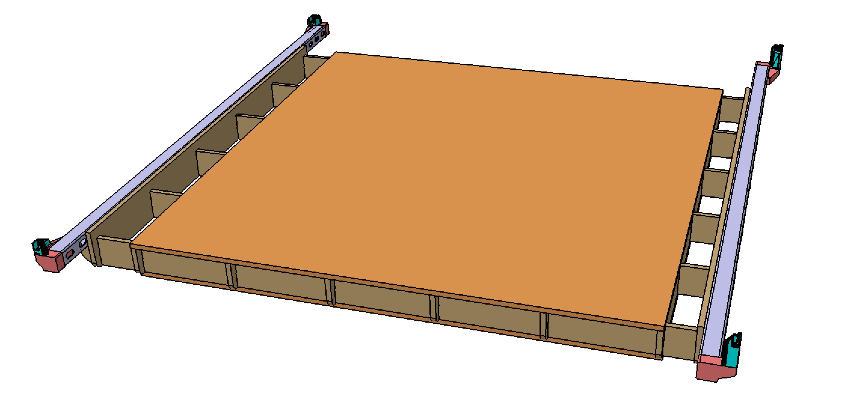

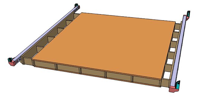

Alrighty. Here’s where I’ve landed with my plans for the table. Plan is to just put it on sawhorses at first and then maybe build a cabinet base (with my fancy CNC router) later. Looking for a thumbs up or some constructive feedback before I start cutting…
See pics below…
Design criteria:
  1. Work area of 49”x49”
  2. Utilize Unistrut for y-axis rails
  3. Easily sourced sheet materials
  4. Optimize materials used for construction
  5. Make it buildable using a circular saw and table saw
Results:
  1. Router travel in X/Y of ~49.5” in both directions - Unistrut is biased/offset (runs long) by ~2” toward Ymax and table is offset 0.75” toward Xmax to center the router on the spoilboard
  2. Design optimized for (1) 10’ section of Unistrut by remixing/redesigning Doug Joseph’s awesome Unistrut table extender design [unofficial] LowRider v4 DIY CNC - for use with Unistrut / Superstrut / metal strut - table extenders, rail clips, and rail placement jig v1.0 to add 25mm of bonus length at each end so my Y-axis didn’t come up short
  3. Tabletop and bottom made from 49”x97” sheet of 0.5” MDF available at Home Depot (or similar), the torsion ribs are from a 5’x5’ sheet of 12mm Baltic birch available at my local hardwood/plywood supplier, Unistrut is 10’ P1000 available at Home Depot
  4. The tabletop is 49”x49” and the table bottom is 49”x47” - this allows for construction from a single sheet of 49”x97” MDF. The torsion table x-ribs are 60” long which allows for construction from a single sheet of 5’x5’ Baltic birch. The y-ribs are 49” long which is a bit inefficient if you wanted to use 48” wide sheet material but works out fine in the 5’ BB
  5. Circular saw to break down the sheets, then table saw for rips, crosscuts, and dados…
Questions:
  1. Is it okay to mix materials? Baltic birch for the ribs and MDF for the top/bottom? I could do it all in MDF, but those “outriggers” for the Unistrut look a little vulnerable and I’d prefer to use plywood for strength.
  2. Is 0.5” thick enough for the MDF top/bottom and is 12mm thick enough for the BB ribs?
  3. Ribs are currently 3” tall - is this adequate?
  4. Preferred torsion box assembly method? Glue only? Glue and nail-gun (brads)? Glue/screw?
  5. How are people attaching the spoilboard? I was thinking of putting threaded inserts into the top of the table and then bolting the spoilboard to that.
  6. Any other suggestions?
Exciting! My table is plywood and my spoil board is MDF - and it works BUT a lot of times for material hold down I use screws right straight into my spoil board, and MDF doesn’t hold screws real well. I wish I had put a layer of OSB (oriented strand board) on the top of my torsion box and then put my spoil board on top of that.
My plan was to build the torsion box with plywood ribs and an mdf top (mostly just to have a 49”x49” top surface based on the availability of 49”x97” mdf sheets).
In addition to what I show in the images, I’d plan to attach a separate mdf spoil board to the top of the torsion box. I was thinking threaded inserts (designed for mdf) in the table top and then bolt down the spoilboard to that.
It’s entirely possible (highly likely) that I’m overthinking things, but I like the idea of cutting past the full width of a 48”x96” plywood sheet and the 49” work area would let me do that. If this seems totally unnecessary, I suppose I could build the whole thing out of 4’x8’ OSB, particle board, or cheaper plywood.
I struggled with this as well. Looks like you have a plan. The one thing you might add to your considerations is whether you’d ever want a drop table component. Basically a section you could remove to give yourself depth for a rotary axis, or a thicker project. With the unistrut design, I think it would be hard to raise the whole rail.
I have a section of my spoilboard that can be removed to reveal a deeper section. I primarily use it for laser projects, but I’m glad it’s there. It does complicate the design a bit. I also left the struts a little long so the gantry could ride out over open space (for the ultimate drop table.) I guess it depends on whether you’d want to do any work on the ends of workpieces.
Just another consideration.
