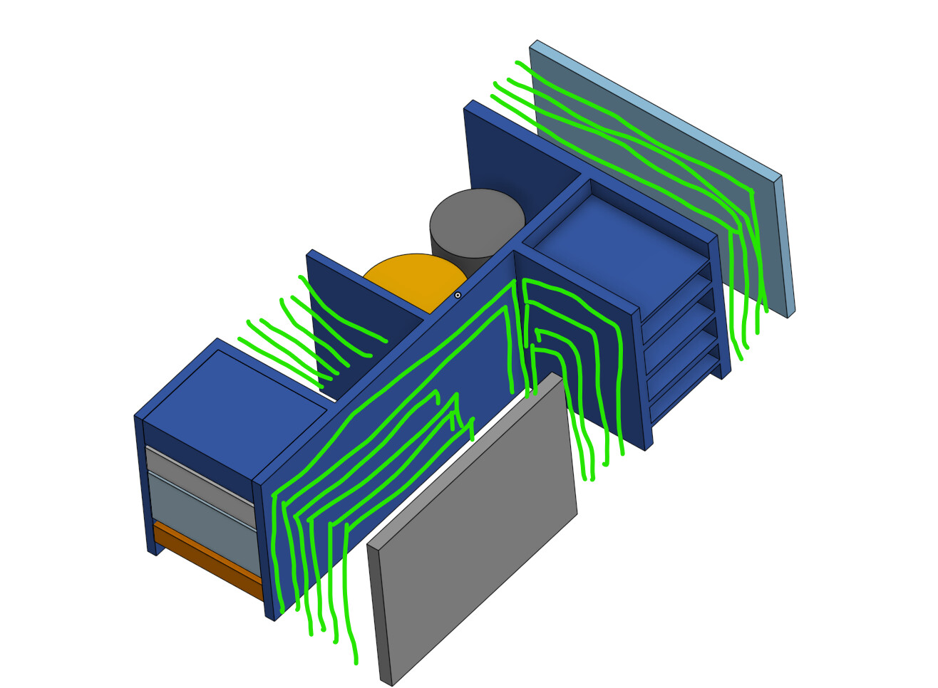

The difference between a full sized table and a 1/4 sheet…side access. The quarter sheet, you can reach the entire surface from 2 sides. The full sheet you need 3 side access.

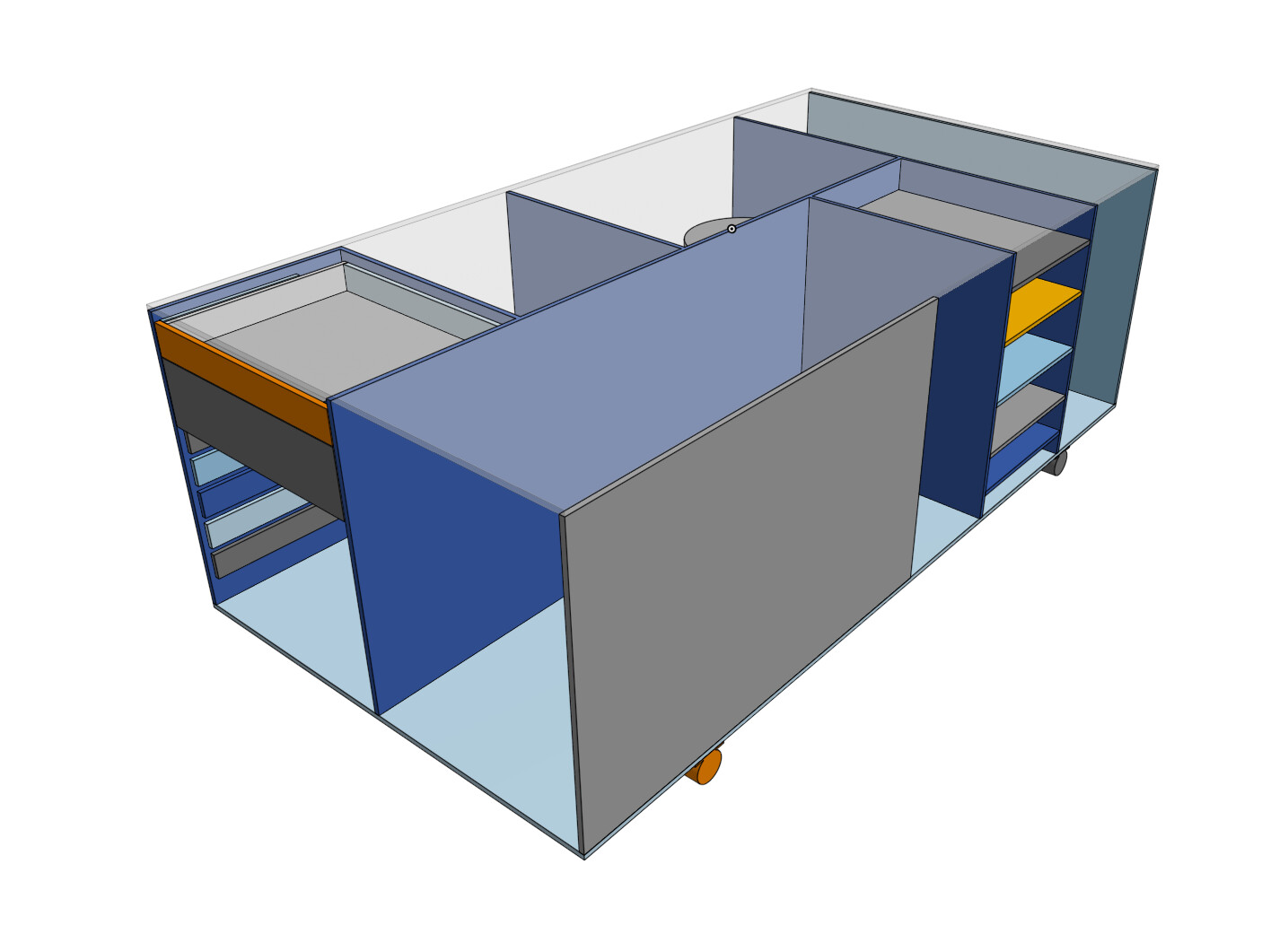

Drawers, vac and bucket, adjustable shelves for caddies, green is all material storage. I have a lot of scrap that might serve me better in one place nearest the machine that uses it. Drawers are at the front so the top one also serves as a desk surface when open.

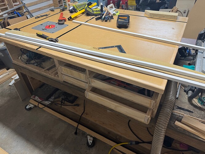

When I built the one for the LR3, now holding the LR4. I built it on top of cabinets. 3 down each side. With a 12” wide gap in the middle. So far 2 of the cabinets are filled with drawers. Best thing possible! Top one being only 2” deep and holds all my endmills. Not deep enough to lose stuff in lol. And the gap down the middle is perfect for storing longer boards out of the way.

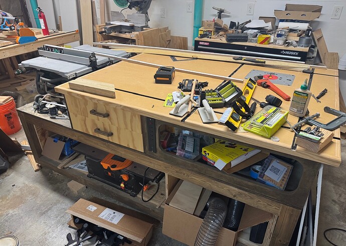

Here is my incomplete setup
Well, mine is more finished… but still uinfinished. I got the one to make my portable table saw more stable, and I needed a router table…
I didn’t want to close it all up until I got my automated dust collection all worked out, but that’s been on hold for about 2 years… and it’s been almost a year since I’ve used any tool back here at all… so it’s kind of a mess at the moment… We just keep stacking things all over…
but you can see my fancy bit storage that I did before I had a CNC so I had to layout the holes by hand and drill them all with a drill press… multiple drawers worth…
1/2", 1/4", and 1/8" hole options

Sliding drawers (single and double depth), container shelves on adjustable pins, no joints yet still playing with the feel of it. Still need a strong platform, 2x2’s? Hopefully cut out a lot of the inner panels and some of the top for drawer parts and stuff. No need for everything to be solid.
