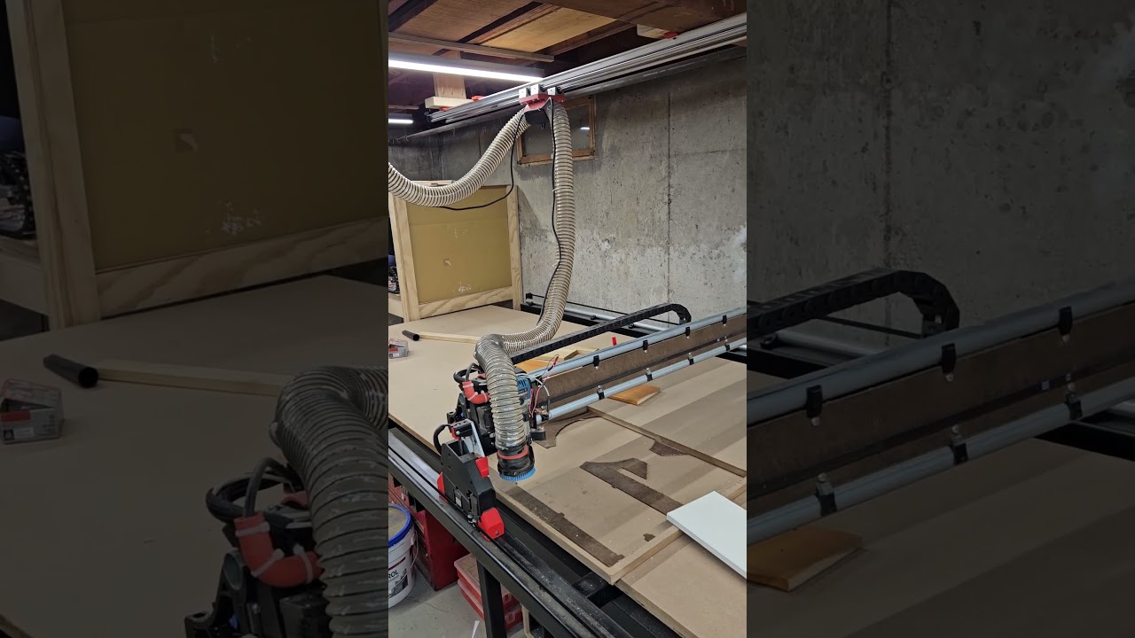

Well, I can tell you what mine is. Bear in mind that my table was designed for Lowrider v3 — and the extension wings on the side of a v3 are slightly different lengths than for v4. Basically the middle (work area) of the table is shifted on V4.
My table, full width from outside edge of Unistrut to outside edge of Unistrut is 58 1/8 inches, about 1475 mm. That works for EMT tubes cut to 1398 mm. Gantry would be, I think, half a mm more, so 1398.5. The center of my table is not quite in the optimal location because it was built for V3. Also I could’ve stood for my table to be maybe a quarter inch wider.
Doug’s awesome table design inspired my build. I built a stock lowrider 4. I wanted the metal rails so I used 2x3 square tubing for the extra width.
I’m going this route, with company pricing unistrut is cheaper than plywood and this will eventually be a plasma table anyway. Any reason not to use the full 10 foot for Y travel?
If you have the room, I don’t see why not.
No reason not to use the whole 10’. That is what I did on mine. I let the rails extend past the table so that if you want to mill the end of a work piece you can.
