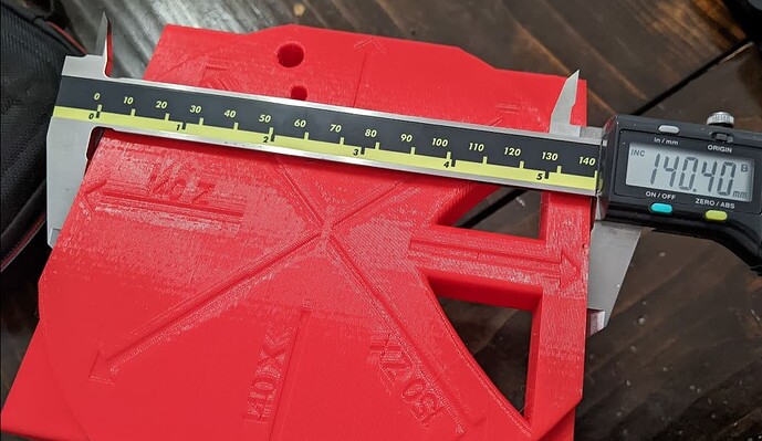

Ok. Printed the v1e calibration wall:
top is rough
Bottom has gaps
Sides have “features”
Some consistent bumps on the ZY face inside and outside. Maybe need to clean/lube the bearings or do something different with the wires to the hot end?
less pronounced patterns in the X , but there are some zits that appear to follow an arc - perhaps the infill intersection?
there is some ringing from the inset text and the horizontal holes aren’t quite round
ZX wall:
Height (140 mm): 140.4
X Dimension (140 mm): 139.53
Diagonal (150 mm): 149.58
ZY wall:
Height (140 mm): 140.58
X Dimension (140 mm): 140.02
Diagonal (150 mm): 149.97
Is this good enough to print trucks? I’m seriously at the edge of my understanding on this. the ringing could be a resonant vibration thing, but the repeating wall texture is not. the Y measurements are good, but the X are off a little and there might be some little bit of over extrusion. The base layer may be too thick. Not sure where to go from here. Thanks for any input or suggestions.
E or Z calibration.
I think that is just the infill you chose.
Yeah, I would guess nasty bearing. Lube it loosen and check all four of the bearing block screws. That is bad, make sure it rolls really smooth. It could be the infill, how many walls did you use? 3 and it should not show, 1 and it will show for sure.
accel tuning.
Happens with bridging, those are not super great though, maybe extruder temps or cooling fan.
For what? (Probably, might want to do a few more test prints first).
