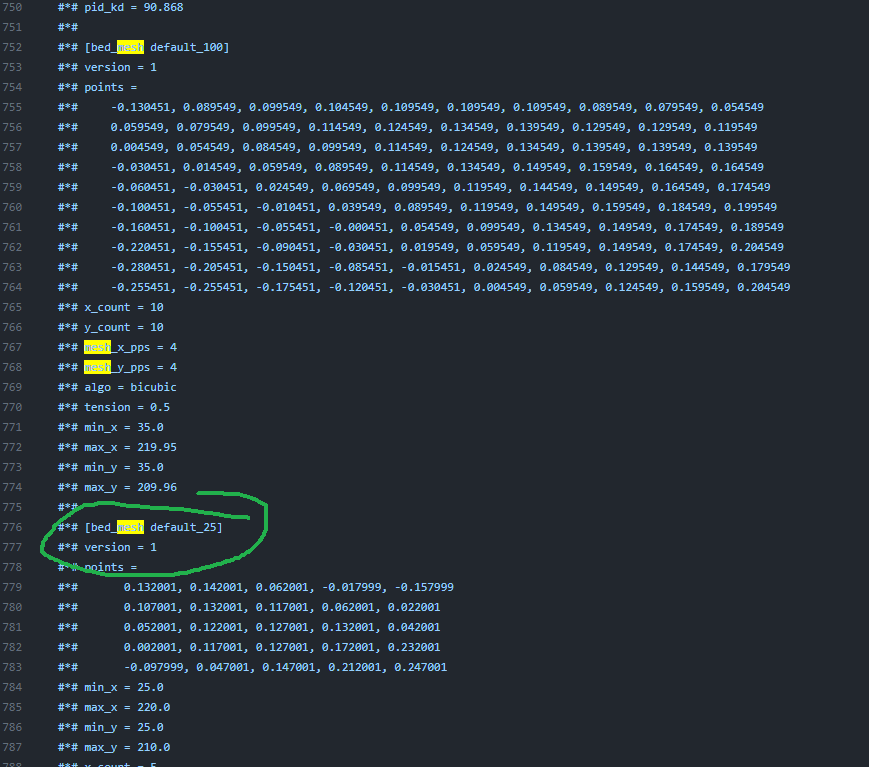

How do we incorporate a bed mesh? I had it measure one, but I don’t know how to have it load it or should it measure that each time?
Sure thing! Think we reference the mesh profile in START_PRINT macro.
Looks like I created and saved a 25 point mesh, and a higher fidelity 100 point mesh, but am only using the 25 point mesh :man_facepalming:. I should probably fix that, thanks for asking your question!
My Klipper config is @ https://github.com/aaronse/v1engineering-mods/blob/main/mp3dp-v4/klipper/printer.cfg
See Bed Mesh - Klipper documentation
I had named the 25 pt bed mesh something else and it was calling the wrong one.
