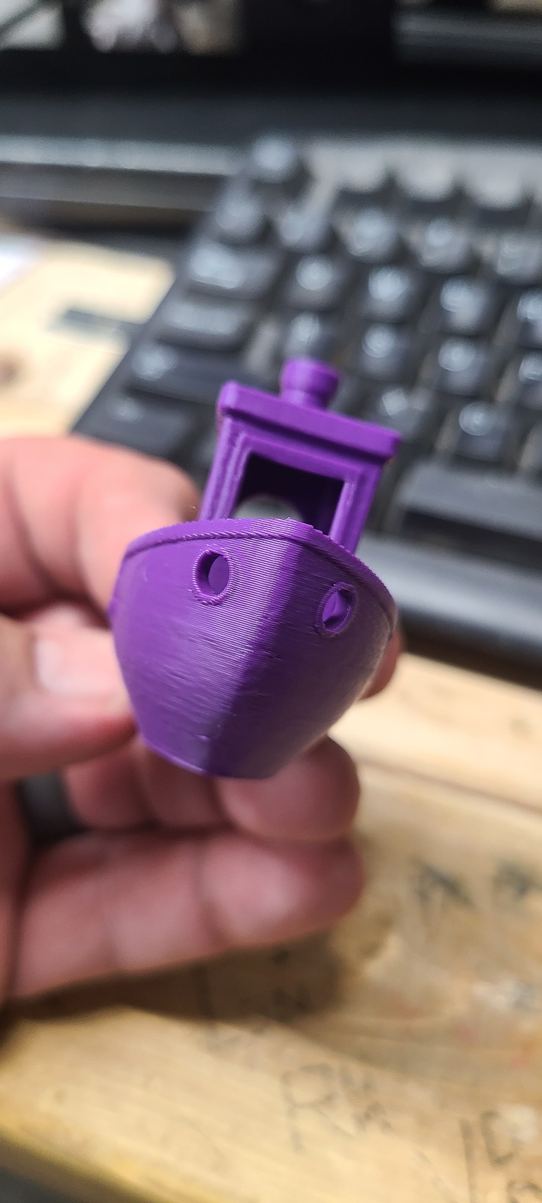

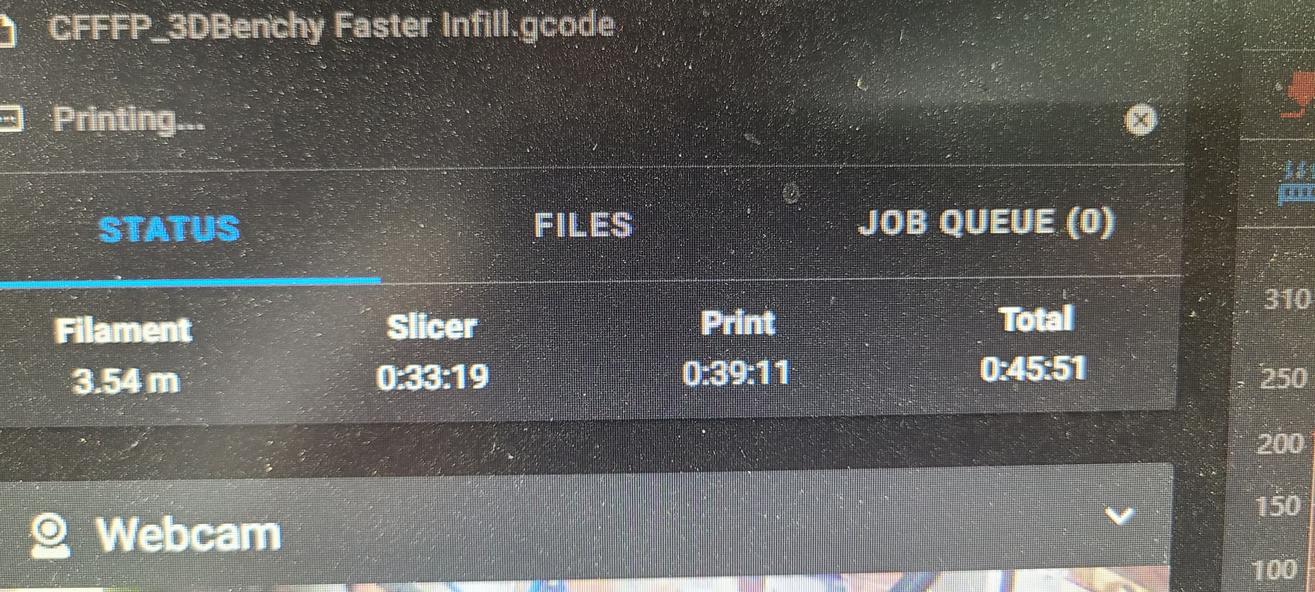

So… decided i needed to print a Benchy.
4000 acceleration and 200mm/s. No record but the quality is pretty damn good considering.
I saw flow rates in the 18mm³ range and the H2 REVO did not even slow down.
