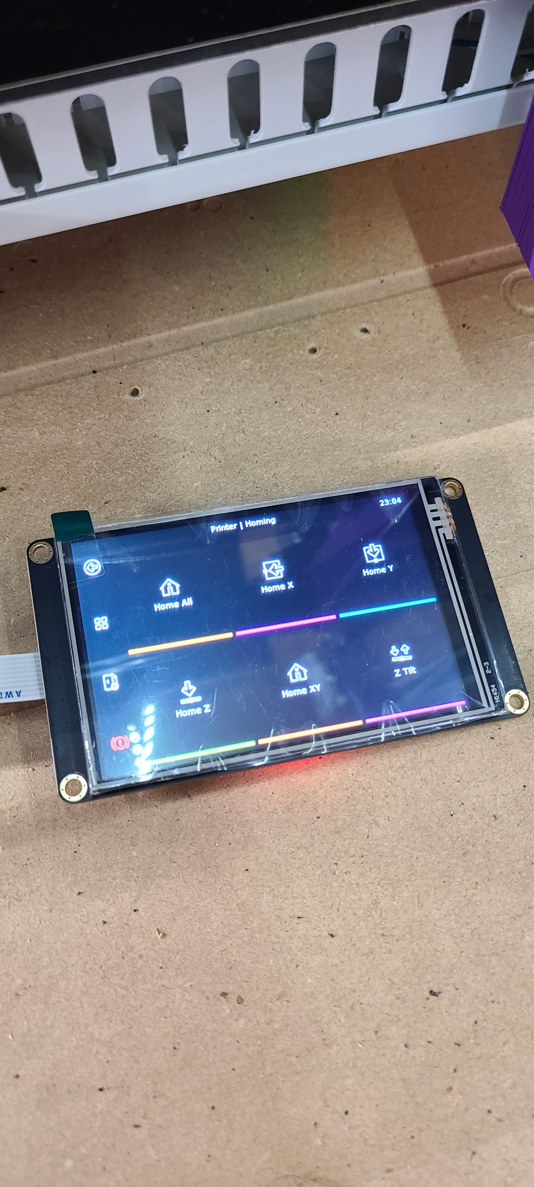

I also got the TFT35 SPI hooked up and running. Actually super easy. Had to uncomment one line in BoardEnv.txt and it came right up.
