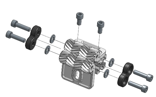

Am reprinting my 2020 corner panel clip hinges after recently discovering cause and fix for Wall Separation issue that impacted some of my recent printed parts, including the hinges. So…
Created better hinge, shared at Printables and GitHub :
  • Switch from M3 to use M5x30mm bolt (common for V1E builds)
  • Add 90 degree stop, with more material to help keep overall hinge rigid enough for 30N Struts. Trying 80% infill, 3 walls/top/bottom, 0.6mm nozzle, 0.32mm layers.

This stuck with me, makes sense, I appreciate the tip. This hinge isn’t a huge print, but am going to save as-is, then temporarily slice parts am unsure about into smaller printable parts to check fit.
23-08-06 Edit: Printing partial prototype helped quickly identify 4+ additional needed tweaks…
Installing/replacing hinges would’ve been easier without Struts installed. However… Post-it note spacer and small clamps helped line up, and hold extrusion while installing the new hinges.
This may already be shown, but… You’re running a bolt (or something) through as a hinge pin right?

Exactly! M5x30mm bolt with captured T-Nut, tweaked hinge holes to have varying diameters to help hinge rotate, but also grip bolt threads where made sense.
Need to figure out fancy pants front door/hinges/mounts/something… Suggestions appreciated!
Edit : Not sure if this herringbone gear hinge will work for my situation (remix of an original, has several sibling (?) remixes). Looks too cool to not try out though…
Edit #2 :
Printed 60% height so more compact, can use flanged M3 instead of M5 then to fasten to extrusion and panel. Not liking outside hinge, so tweaking and/or looking for alternative with inside hinge ideally, trying to keep front extrusion channels clear/empty...
23-08-09 Edit: Looking at various 2020 Hinges on Printables that’ll work given door and lighting setup am trying out. Selecting/making hinge after thinking through how lighting etched panels will work. Learned from others, and explored some ideas in this topic.
