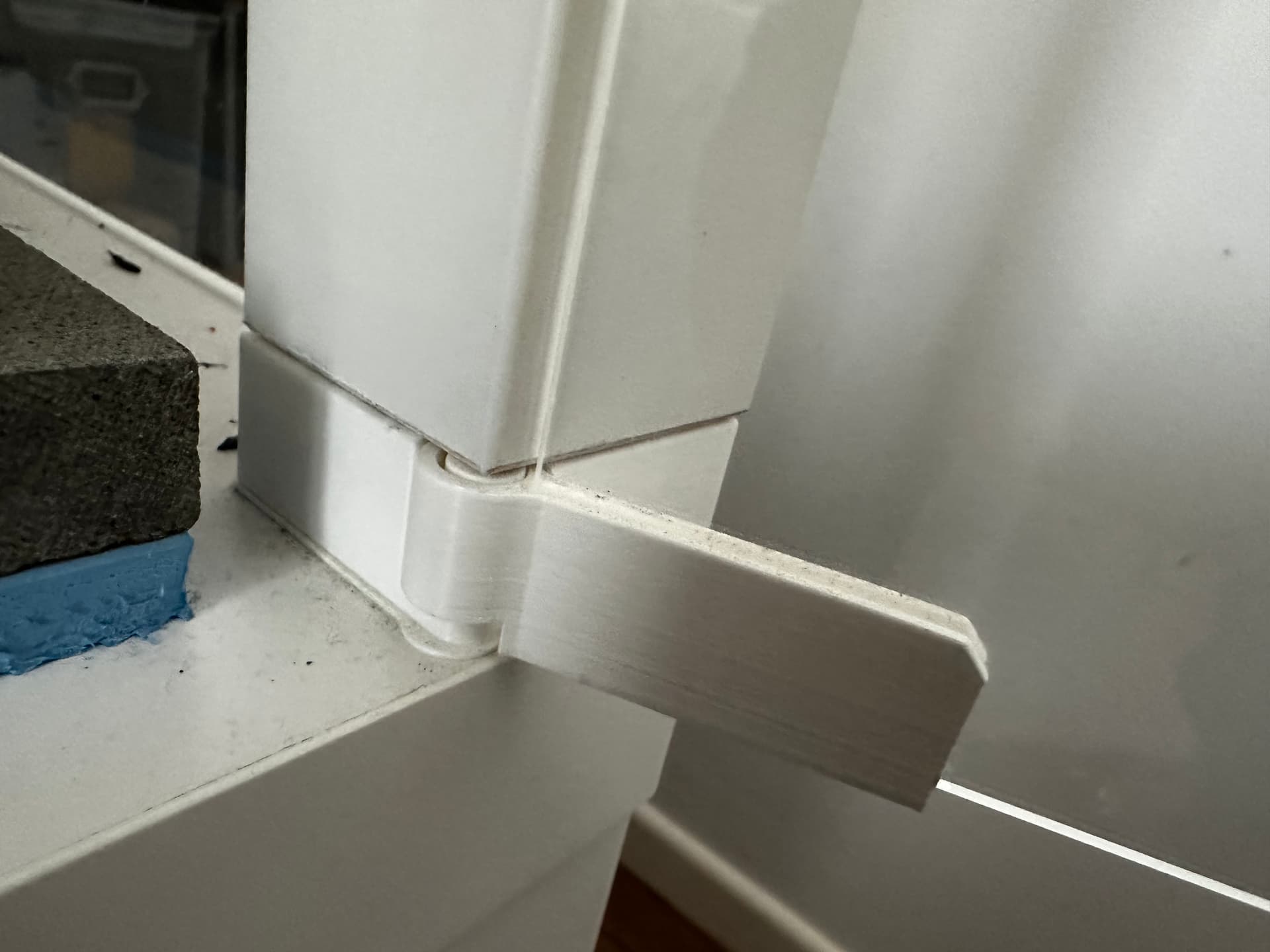

Assembly, panel corner clip hinge
Was looking for 2020 hinges that can also hold/protect 1/8" (3mm) panels attached to both the top lid panel, and bottom back panel. Hinges need to support Lid weight, and resist twisting/shear forces from the Gas Struts. Struts are currently 20N 4.4lb, still looking for 10N 2.2lb … 3D printed damper would be nice.
Looked at various designs, ended up forking a Voron Trident 2020 corner panel clip 4mm.
Modified by mirroring the corner clip, then added a stocky hinge large enough to capture T-Nut for the M3 x 30mm button head bolt. Intentionally left 1mm gap between top and bottom 2020 for foam/TPU seal to compress when Lid closes.
Print orientation doesn’t require support, but won’t be ideal strength, hopefully good enough…

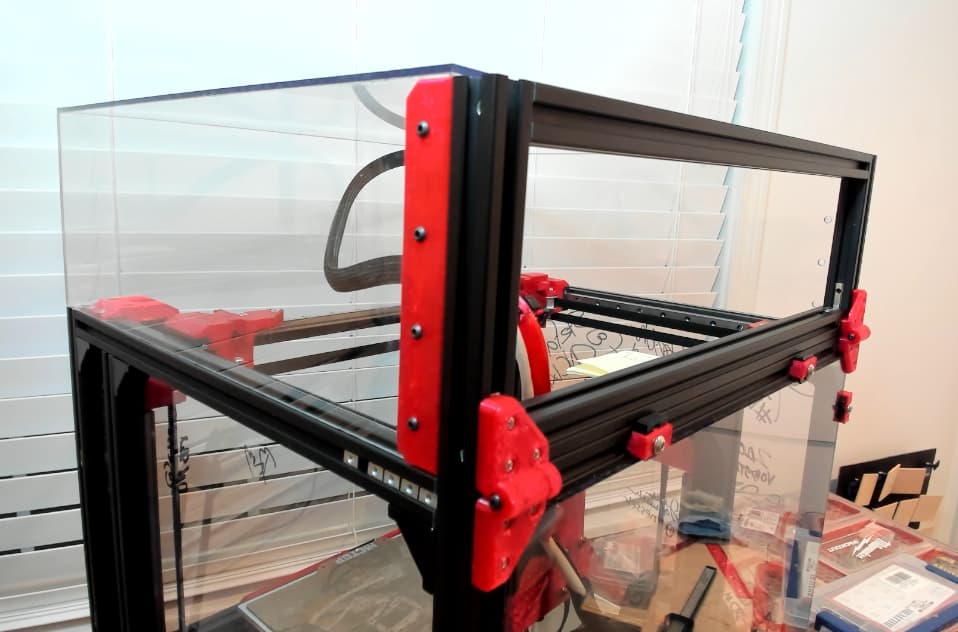

Assembly, Lid, fasten rear extrusion frame
Attached Panel Corner Clip Hinges to Lid’s 2020 rear frame assembly. Lid frame was fastened with blind joints.
2020 extrusion holes were too loose for M5 tap, but too tight for M6, so had to rebore with 13/64" (5.16mm) bit before M6 tap. No cutting fluid available, so used cooking oil instead, seemed to work
. Soaked/wiped up most of the oil, but didn’t degrease or threadlocker yet, am expecting more changes.
Hinges don’t have any adjustment slots, so had to precisely cut the extrusion in order for Lid and main body width to be exactly the same. Ideally would’ve batch cut Lid X extrusion at the same time main frame’s X extrusion is being cut. Had no idea build would end up here back then. Have ideas to workaround width mismatch between Lid and body, let me know if interested.

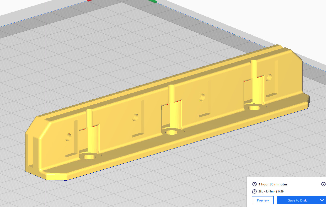

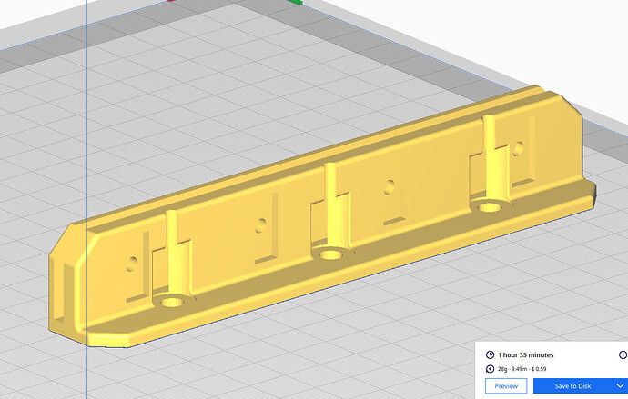

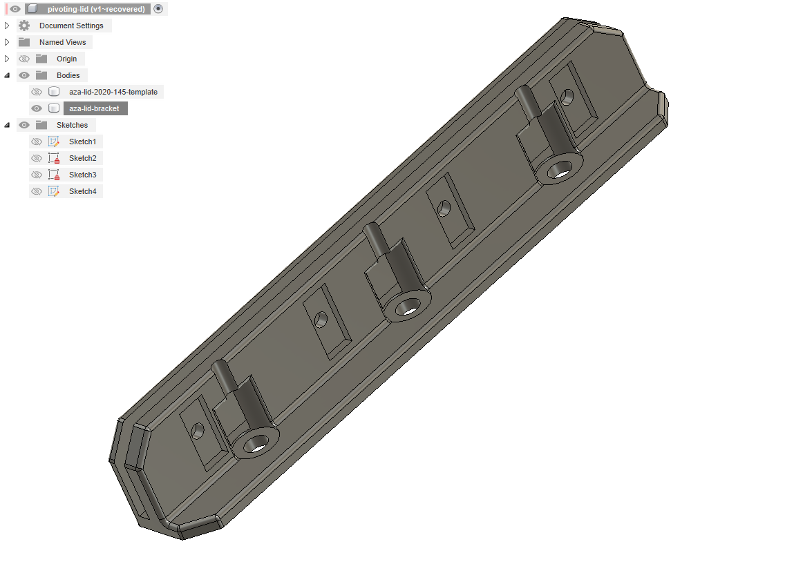

Assembly, Lid, mount polycarbonate to extrusion
Created Polycarbonate-to-extrusion bracket to design my way out of not having done big design up front. I failed to fully consider ideal lid dimensions upfront, or best way for lid to adjust, pivot and rest. Bracket design involved much fudgery. Can tell from my posts, but have been mostly agilely sprinting my way through this build, completely winging it, so am having to pay for some of my earlier myopic decisions.
PETG bracket squishes/compresses nicely, acts as a washer/shim preventing bolts from overly compressing and cracking polycarbonate when snugged up tight.
Parts
- 6x M5x8mm button head bolts
- 6x M5 slide-in nuts, or roll-in nuts.
- 8x M3x12mm button head bolts, ideally flanged.
- 8x M3 T-nuts

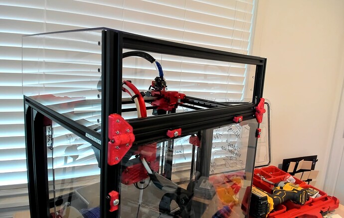

Assembly, Lid, Gas Struts for hold and slow close
Parts
- 2x 30N (7lb) Gas Struts. Remove spring metal clips and drill ~3.4mm holes, ping me if you’re at this point and need details.
- 4x M3x16mm button head bolts, ideally flanged.
- 4x M3 Slide-in nuts ideally. Maybe roll-in, but not T-Nuts.
- 4x M3 Nuts to secure M3 Bolts to Gas Strut end.
Edit 1: Tried 40N (10lb) on just one side (20N on the other), this results in Lid holding position at any angle. Definitely an improvement over 2x 20N Struts which drop too fast when Lid is < 45 degs from horizontal. However…
Look at Orange circle in the pic, unfortunately the printed hinge isn’t strong enough to resist entire Lid being lifted up ~3mm
So, am reverting back to 20N Struts on both sides until if/when more rigid hinges are being used. Maybe regular metal 2020 to 2020 hinges with small plates that will clear the panels, or, mount regular metal 2020 hinge on 4mm thick printed packer/spacer for panel to slip under. Using separate printed regular corner panel clips.
Edit 2: Ideally Struts would be inside the lid, making for a cleaner exterior. Am having to work on some other stuff for a while. So…
A Beer/Coffee bounty, and bragging rights awaits anyone who comes up with model(s) I can print that will enable Gas Strut to be mounted internally (and not tear Lid apart). Welcome to mod the parts am using currently if that helps. Something that mounts the Strut here maybe…
Edit 3: Settled on 30N. They’re strong enough to hold Lid open > 30 deg. Lid closes at exactly the right speed I wanted, silky smooth descent. Strut strength was trial and error matched to the weight of my Lid consisting of 1/8" Panels. Also tried 20N and 40N, but 30N was right for my build.
