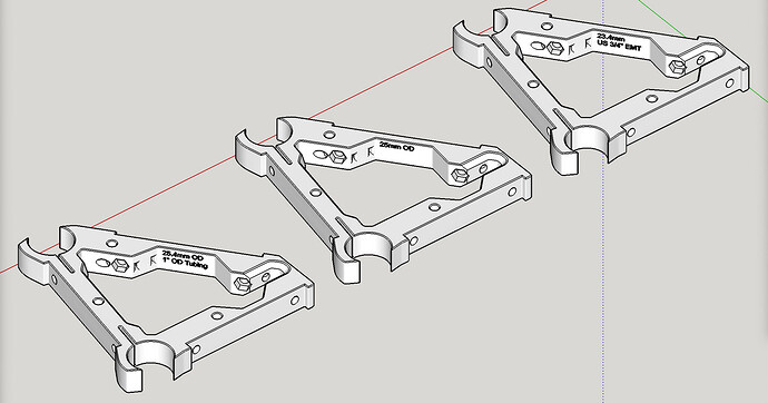

Nut capture slots are a mixed bag on whether they are good or bad. I have usually seen them hold for one use, but become problematic on instances where you need to loosen and remove screws to redo something, and re-insert again a 2nd or 3rd time. One thing: if you get them working right, don’t over tighten them or you risk “spinning” the nut in the slot and then it never works right again. At that point having no capture slot is better than a ruined one!
PS: I think I remixed the brace to have capture slots on all the screw holes instead of just one side. I was mixed on whether it’s better or worse, but lean slightly toward that it was better. :slight_smile:
PPS: The above note is based on the fact that I have built two LR3’s and the remixed braces were on the second one. :slight_smile:
LowRider 3 CNC - braces for gantry remixed to have nut capture slots on all holes! (v1.0)
Here’s a link to the Printables listing of the remixed braces with nut capture slots on all three directions:
