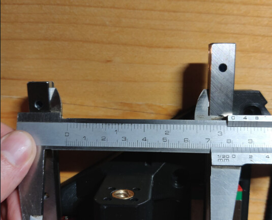

I’m assembling the XZ plates at the moment and found out (as instructed) that my parallel rails aren’t parallel. They have 1mm difference in the maximums (top compared to the bottom) which I think is not tolerable.

I am attaching pictures. That will be easier.
This is top:
And this bottom:
Follow the steps in the instructions. Put the XZ plate on and use it to square the rails, then snug them. LowRider CNC V3 - V1 Engineering Documentation

Wow! An analog (Vernier) caliper! I haven’t seen one of those for some time…

I did as instructed and when the screws on the XZ plate are loose, it works smoothly. When I snug them, it’s very tight and moves with a lot of friction.
I have noticed that the XZ plates are probably cupped from the printing, as if it would move the top direction from the print bed.
Do I reprint them? Most likely… right? When I use higher bed temp, will it stick better?
