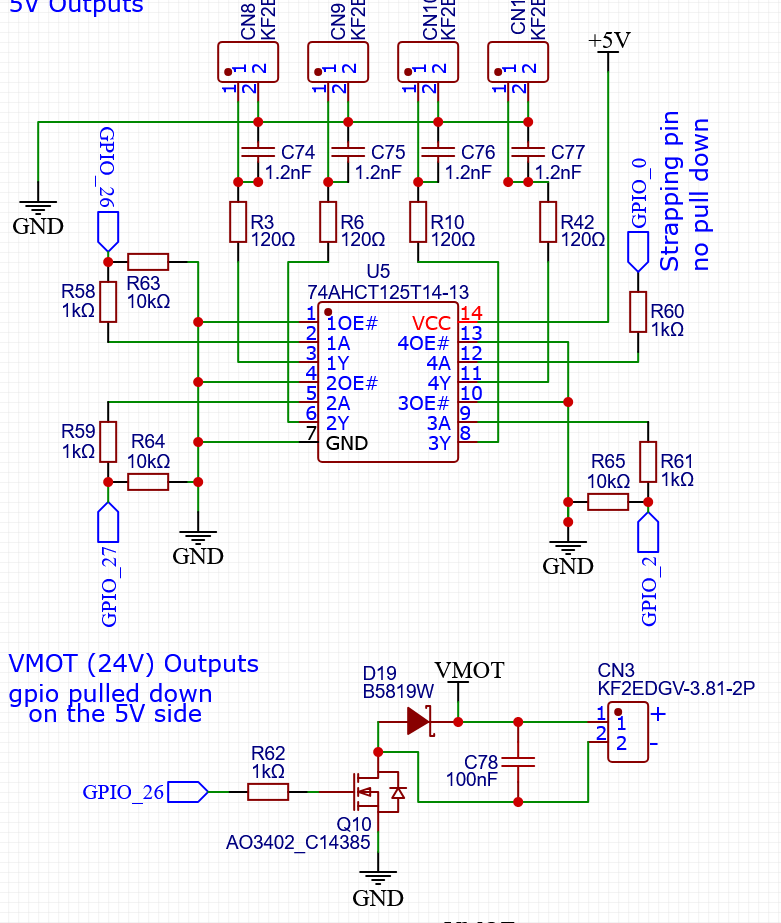

I think that is what you meant. I used 120ohm and 1.2nF since they are already being used elsewhere in the board.

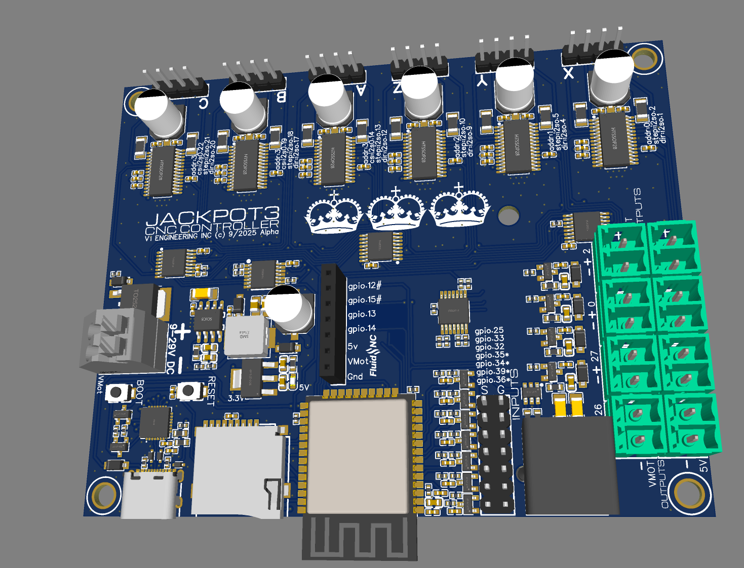

Well, I think it all fits. Not finished but that is every component placed. Still need to swap the input port to match the outputs. The standard modules fit with a little room before the 24v outputs, that 24v plug nearest the rj11 socket is the most worrisome but I think it clears.
Any chance those output connectors are available in a 2nd colour?
What are those output connectors?
At first I thought you meant horizontally with respect to the components on the board.

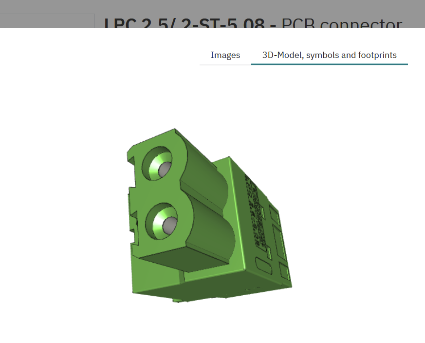

Or have you confirmed that the Pheonix connector height on the board is at least as tall as the RJ12 housing so that the Pheonix connector plug clears with its overhang?
Sometimes you can get black, I will when I can.
KF2EDGV-3.81-2P | Cixi Kefa Elec | Price | In Stock | LCSC Electronics, there are different angle plugs for them. The plugs are also available in the good clamp style and the wedge pinch style. vertical and 90 options as well.
I am not sure if they are inter-compatible. I can buy some and check but it looks like LCSC doesn’t sell them. It is only the one plug that is close and the regular generic plugs should fit. There is no more room unless I move the USB, SD card, esp32, and inputs. I really don’t want to do that.
they are shorter.
These will not fit.
looks ike the 1,5 version might.
Here is the generic version, KF2EDGKD-2.5-2P | Cixi Kefa Elec | Price | In Stock | LCSC Electronics .

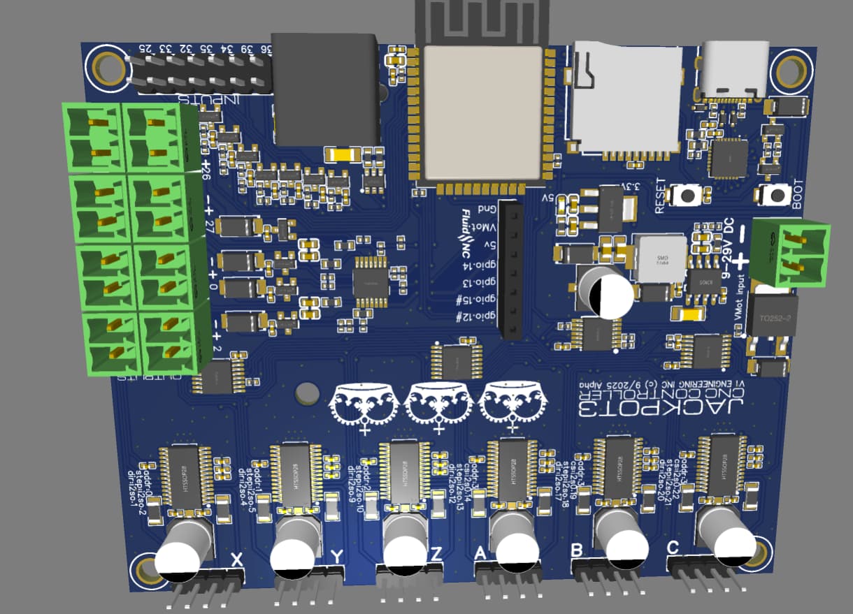

I just got everything to fit, but the input components look Janky.
That looks too dense to me.
I’m not convinced about the output connectors either.
yeah, I am going to see if I can spread it out al all.
I have another bag of sample coming Tuesday to verify.
So many hours pushing and rotating things around. These are the black plug blocks, no idea why they are green here.
