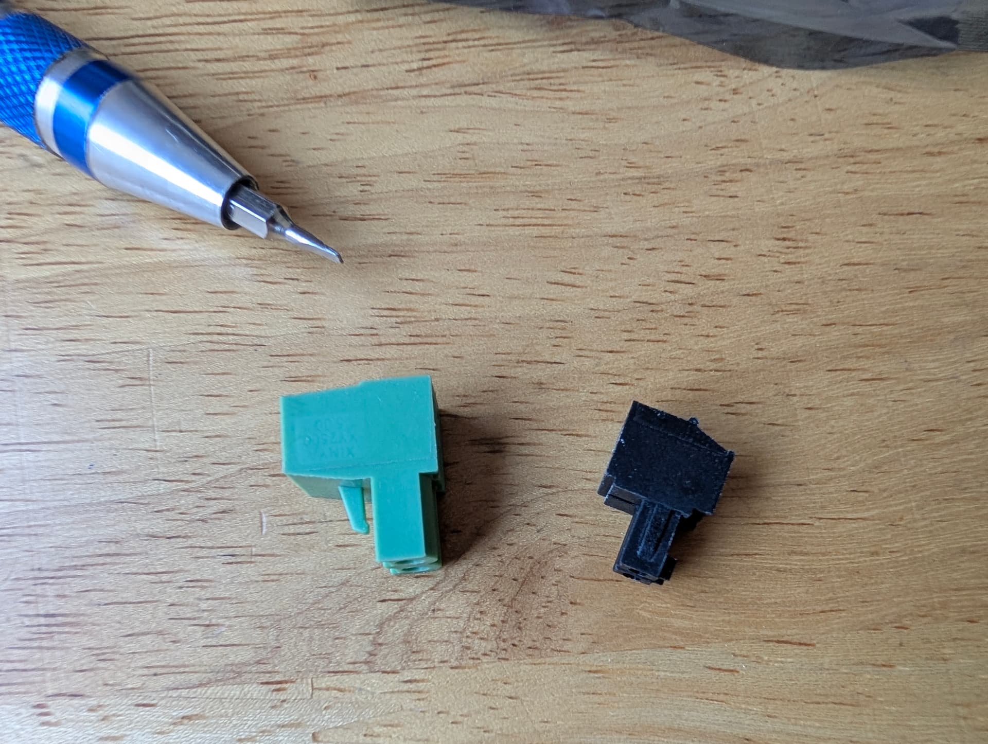

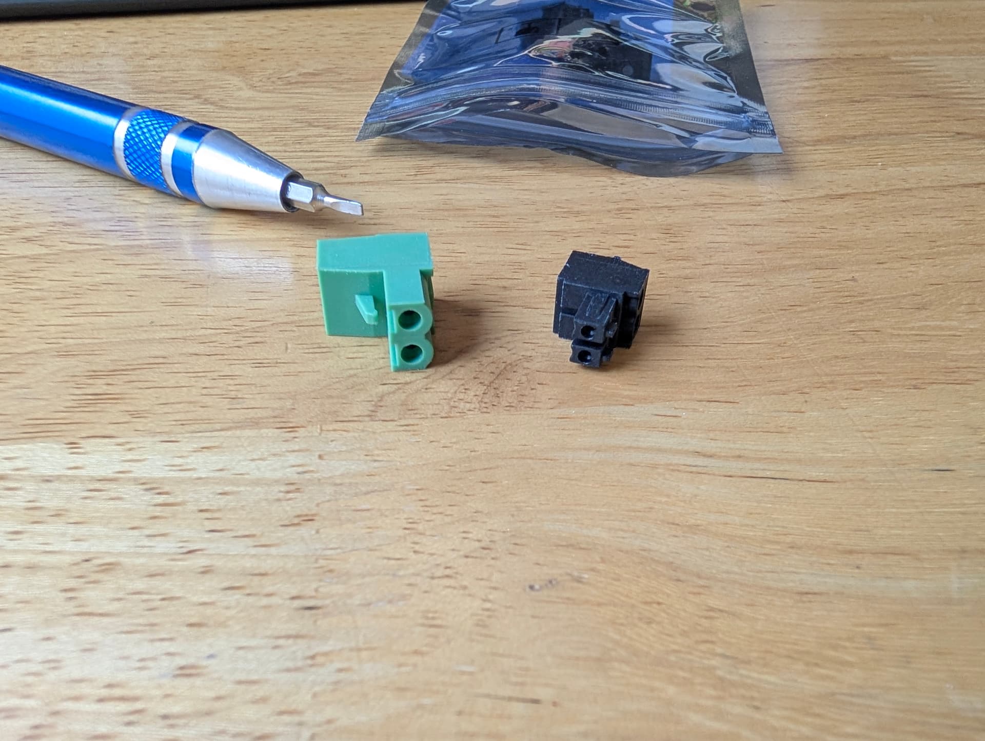

Hmm, interesting idea. I am not sure if I can actually get the black ones without buying a full quantity of them. So it is a giant, maybe. I used them here because the footprint is just a hair bigger, so both will work If I want to swap them.
Yeah, just barely. That blocks a lot of the antenna and the mount screws would need to be small enough not to get in the way.

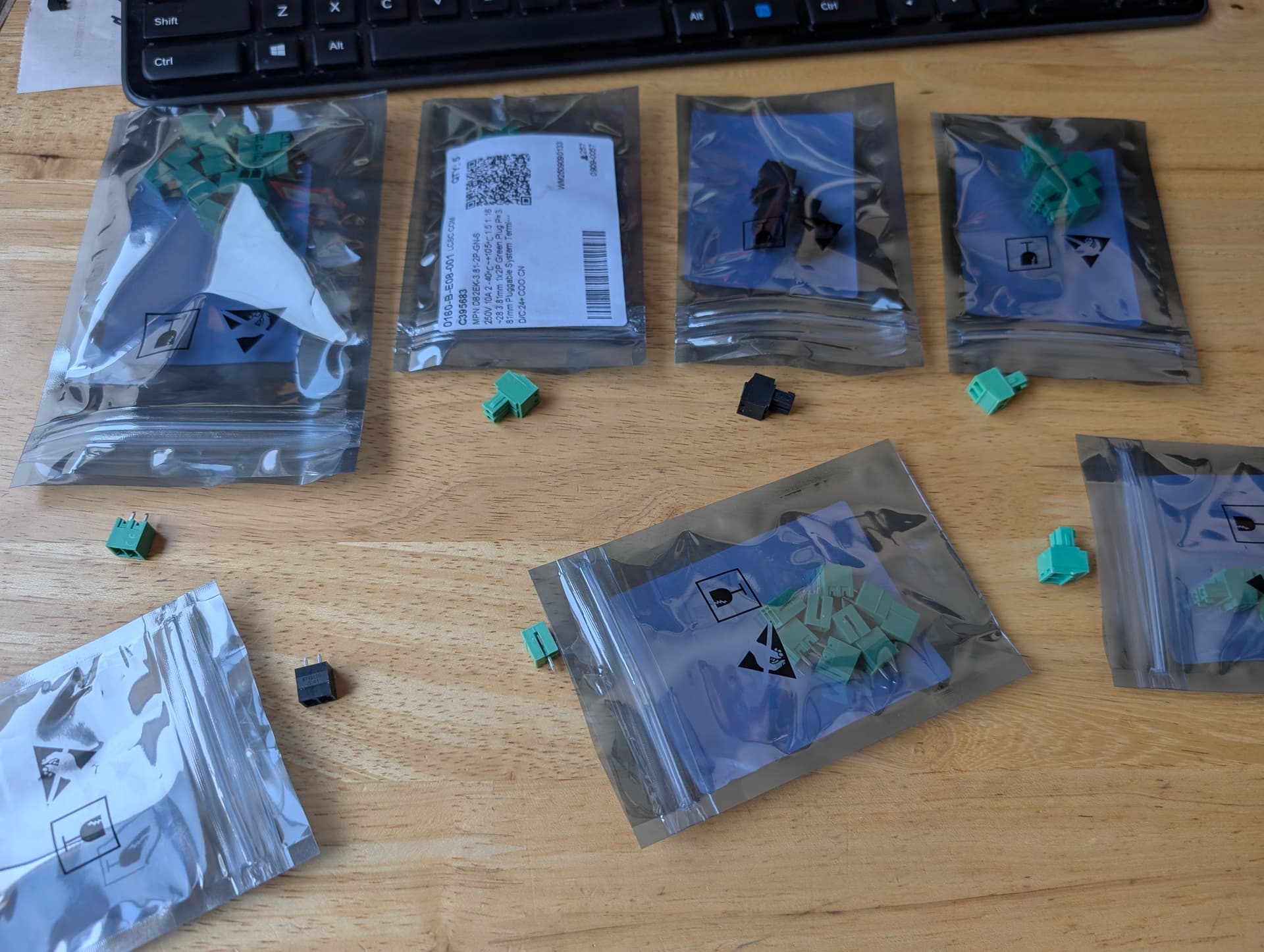

Unless there are any objections/comments, I will order a couple samples tonight.

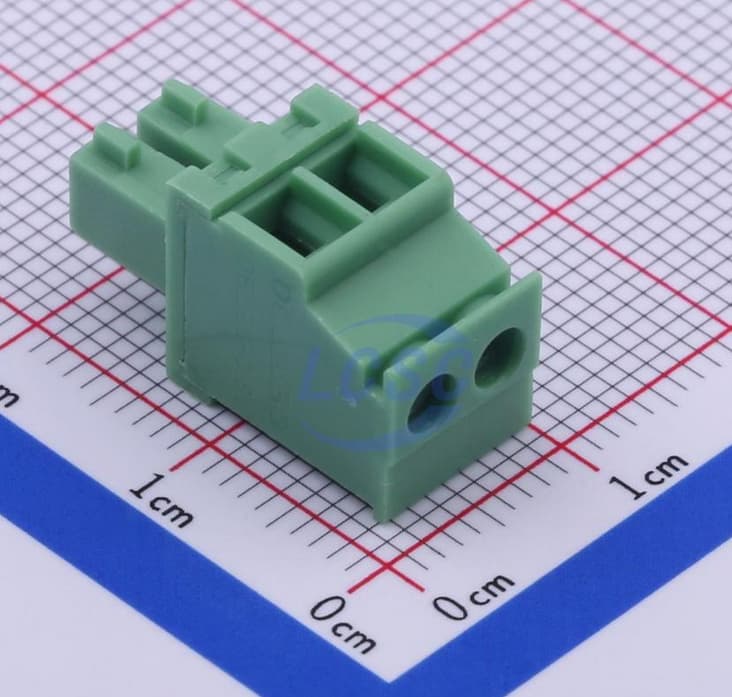

If we have to use plugs, I really like these plugs. Smaller than the old molex style, wire clamps are great, and the plugs are tight but not too tight.
I would prefer the wires to exit at the 90 degree angle but they seem to be a lot bigger, they do have some in push button though. DB2EKD-3.81-2P-BK | DORABO | Price | In Stock | LCSC Electronics
Dorabo, 3.81pitch.
what size wires do they accommodate?
Happy with the cost and clearances within the printed enclosure when everything’s wired and connected?
Sorry if people explained already, if the wires need to be manually fed into the connectors, then, am curious how this overall solution ends up better than regular 3.5mm or 5mm pitch screw terminal blocks?

16~28 I think it is wider than that.
320V 8A
They are shorter than the JP1 and heatsinks, including wires.
The socket and plug are 1.5mm taller that the jp1 uart headers on the drivers. So smaller than they look.
When you use the screw to clamp the wires you are not torquing the solder joint, and plugs mean you are not fishing wires around the side of the board.

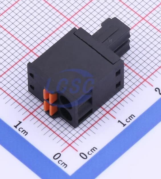

Serious comment: I like the ones you can screw in. Those push thingies are finicky.
Yeah, the push ones are way too stiff and very expensive in comparison.
As for the screw terminals, these have like the elevator box that moves, I really prefer these, super easy firm grip wide opening. The ones on the JP1 are the screw that pushes the metal sheet wedge, those were easy to miss a wire and people would really crank them down, then they would not open back up right.

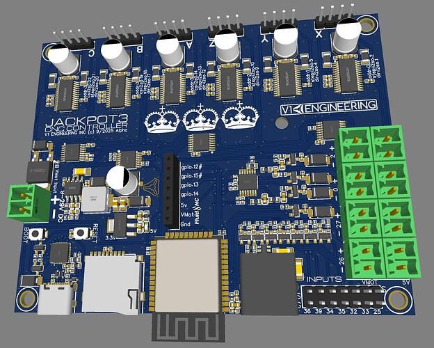

It looks like these will only fit one at a time on any given output (e.g. VMOT or 5V) dure to interference. That’s certainly fine as you’d only want a single output voltage for any given output.
Do they fit side-by-side without interference?
(Can you put a full set of VMOT all along the edge without interference across them?).
Do the lock tabs interfere with the VMOT connectors when installing to the edge (5V position?)

So the idea here is that you’re only ever using the ‘top’ or ‘bottom’ row of those headers, right? The plug overhangs the housing in both directions. With most of the series I’ve used before having them side by side like that should be fine, though.
There are a couple of companies that do their own version of those headers, I think Phoenix was one of them, but the style shown there is by far the most common in my experience. The LPC series mentioned above should cross-mate perfectly fine.
Which pitch are you using? The one pictured is the 5.08mm where you have 3.81mm pitch on the PCB. The 3.81mm pitch version of the LPC should fit fine.
Rising cage terminals. That’s why I use them and recommend them. They work well with stranded wire, solid wire, ferrules, multiple wires in one terminal etc. The falling foot or bare screw terminals are infinitely worse. I’m still kinda unconvinced by the wago style terminals. The good ones are great, the cheap ones are kinda finnicky.
They should do, in my experience. They might take pliers to get in and out, but usually the plug doesn’t overhang the header. We had them side by side like that within 0.5mm of touching on our control boards at the last job.
That’s a fair question, for sure. The main draw in the applications I’ve used them in before is that you can unplug them to replace the board, take it away to modify it, flash it etc. or even just unplug something to disable it temporarily. Aside from that, it’s a lot easier to wire things up when you can have the wire and plug separate and then just plug it into place, especially if you’re working in a tight enclosure. Where possible you’re always better off making wire harnesses separately and then assembly is just plugging things together, it’s much easier to be neat, tidy and ensure things like all strands are in the housings etc. As Ryan says, you’re also putting all the force into the housing itself as well, not into the solder joints. And, worst case, you just leave the plug in and treat it as a screw terminal anyway, which is what we do sometimes, although I generally try to avoid having headers vertical on the PCB like that, I much prefer the right-angle headers aligned along the edge of the board, that does tend to set/grow your board size quite often, though. Lastly, often PCB mounted screw terminals are a lot crapper than the terminals in these plugs, the plugs are almost always rising cage type where cheap PCB screw terminals can be a really mixed bag and are often the ‘falling foot’ type just due to how they need to be made to stay compact and have a pin coming out the bottom.

These do not have lock tabs.
:rofl:
Yes. No way to use both at the same time. Just in case someone wanted to try.
Yeah as I dug further down the list I eventually saw the right ones. Fany phoenix are an option!
I figured they had a name. These seem to be the best screw terminals I have used.
Yeah, they’re by far the best in my experience. We usually don’t even use the expensive phoenix ones or whatever. We had a stock of Wurth ones from way back but I think any stuff I order personally is On Shore Technology from Digikey. Presumably any of the Chinese suppliers will be similar.

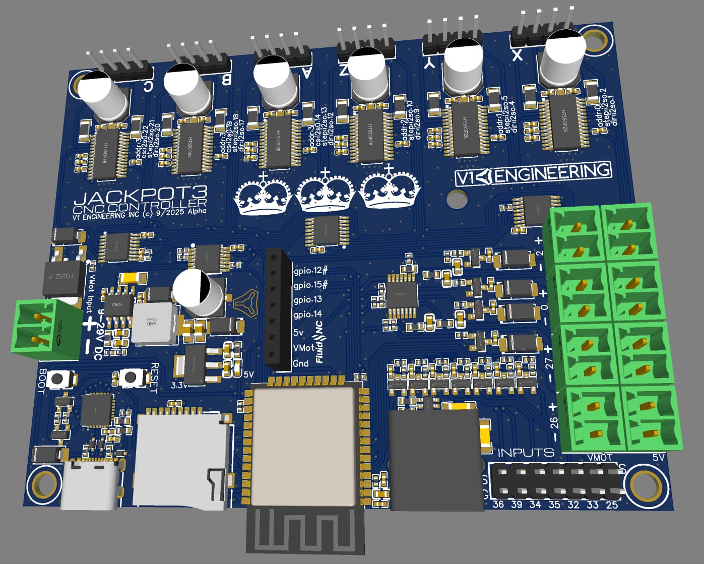

Some schematic feedback. If you’ve got a link to it I can make a copy, shuffle things around and show how I’d lay it out.
The main this is to try make things look like what they are. For example:
That doesn’t look like a pull-down. At first glance, it looks like GPIO_26 is controlling nOE for channels 1 and 2. I put a LOT of effort into making things ‘look’ right, because then it’s much easier to look at something and see an issue where something hasn’t been connected correctly etc.
I try to never use ‘rails’ for power ports/GND/0V reference ports like that, as well. The point of using the power ports is that they make the schematic easier to read by having less lines crossing places, they have less chance of things getting cross-connected and give you a mental ‘stopping’ point where you don’t have to think beyond that.
I would also always try to avoid current flowing ‘up’, such as where you have the filter caps connected to GND at the top. It makes no difference, technically, but because it looks wrong that’s where my eye is drawn, meaning I’m spending more time figuring out what that piece is using logic and not the ‘pattern recognition’ part of my brain.
I also like to avoid 4-way intersections in wires where possible because it’s hard to tell if that’s deliberate or not. It’s usually easy to avoid them by just moving connections slightly.
I agree for sure. There are a few things I would like to shuffle around. I noticed I had a harder time laying things out because the schematic was so different from the real board.
That whole 5V section was irritating because of how I did that. Inputs come in from one side and outputs out the other, That would have helped with my layouts.
