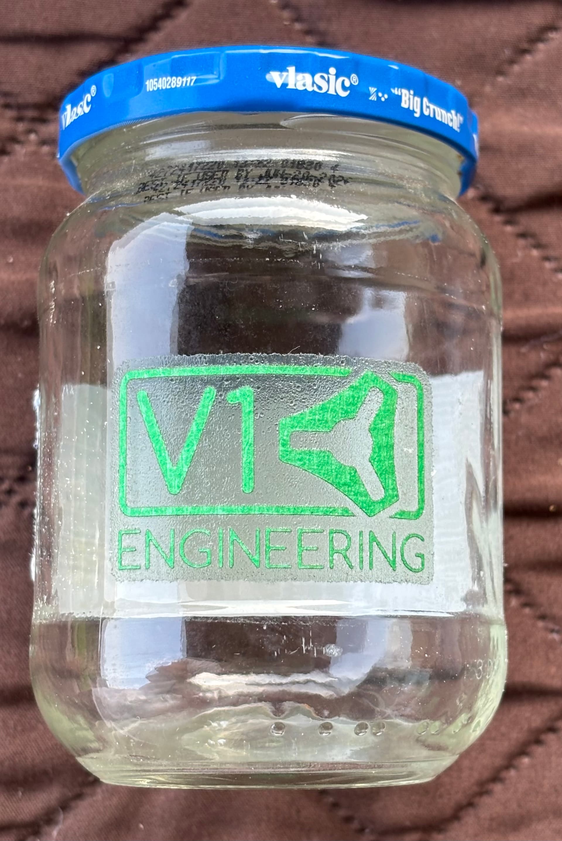

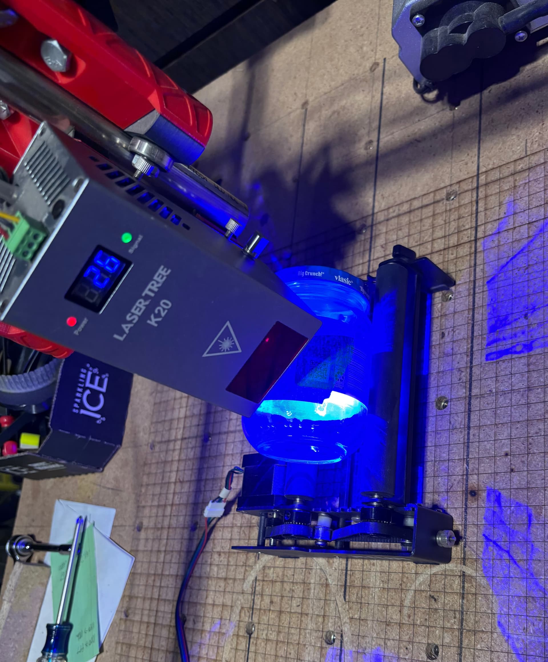

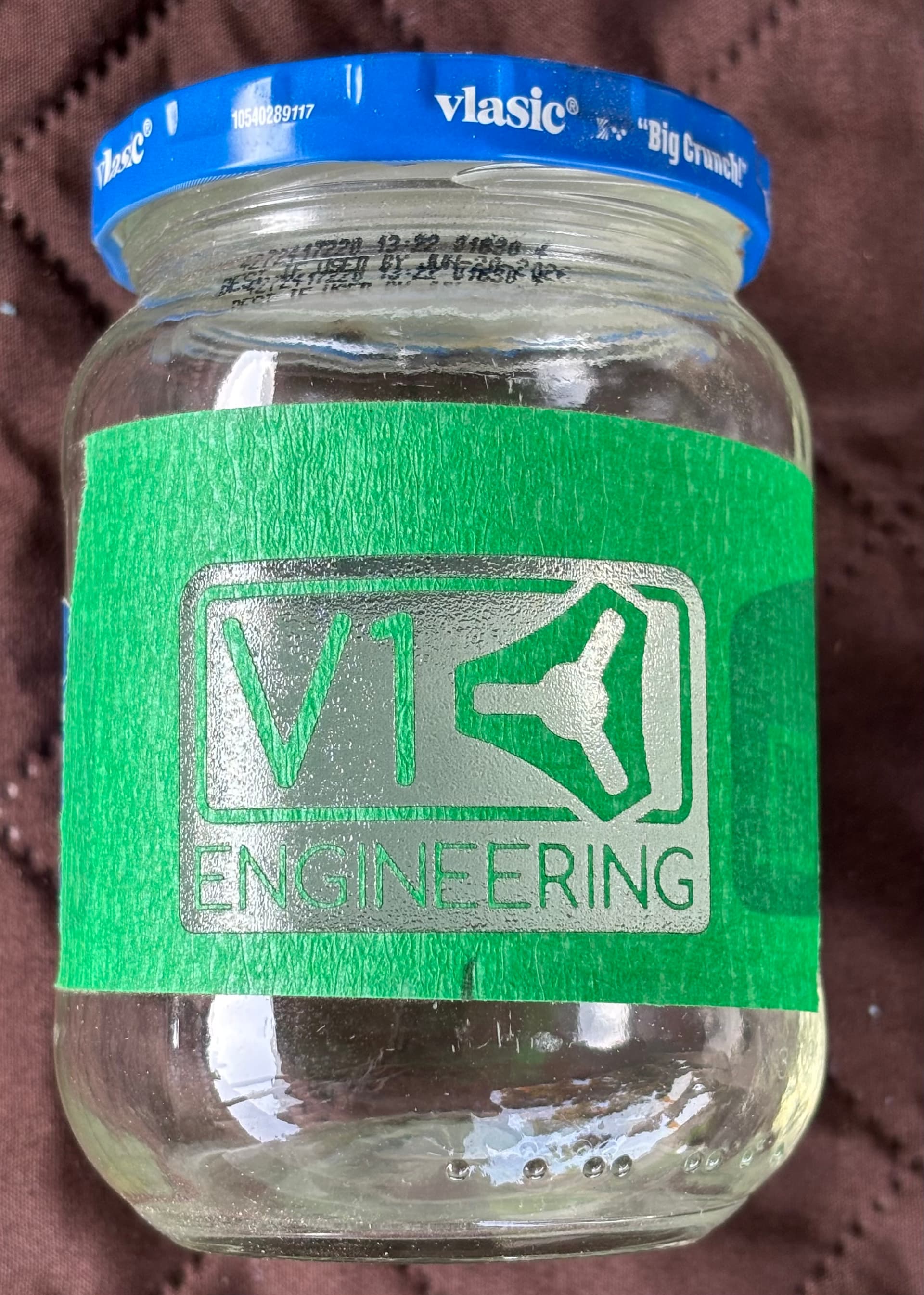

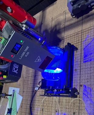

The rotary test came out great too.
Wow. So are you hooking up the rotary axis to the “C” port, or just swapping out X or Y?
I think you are my new test guru if you are using all 6 ports!
Thanks Ryan.
I have the rotary hooked up to the “A” port. Lightburn uses the A axis for the rotary. I have the “C” port assigned to my X motor 1.
I forgot to mention that I also have my CYD pendant connected to the JP3.
Ah, I have the same rotary axis in the cupboard, I must try that.
