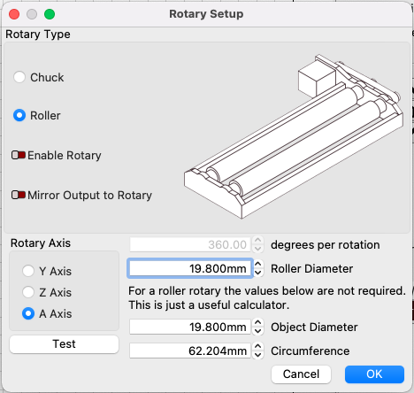

Lightburn rotary settings:

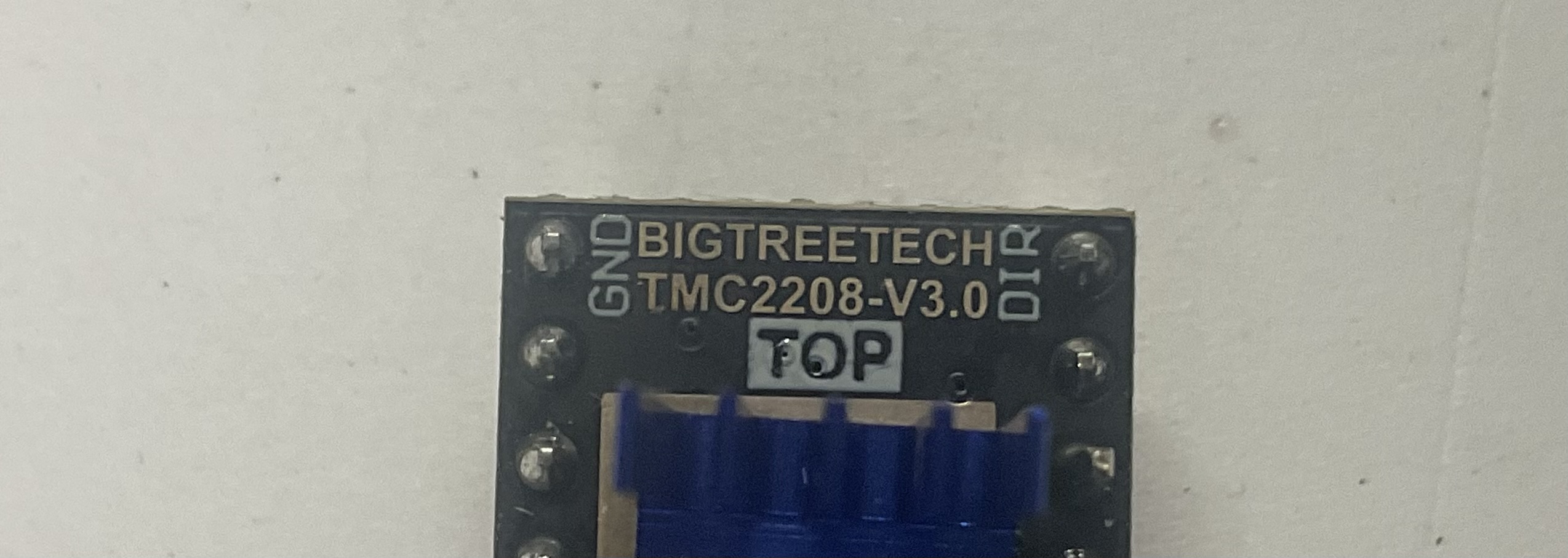

Driver is here and I’ve put into the remaining slot - C on the board.
[MSG:ERR: A Axis TMC driver not detected - expected 0x21 got 0x0]
Any ideas?

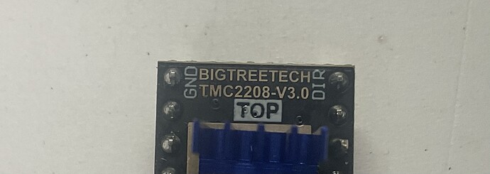

never mind. Found the problem. :weary_face:
Another donation to the parts pile. :frowning:
Bummer! I hope it wasn’t very much.
Nah, just annoying. Ordered another but it’ll not be here till the weekend.
I had a 2208 in my parts bin somehow (I have no idea how it got there; I only order 2209s at this point.). Kicked my butt for days before I found it. You got it rather quickly :slight_smile:
Perfect example of the 3 golden rules of troubleshooting:
Don’t trust anything
(how do I know the driver itself isn’t faulty)
Try the easiest thing first
(Put it in a known good configured slot - still doesn’t work)
It’s probably user error
(Ordered the wrong one)
Progress. the new stepper arrived, installed and now:
[MSG:INFO: A Axis driver test passed]
I tried enabling rotary mode in lightburn and using the Test button and the Stepper just shuddered, so somethings not quite right but getting closer
