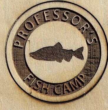

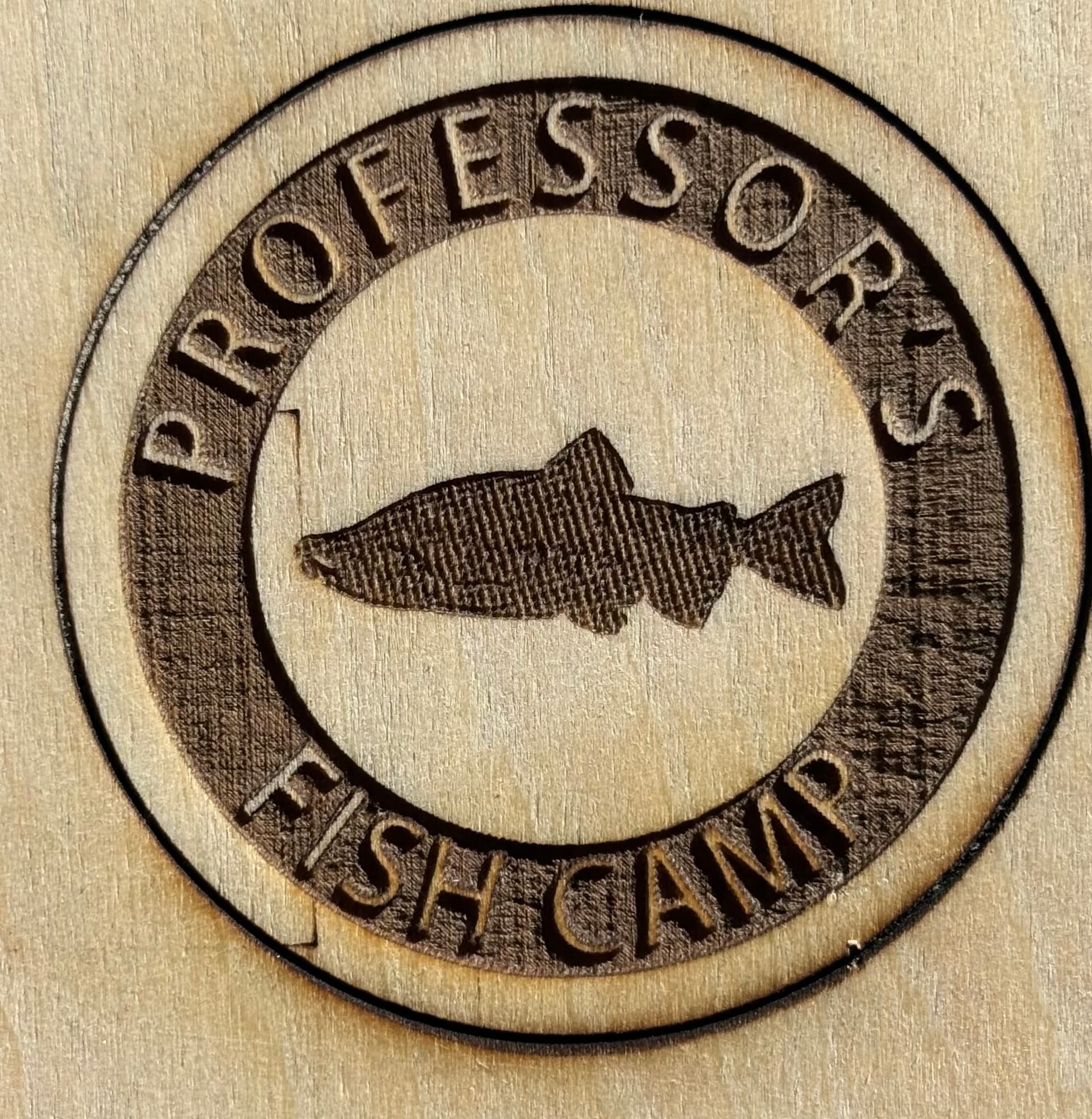

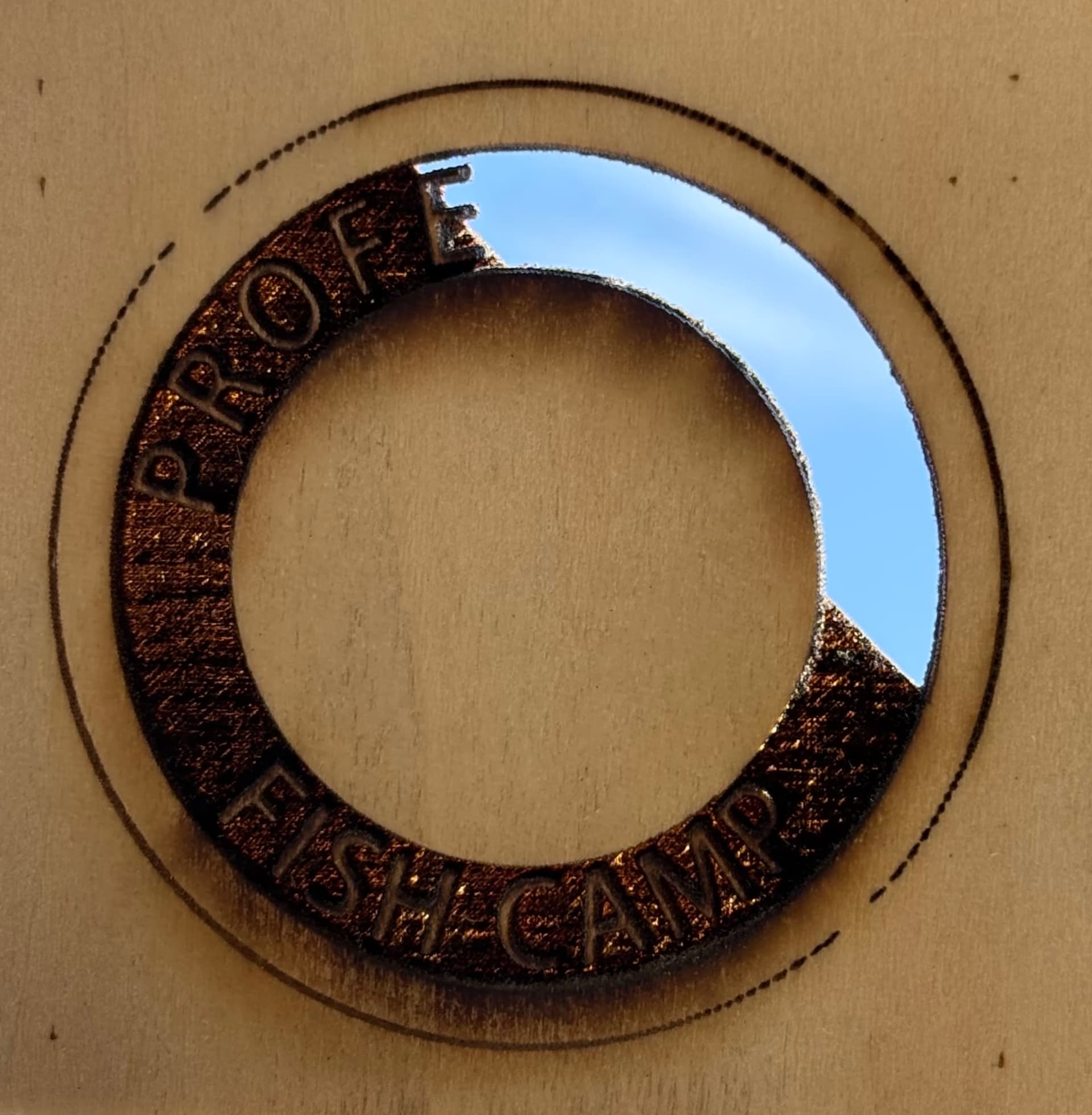

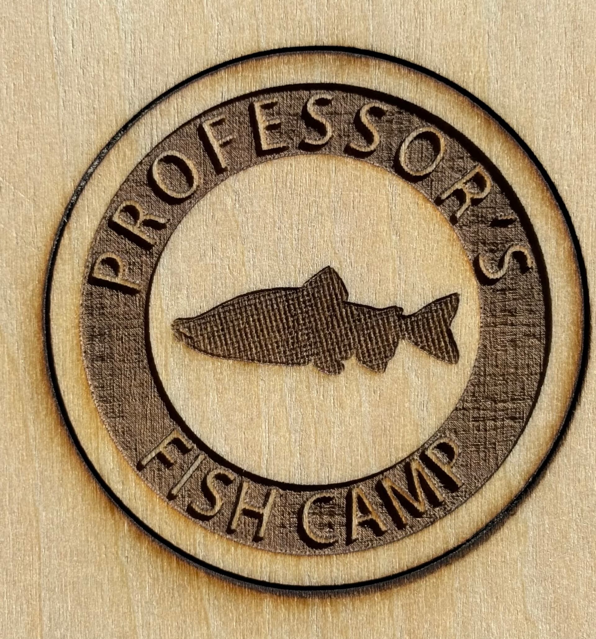

We have a WINNER! The JP3 worked perfectly on my MPCNC with a laser. Great job getting this all figured out Ryan! Also, thank you to all those that helped Ryan along the way. What a great community we have here at V1. :100:
Here is an example from the Jackpot v1:
Here is the Jackpot v2. You can see that it was cutting at 100% the whole time.
And here is the Jackpot v3. :oncoming_fist:
