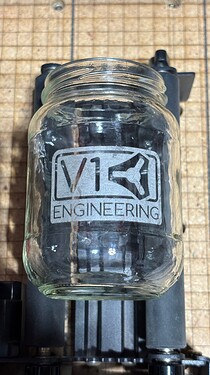

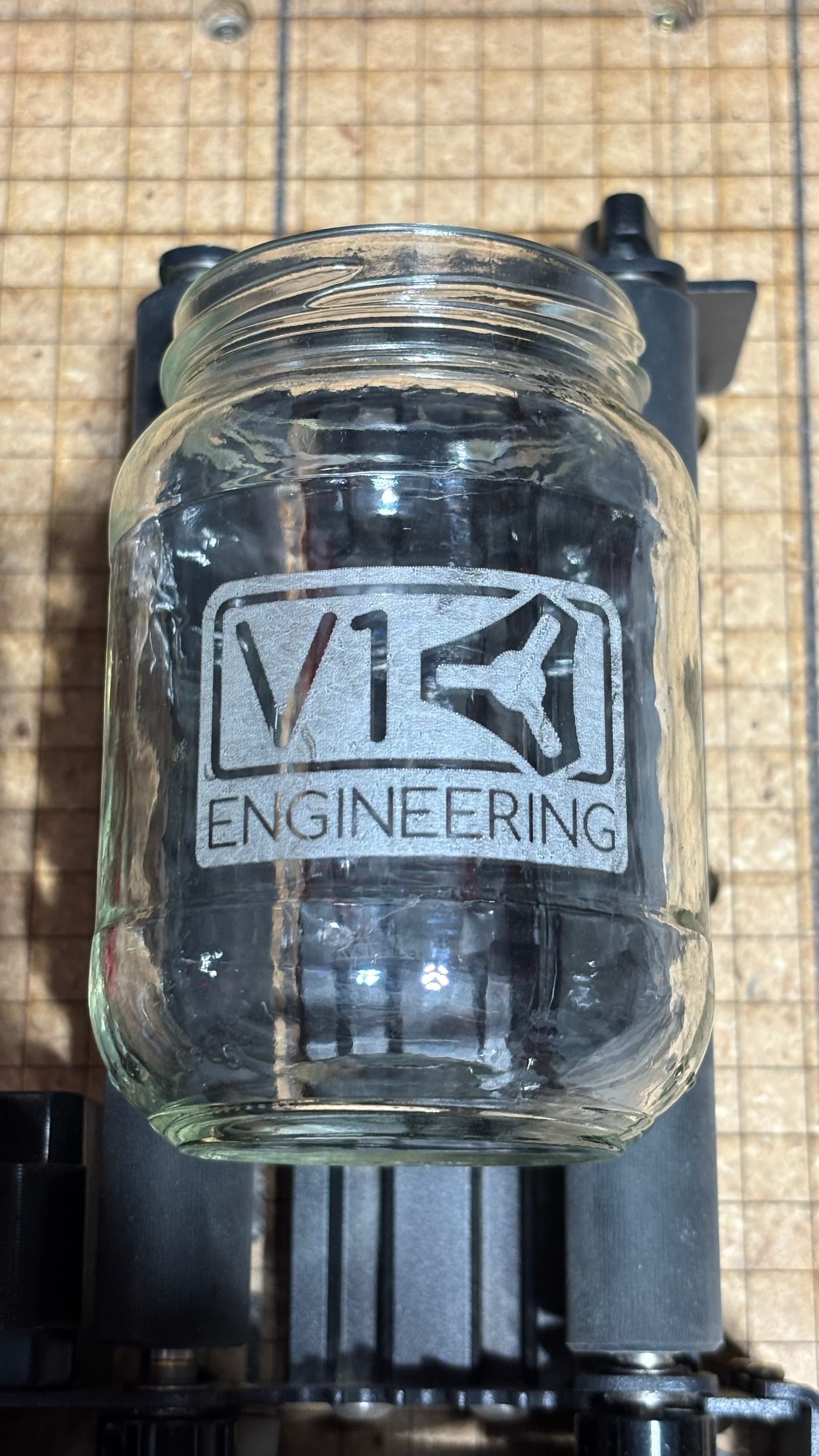

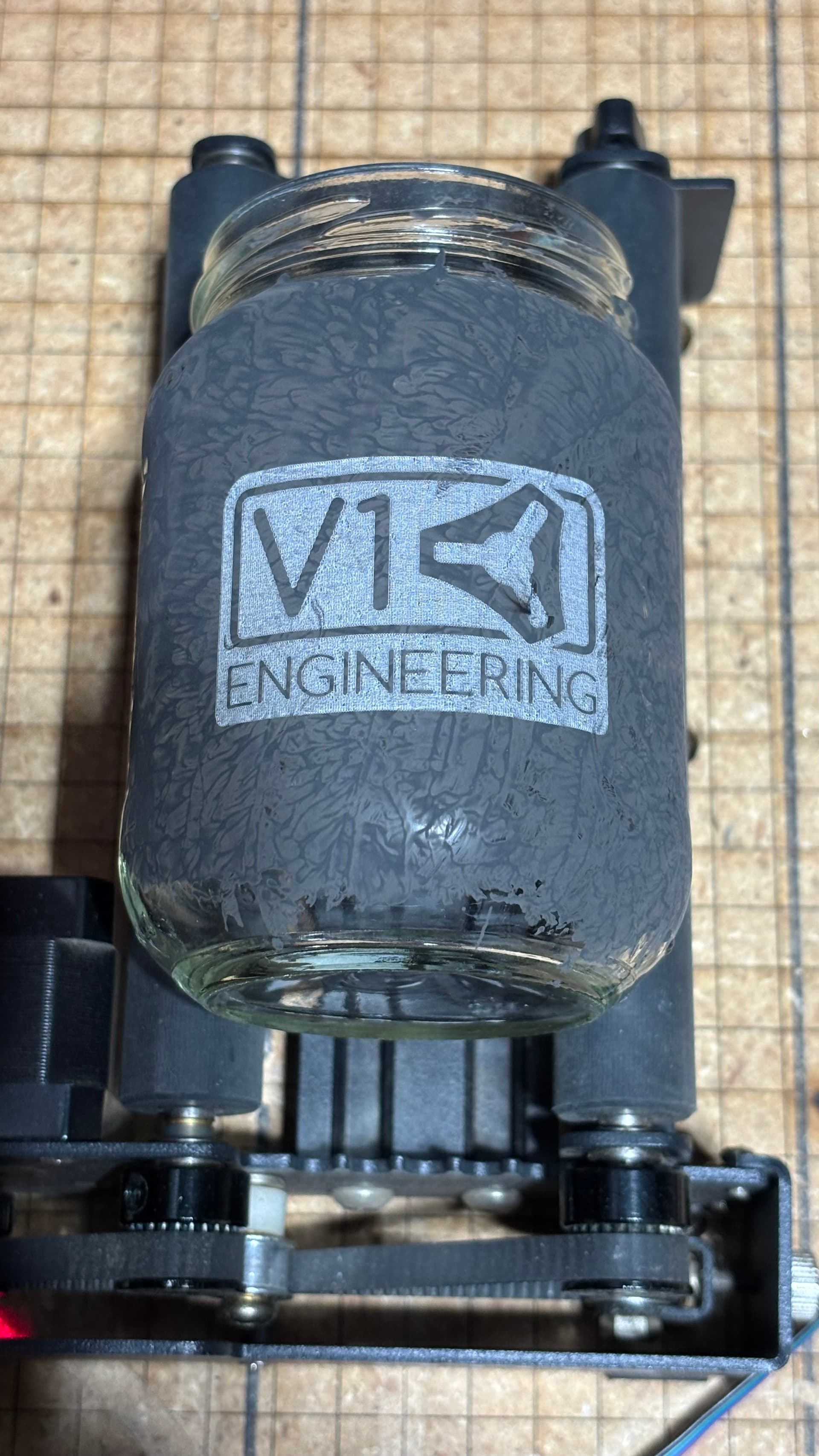

I didn’t have a paper either.
I redid the V1 logo with black paint to etch the glass.

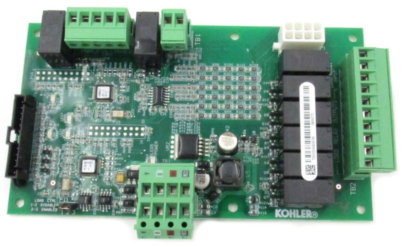

I like the new connectors. Will get the Airedale connected to it for some testing.
Kohler likes that style of connector for their transfer switches, too.
