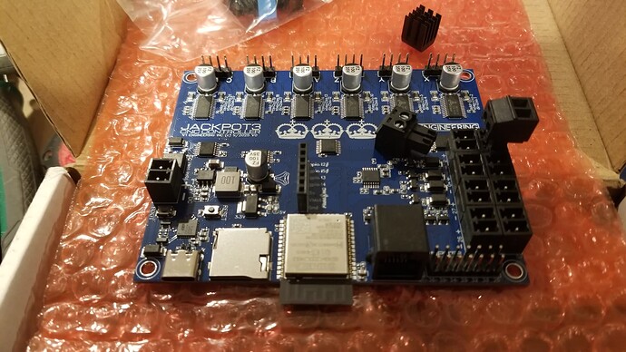

Analog signal on the 5v output looks amazing on all 4 ports. I will get ready to ship and sell these Bad Mama Jama’s!
Should change the shop’s LR picture to the 4 while you are at it. It’s only been a year though… :face_savoring_food::sweat_smile:
okay I changed a couple of them

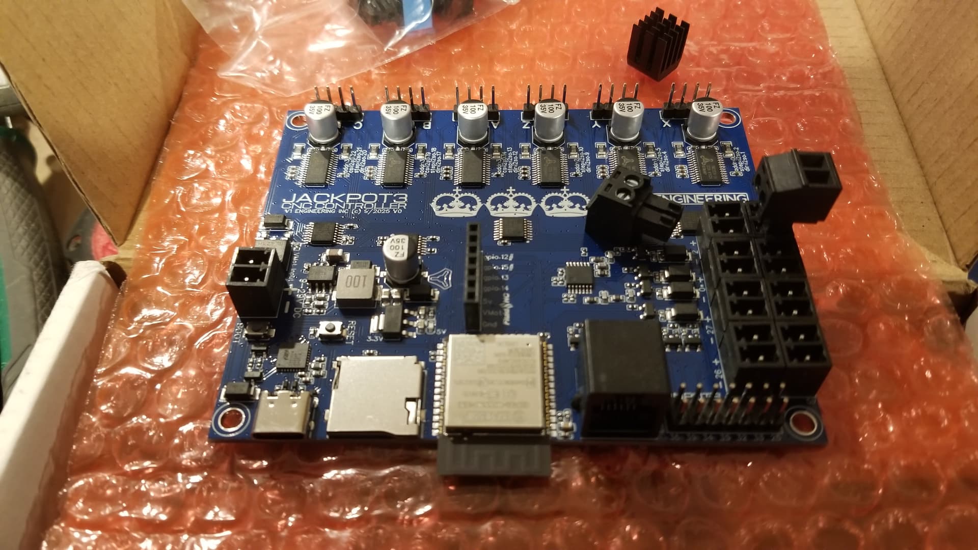

New board looks great! Thank you for generously sending me the latest version! :folded_hands: Personally like the new wider pitch screw based connectors.

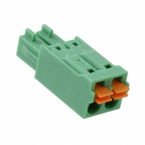

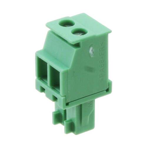

Quick check… @vicious1 are the vmot and gpio connectors oriented as you intended? Should the connector shells be mirrored instead of same orientation? Currently can’t insert two pairs of 2 pin connectors. I’m behind on this topic, maybe people needing to use vmot and adjacent gpio are expected to use 4 pin (2x2) connectors that will fit there?
I don’t know why, but I like the sexy black heat sinks more than I should.
Hoping to play with the board soon!
The 5V output and Vmot channels that are inline share a GPIO, so you shouldn’t ever need to use the two together as they would be controlled by the same thing. In the rare instance that you have something that needs +Vmot power as well as a digital control signal controlled by the same GPIO, you’d be better off either using an external relay/SSR driven by the GPIO and a buffer or an optoisolator or similar driven by the Vmot output.
Edit: To be clear, there’s no reason you can’t use both together, other than that they would both be switched at the same time. There are other configurations of plug that may also work for that scenario:
Each pair is one pin so you choose high or low voltage as the output. In the firmware you choose analog or digital, High voltage is digital only (or extremely slow analog).

I can get blue and balck easily, the other colors are harder to come by so I am sure I will try out a few combo’s but probably mostly black heatsinks to match the black plugs.
